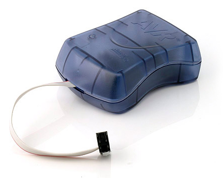

Hi Danzup,
I have bought the AVRispMKII, with a 6 pin connector.
I don't want to damage the processor, could you please inform me what i
must do to change the firmware into LED.
1 - I have connect the PC to the AVRispMKII
must the R2R board must be connected to the main power?
or not connected.

TBKK,
R2R board must be connected to the main power.
I have sent you a link to a document who explain in detail what you need and how to change firmware. Please read.
Tibi

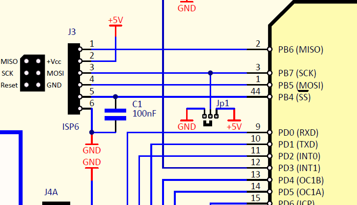

Tibi,
could you inform me where i can find jumper 1 on the board?
must i make any connection to rewrite the filmware on the board.
That jumper is named : "R2R/SHT" on board .
It must be set for r2r if you have the r2r version of resistor on volume/selection board .
When programming the board this jumper must be removed !!!
