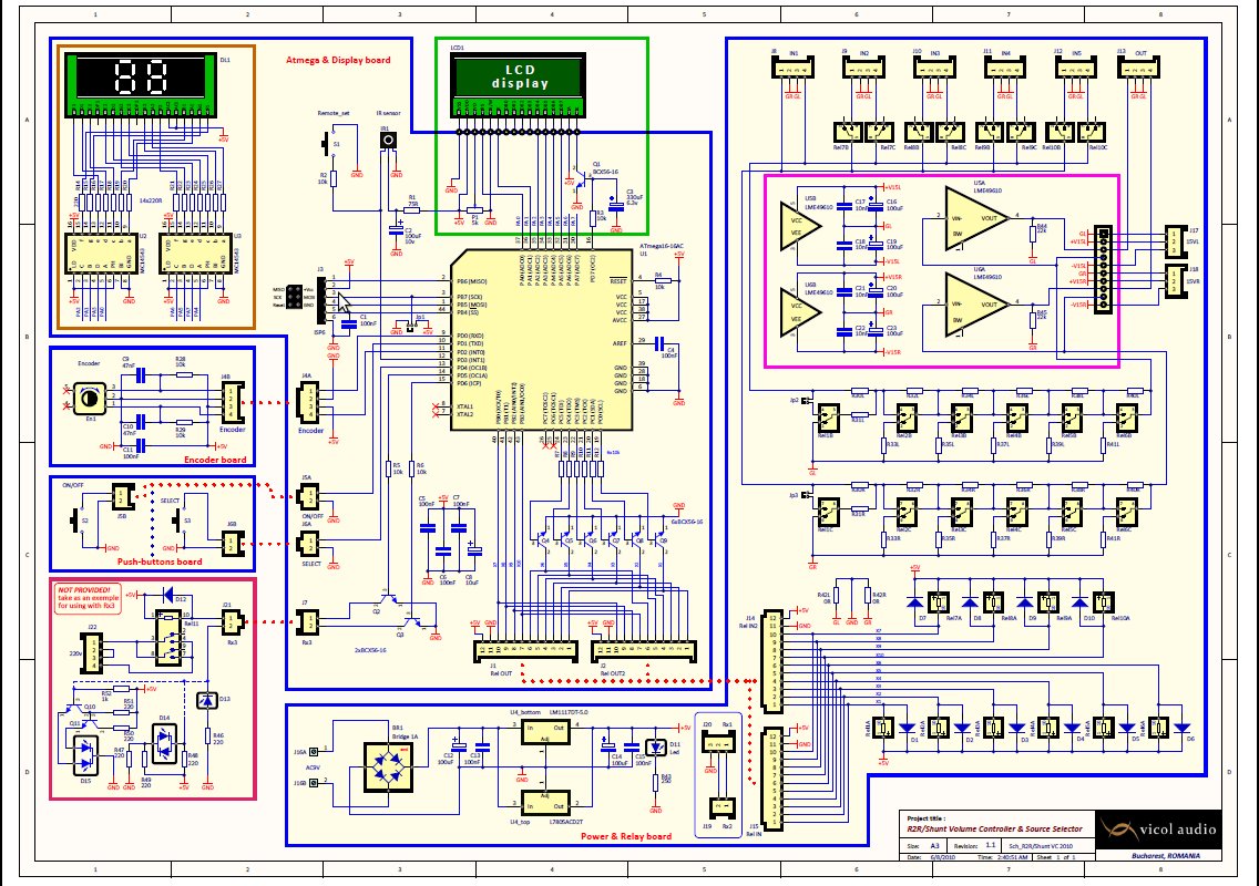

It is not really r2r , we call it so because the schematics is identically , but the values of resistors are like this :Hi Tvicol, I recommentd 8bits or more relays uses in the volume control, for the reason that 6bits is really not enough for a suitable attenuation.
You can get 48dB attenuation with 8bits relays
also, 36dB only in 6bits
regards
Lu
-1dB -2dB -4dB -8dB -16dB -32dB
6 bit = total attenuation -63dB
Now do you understand ?

Schematic is available here as well.
http://vicol-audio.ro/img/volume-controller/VC_R2R&Shunt_2010.pdf
Those who want to DIY from the a to z this product, may found all documentation and info at vicol audio : r-2r volume controller

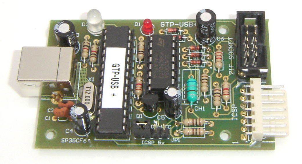

hi tvicol,
i have bought the boards from you but they all program for LCD, now one friend
wants to use the LED configuration. I received also the schematic with the 6 pin
but i need to know what to do exactly to pre program the chip. I have the follow;
GTP-Plus programmer for USB.
must i connect the programmer to the board, and must i also connect the powersupply
of the board. or not
please tell me what to do?
hi tvicol,
GTP-Plus programmer for USB.View attachment 177257
That programmer is only for PIC and NOT for Atmel AVR !!! It will not work !
Programming with a compatible ISP for AVR is simple : with the target power on you connect the 6 signals to programmer and write the firmware .
A little google will show you a lot of compatible programmer interfaces and how to do this .
If that interface can program Atmel AVR then it is ok !hi danzup,

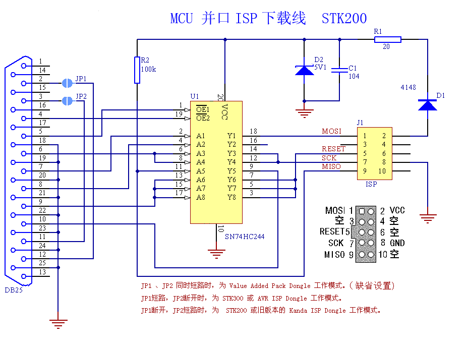

I found this schematic
this will work so the board must be connect to power.
TBKK
You must connect following pins for atmel : MISO ,MOSI , CLK, RESET , +5V , GND from the programmer to corresponded Atmel pins
Yes ! This is the good interface . The board must have power as the programmer is powered from board . Use Bascom AVR to programm .
download for free from here : Downloads - MCS Electronics

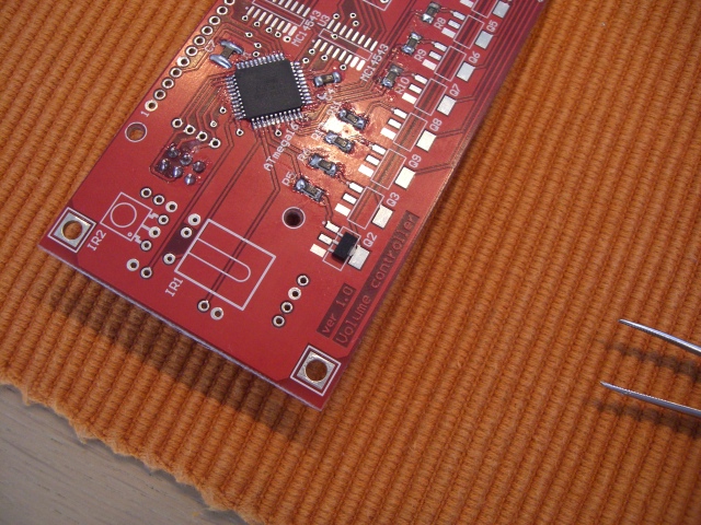

am assembly the board, order everything by TME very good and quick delivery
i have BCX56-16 according to the BOM list but the housing is to small look at the
picture, any suggestion for this problem.
TBKK
BOM list wrong ! I have forgot to update BOM list !
I will be back with the correct code for transistor .
Sorry again.
