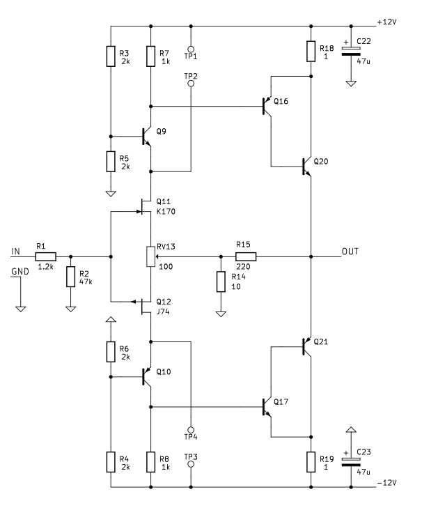

Fran told me that some of you wanted a labelled schematics.
I didn't make one, as it is essentially the same as the original, except for the bypass, for which there are multiple options.
Putting all these options on the schematics is likely to cause lots of confusion, as then some might not bother to read the instructions.
It is MOST IMPORTANT that you take time to read AND understand the instructions before even starting to order things.
If you must have one, I'll make one for you.
But I am still most concerned it creates more confusion than clarity around the CCS bypass.
To understand how it works, refer to the original pdf, and :
www.diyaudio.com/community/threads/hiraga-le-monstre-2024.413301/post-7775591
www.diyaudio.com/community/threads/hiraga-le-monstre-2024.413301/post-7778960
The bypass is placed between TP1&2, and TP3&4.
The values are different between the positive and the negative sides, even if the JFETs are perfectly matched.
You have to follow the instructions.

Also, for people using TOCOS trimmer (10R), please remember you need to add 2x 43R resistors in series to make up 100R in total.
We tried using a single 100R single-turn trimmer before, and it was way too sensitive to adjust.
This is why we use ourselves ( 43R fixed --10R trim -- 43R fixed ) instead.
If you want to use a single trimmer, you should use a multi-turn one., as suggested in the BoM.
Patrick
Those who must have the schematics corresponding to our PCB can contact Fran by PM.
He can send that to you as pdf by email. He is very busy, so be patient with him.
It is only for your own use and should not be reposted here or elsewhere.
I cannot emphasis more that you read the instructions and understand how to set the bypass before using the schematics.
For the three bypass options, we chose to use the fixed resistor version in our final build for simplicity.
However, if you wish to be able to adjust bias easily, you can use the trimmer version (on sockets) to start with.
Following the instructions, set DC offset with the TR in the middle, and let it warn up for half an hour.
Then readjust TR9, TR10 to lower bias and retain DC offset without touching the middle TR again.
You can easily measure bias via voltage across the 1R power resistors.
Once done, remove the trimmer and measure the resistance across the appropriate pins.
Then replace with 0805 Susumu thin film (fixed) resistors.
Fine adjust DC with middle TR if necessary.

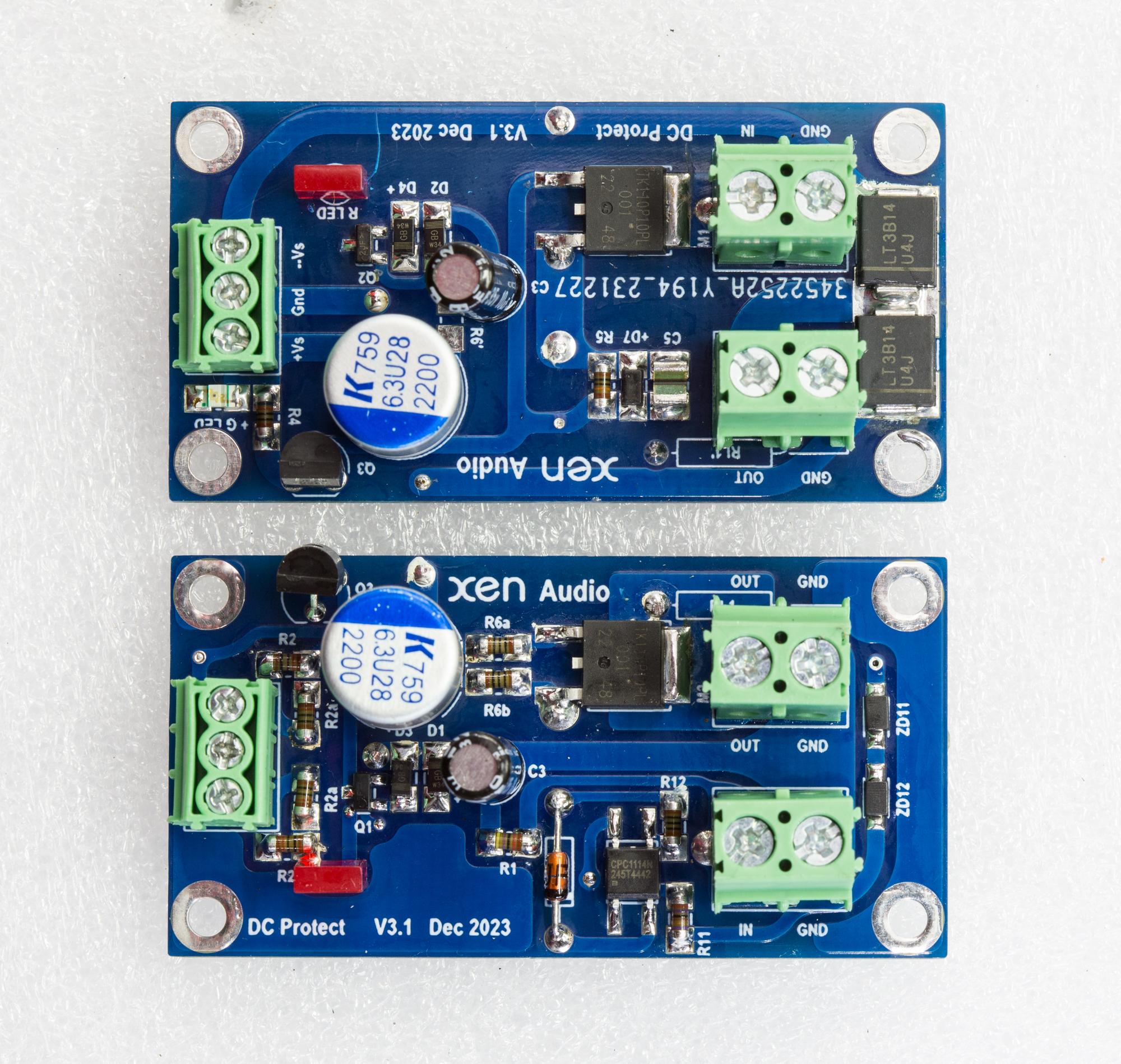

Folks,
The SSP3 speaker protection boards can be built as a mirror pair if you choose to do so. This is only cosmetic of course, but some might find it handy as it allows the input and output to "flow". If you look you will see there is provision for some components to be mounted either side, for example R6 or R6', and the caps can be mounted on the other side so that there is clearance at the heatsink. Totally up to yourselves what you want to do.
