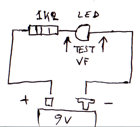

A question - I have tried measuring / matching the LED's (red ones as per BOM) and they all measure under 1.8v; is it OK to mix LEDs e.g. a Green at 1.96 would get me to the 9.0 requirement? Same would apply to the 5.4volt string. Pity I have no yellow ones!

Get a 9V battery and 1k2 resistor. Do that on the pic. Your test Vf is going to be more representative of final use since it simulates 5-6mA.
Mixing is OK. There's no Led problem you can't fix if you do it in the mix

Salas - thanks - I had used your suggestion to measure the first few LEDs but having just bought a Peak Transistor tester I was using that to measure the LEDs - its test current varying between 3.3 & 3.5 mA. I will re-measure as per your diagram.
