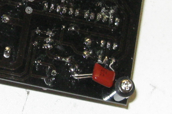

No, not on 7812, just across the collector to base pins on its pads underneath the PCB, of the relay driving NPN BJT (the lower one near the 300//300 or 600//600R positions). The 2 mysterious relay chatter incidents occured due to oscillation of that transistor. The reason is still obscure. Several NPN types were checked to no avail. So it can still be a 546 or 550. Both types giving no problem at all with 3 relay types on the mega majority of builds. Unfortunate individual relay or 7812 are two scenarios to scrutinise further. But the remedy is a 150nF mylar film or ceramic cap, tried and tested on those two incidents with complete and measured success on Kannan's hand held Fluke with miniscope display.
Picture shows the Film cap - ceramic cap wprks as well - solder it only if needed

Yes, first thing I mentioned back then, next thing that Kannan will look in to. If it happens again to any new proto build, do cross investigate. Its not a repeating enough theme untill now so we could not get more statistical study.
Onething strange about this problem that I noticed was that it did not oscillate but the transistor was repeatedly switching low and high with unequal period - something looked like unable to drive the inductive load rather than 7812 oscillating. I will test this with decoupling cap on 7812 - say 100nF and report. Right now I am working on something else - kept this aside, probably try this test in couple of days
