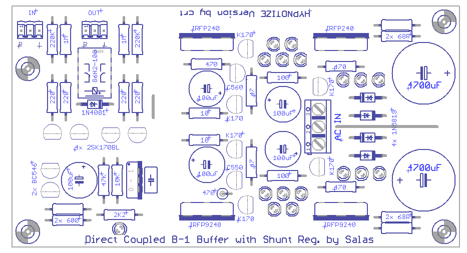

Is there a picture or file that shows the component placement,with out the traces?

Thanks for the pictures,what layout prog are you using?Is there a picture or file that shows the component placement,with out the traces?

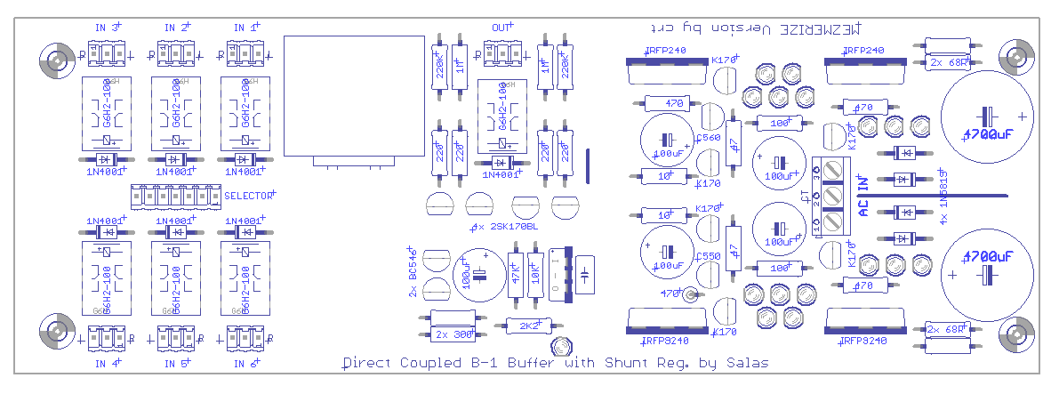

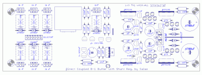

I have few questions, , what sits to the right of the relays on the Mesmerize (looks like a tranny hole)? I also am confused which way the relays install, but I have not looked into it yet.
Also, Salas, I can't figure out the orientation of the LED's by looking at this or the flipside. The silkscreen looks all the same to me.

Any higher resolution? The thing on the Mesmerize is outline for a pot the size of an Alps blue.
Hold the board for reading ''Direct Coupled...'' normally from left to right.
The relays have a stripe along one small side. There they have pins 1 & 10. As you face the board, you install them upper row of 3 with the stripe looking down parallel to the side where the 9240's are, and says Direct Coupled blah blah. The low row of 3 faces up.
The 240s side Leds look all with cathode to the right. The 9240s side ones, cathode to the left. The ''power on'' Led near the 7812 looks cathode down towards Direct Coupled blah blah.
