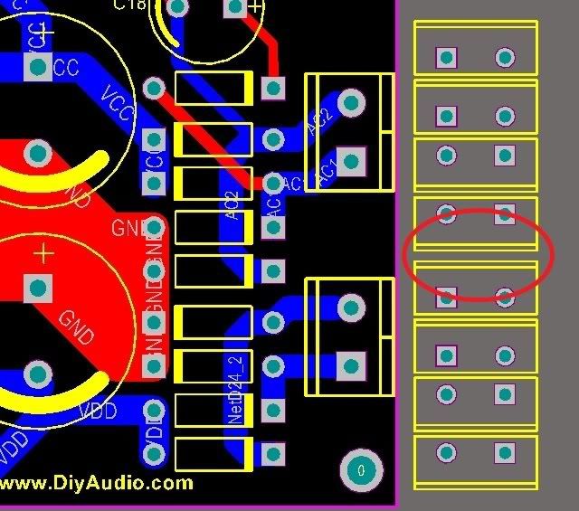

jean-paul said:Maybe when xaudiox still is working on the layout he could add pads for using MUR diodes ( in TO220 case ) as well. Could you add this possibility xaudiox ?.
Hi, I did try that but with the current spacing and orientation of the diodes, there's not enough space between the diodes. the 4th and 5th diodes, their tab are facing each other, which is my main concern..
Awkward indeed. Please do not change this as it is a potentially unsafe situation.

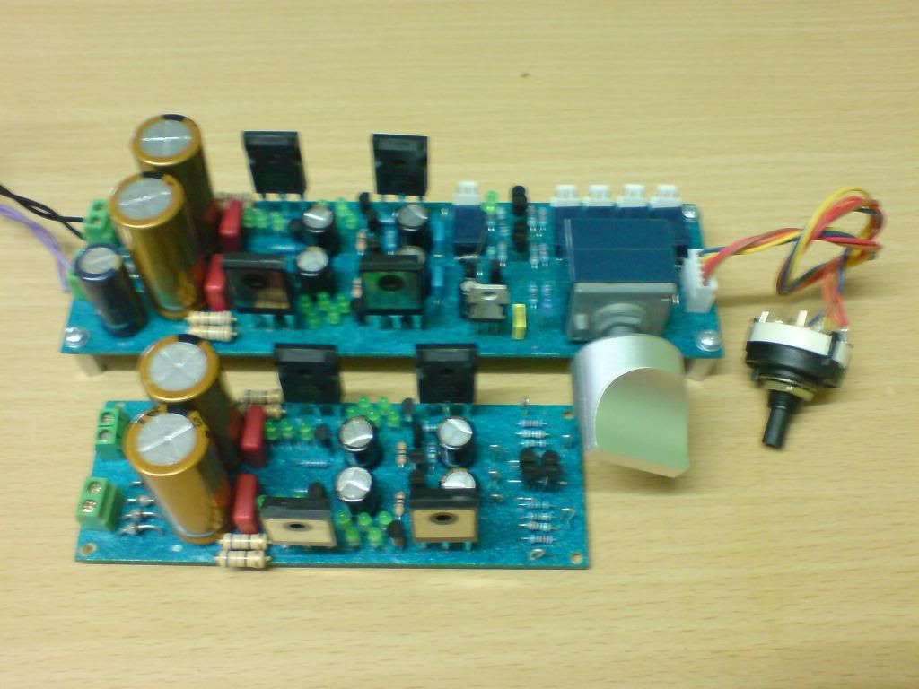

basic b1 working...
hi,
i just finished the protoype for the Basic B1. it works like a charm..
just like what Salas said.. the led string need to be matched.. i didnt match mine since i only have exact number of leds..
shunt output = + 11.44V and -10.60V
even with the current voltage supply.. the DC offset is about 3-6mV only.
i monitor the dc offset while i turn off the b1.. the dc offset climbs to 400mV after power off..
so it really important to have a mute relay at the output of the B1..
heres some photos..
enjoy..

Great! I actually have an output relay in my basic for that reason, so to avoid anything untoward, but Crt did not monitor or did not mention such power off momentary climb when he did the original basic. Maybe after a better +/- reg match it jumps lower? You will see after you will have more Leds. Also, for how long this jump stays?
Salas said:Also, for how long this jump stays?
after power off. from 3mV to 400mV+ in 15secs then drop slowly.. i'm using 3300uf for the main caps..
Don't think about it. Add an output relay as I use. Maybe Crt had all his amps C input and did not notice any woofers going out and sucked back slowly. We will never know if someone will hook it up to a DC input amp and turn off the Basic DC B1 first. The Wiki has many many board requests, and that means many will work out there for many years in different hands.

Hi, the muting relay is in the signal path at the moment. Shorting the output to ground keeps the relay out of the signal path. There will be a current path of max. 10 V over the 220 Ohm resistor and a K170 at the moment of muting at power on/off.
What do you think about that ?
Looks great.
