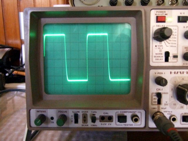

Keep in mind that the 220k input resistor which is there to safeguard against dodgy pot DC incidents and MUST be used, by effectively shunting the wiper to ground will change the subjective pot quality and its channel matching for the better too.

@salas. what do you think of adding RC circuit at the input of the pot? i believe the b1 have bandwidth of more than 10mhz, the rc filter can keep the RF away.. Let's say 1 kOhm and 100 pF polystyrene or MKP = 150 kHz -3 dB.. what do you think? this is just another option that can easily be jumpered if you dont feel like it..
The input interconnects will have 100-150pF easily, add average source impedance to the 220R stopper and its already been taken care of. Haven't seen any oscillation on 100kHz squarewaves. If there was an issue, Nelson Pass would include such a filter in the original B1. Don't bother IMHO. 1k series, is audible. Adds too much source impedance. The dynamics are softened, and the resistor quality becomes more obvious. That is why I got down to minimum 220R stoppers.
100kHz close up.
