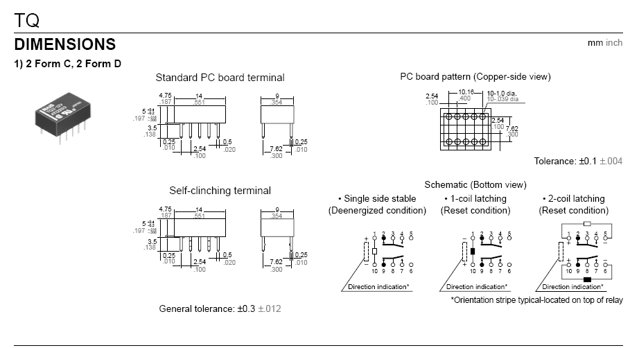

Can i use a l7812cv instead of the l7812acv ?
Likewise Mouser reports the relays as "Not available" so i plan to use a G5A 12V instead.

Any compatible 10 pin non latching 12V or 5V relay with same dimensions can be accommodated. Check TQ2 Panasonic datasheet for compatibility. All 7812 will do. Just use a little sink on it to be on the safe side. When we did the Blue, some people said do the Mez again, some took Tea's very last 1oz Mez stash on the fly. So we promised there will be a 2nd life Mez little run attempt at a point. Here is the chance in 2oz copper, now that the Blue is over. If there is some sign up interest will be happy to reissue.

Panasonic TQ2-12V
Digi-Key - 255-1002-5-ND (Manufacturer - TQ2-12V)
