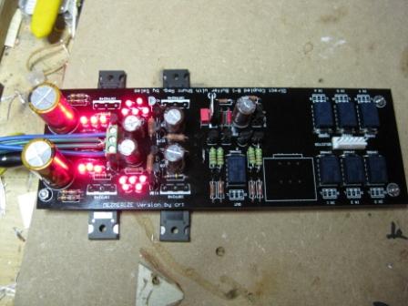

We are going to open a potential group buy sheet for a couple of weeks to see if there is real interest. The price would be 14.00 dollars, a single sided board, and would use 2 oz copper instead of 1.
Here is a blurry pic of my original DCB1 Mesmerize.

No, its not a redesign, just a better quality pcb reissue. There were some voices about missing the Mez full pre, so we thought we can try out and see if there will be some minimum interest in signing up for it. It was something we promised earlier in this thread. That one is not normally being gauged for a reg only heavier use, so its psu is adequate for uF.

There is no remote sense in such boards. Maybe you mean several later reg designs of mine, but not pcbs.
Crt is not around to make any tweaks, its the old Mez.
