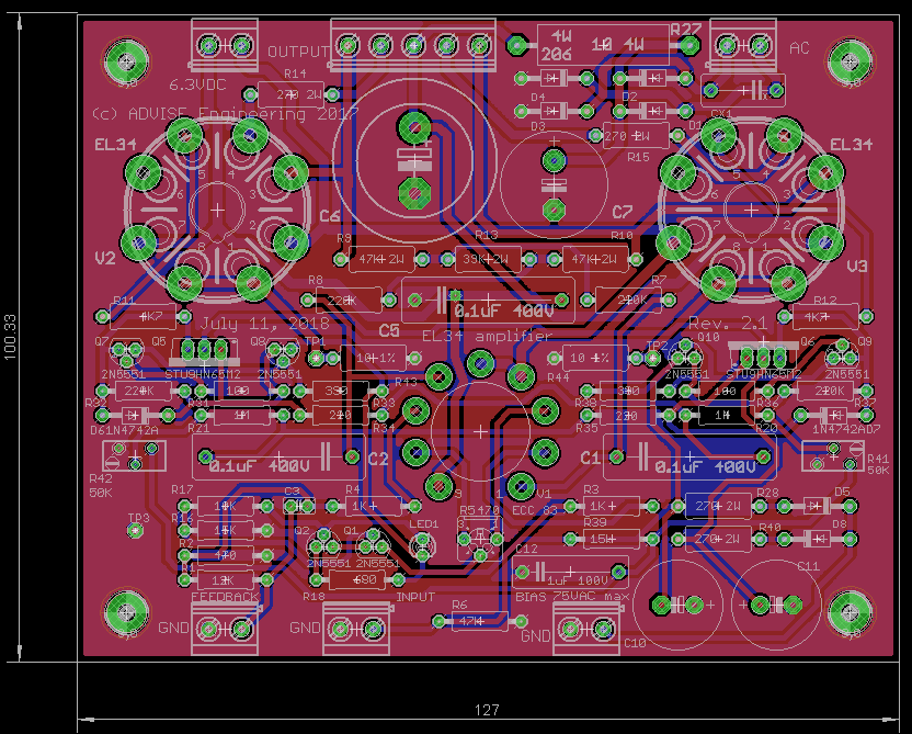

Improved version EL34 Baby Huey rev 2.1
Hello,
Since I have learned a lot with this small but very good amplifier since one year, I have made some minor modifications to simplify the assembly of this PCB :
1. I indicated the GND side on the input, feedback and bias connectors,
2. I removed the not very useful on board potentiometer for volume and replaced it with a 47k resistor
3. I increased a little the space between the bias and driver filter capacitors C10 and C11
4. I optimized the location and/or size of some name on the serigraphy
These modifications didn't change the functionality of the amplifier, but will make it easier to built 🙂
You can see a picture of the new PCB. The main modification (removing the pot) does not mean that you cannot use a pot on the input, but it will be connected by wire from the front panel.

Hi Marc,
In case that, you have done some fixes on layout, if it's not trouble for you and before boards are produced, to place properly R41 & R42 to the corresponding tube? As we know R41 drives V3 tube and should drive the V2..just for the sake of the physical placement to not confuse which trimmer should be turn.

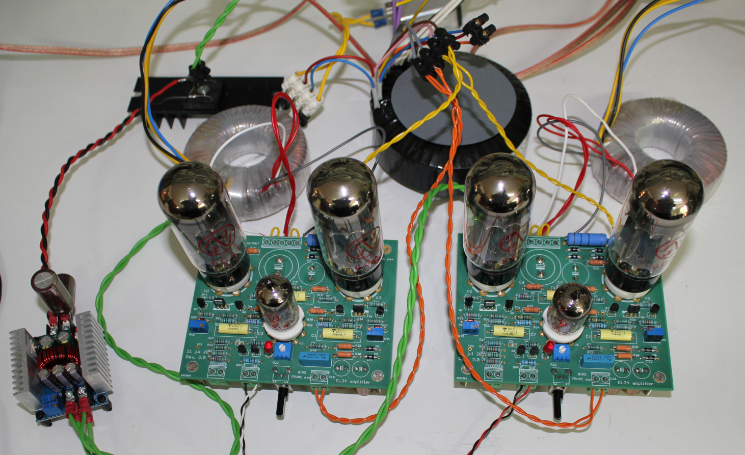

Another question I have, I read most of the thread especially for BH EL34. did you try with AC tube heaters? Any hum, noise? I'm asking you as, I see from your posts that, you purchase Toroidy transformers and they have 6.3V 7A out.

Hi Bekim,
Thanks for the suggestion, however, not only it is no more a minor change and it may create errors therefor a test batch should be made before production of 50 boards, but also the fact that the trimmer and the test point are not on the same side is not so bad because it is easier to have one hand on each side of this very compact amplifier to avoid to burn your fingers on the hot tubes 🙂

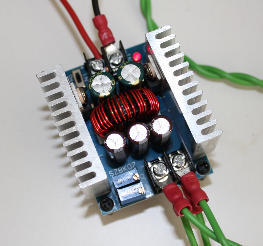

Regarding your second question about heaters, I have never used 6.3 V AC in this amplifier. At the beginning I have used a 10 A switching power supply from the main and after I have used two small Chinese 7 A DC/DC converter from the 9 V AC of my custom 141 VA transformer but the 25 A bridge rectifier be came quite hot ( two volt and nearly 7 A = 14 w loss in the bridge !) and after that the transformer was a little too small for this amplifier... Finally I am using the Toroidy and I put the two 6.3 V 7 A in serial to get about 15 V DC to drive the new 20 A DC/DC converter and since the current in the rectifier is much lower, about 3 A, I dissipate only 6 W in the bridge witch does not need a heatsink even if there is one on the picture 🙂
