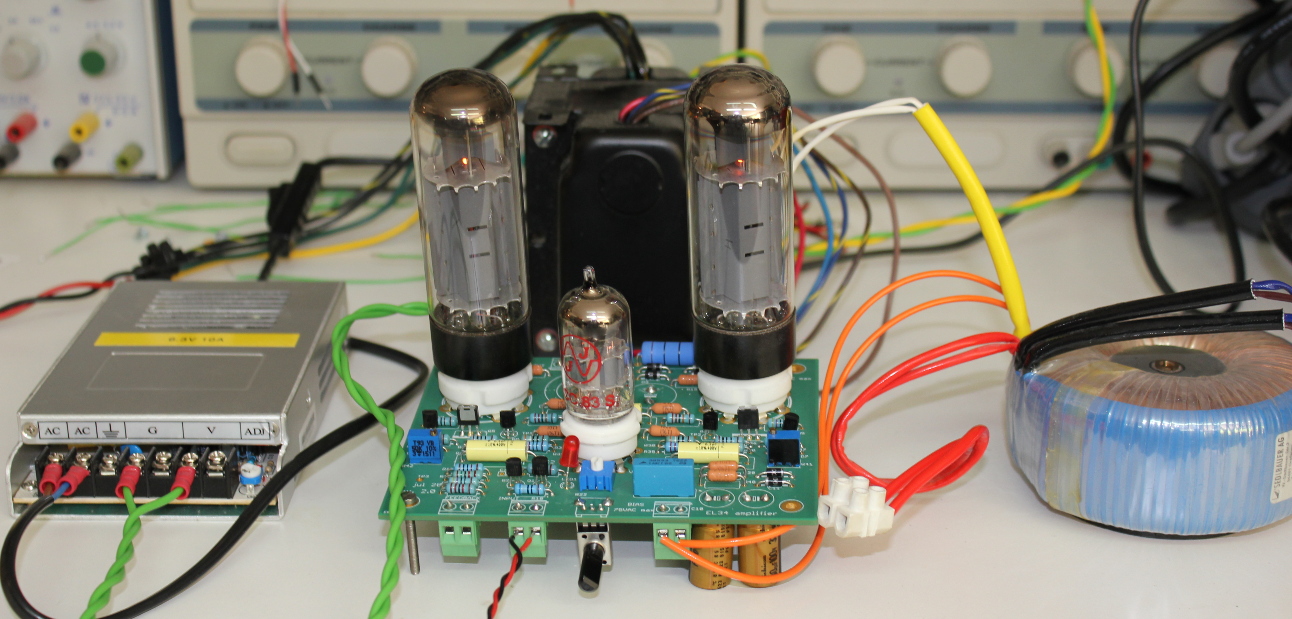

Did you speak about the 6.3 V 10 A heater DC power supply on the attached picture ?
In this case you can find it here : Bloc de Chauffage 6,3 V / 10 A Régulé pour Ampli à Tubes AL0007 : RADIOELEC : Composants et Modules Electroniques, spécialiste Audiophiles et Radioamateurs , it is in France, but it come from China where you should find it 🙂
I have bought 3 of them, very convenient for tubes amplifier.

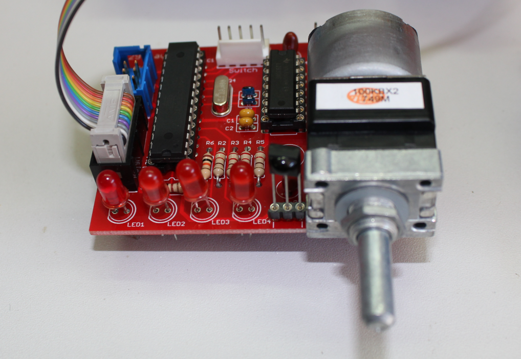

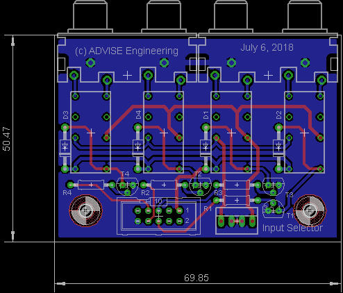

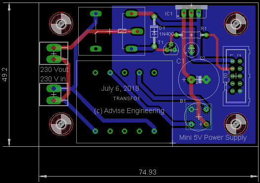

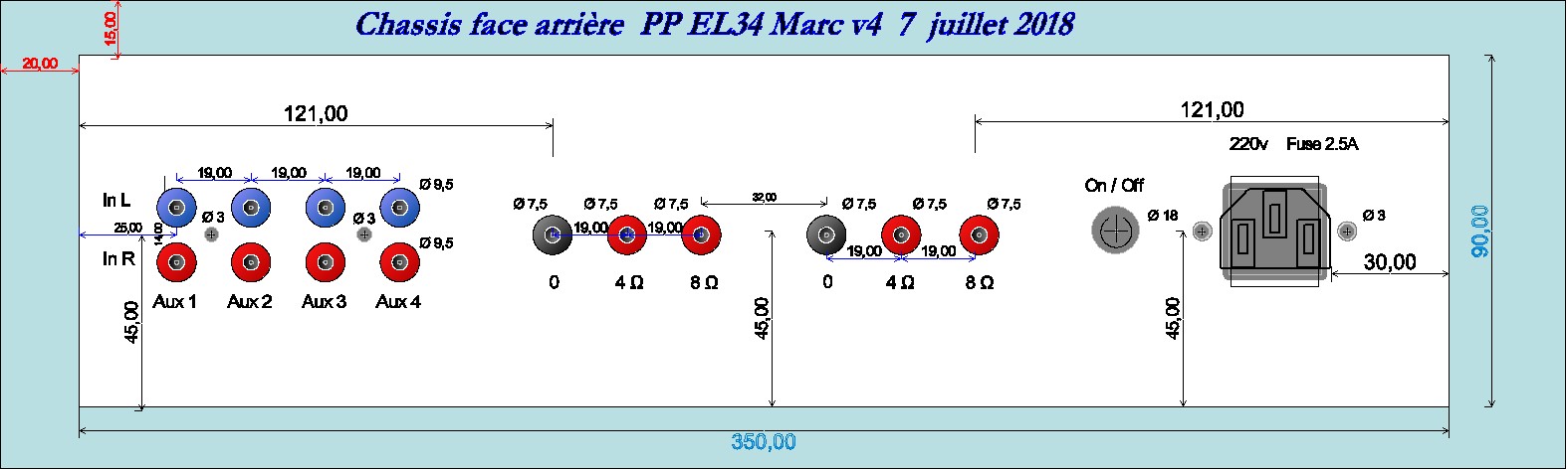

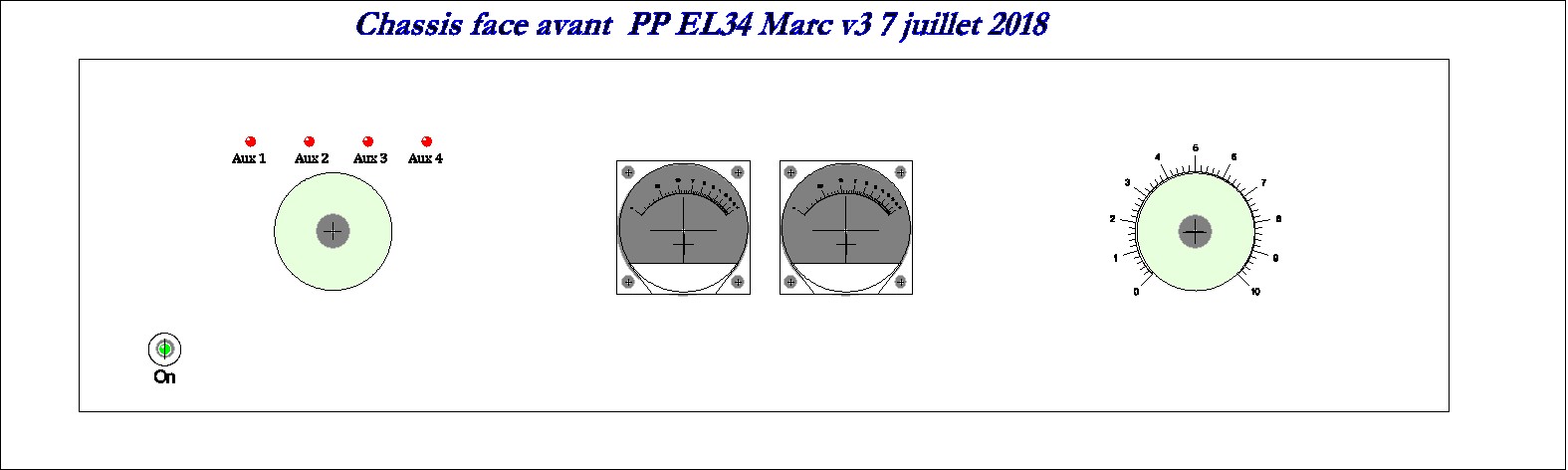

I had the chance to meet someone through the forum who is living not very far from me and had the skill to design the mechanical part of the amplifier, therefor we are trying to make a nice enclosure for this amplifier before to start somethings else.
For those interested there is some draft of the top, rear and front panel in this message. The top panel will be produced by Front Panel Express, Expensive but very nice ! This will be compatible with a chassis commonly available on internet : Boitier DIY 100% Aluminium angles arrondis 380x320x90mm Noir - Audiophonics
All measures are in mm and I have designed 3 small modules for selecting the input, controlling the volume with remote and powering this with standby control...
