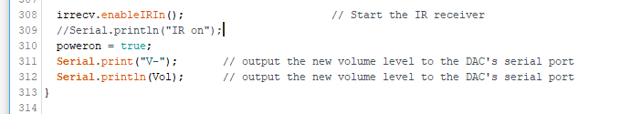

The start-up volume thing is easy to fix. Just insert this:
after the poweron = true; statement at the setup().

I corrected to this - otherwise I got an error in compiling
Serial.print("Vol"); // output the new volume level to the DAC's serial port
Serial.println(Vol); // output the new volume level to the DAC's serial port
However it is still giving full volume until I touch the volume on the remote. Just for your info - it is not critical 🙂
That's weird - something got left out in my copy - paste. The correct lines are these:
This should take care of the full volume issue..

The volume is still not adjusted, even with the new code, and we have not figured out why?

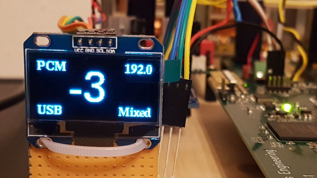

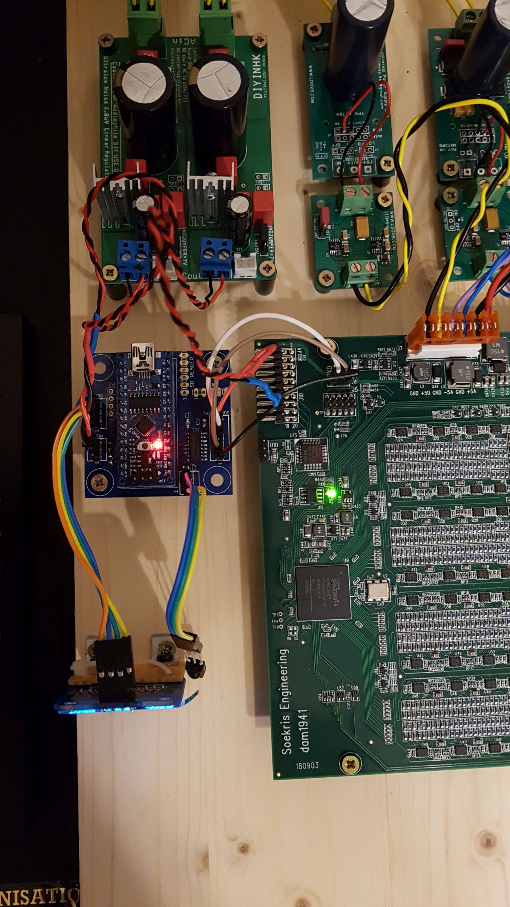

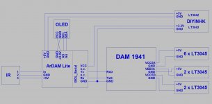

ArDAM Lite controlled DAM1941
Hi folks,
I -almost- finished my ArDAM Lite controlled DAM1941.
It's now in "breadboarded" state, but sooner or later I will make a case.
I attached my configuration's block diagram.
The ArDAM Lite PSUs is DiyInHK dual LT3042 (+transistor) versions (+5V, +3V3).
My OLED is 1.3" SH1106 chip version (I2C).
I rewrite Dimdim's code.
Because Arduino Nano has very narrow space for program, only the "necessary" commands and status informations have been implemented:
Commands:
- Volume up; Volume down;
- Source selection: Auto, USB, AES/EBU, BNC SPDIF, RCA SPDIF, Opical (Soren now not implemented I2S);
- Filter changing: four filter selection.
Status display:
- Volume;
- Type of stream (PCM, DSD);
- Sample rate;
- Source;
- Filter.
Because Nano's space is "full", the "draw_logo" procedure now is commented.
The IR codes is my remote control's code, must be change your remote codes.
Use attached Dimdim's "IR_Scanner" for detecting codes from your IR remote control.
If you want to see DAM's serial commands, use attached "serial_console" program.
Have fun and enjoy yourself!

Can I buy this?
Each component purchasable from the net, ArDAM Lite PCB there from Dimdim, 1.3" OLED, Arduino Nano, parts from ebay.
I use this PSU -because I own several pieces- for control and display:
DiyInHK dual PSU from 0.8uV Ultralow noise DAC power supply regulator 3.3/5/7V 1.5A*x2 - DIYINHK.
My breadboarded system use LT3045 PSUs for DAM, but any good PSU (for example UBiB) usable.
I bought two bobbin transformers for PSUs (INDEL 40VA 7.5V or 9V AC, depends of PSU type). Any transformer usable which have low primary-secondary capacitance. For me toroid not this type.
