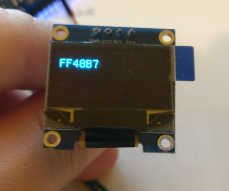

I wrote a small program that helps with determining the compatibility of IR remotes with the library that I am using. When you load the code into your Arduino it will display the detected IR code on the OLED and through the serial port.
More details in the updated Project's Page and Build Guide (v1.1): ArDAM1021 Lite Project | Dimdim's Blog

- To test the IR codes you wrote the little SW which requires the IR sensor and OLED display to be connected to the Arduino, but this should not be plugged in your board - so plug the IR and OLED straight to the Arduino pins? I do have two of your boards, I could make one with headers for the IR and OLED, but without the serial isolator chip...
- I got this 1.3" 1.3" IIC I2C SPI Serial 128X64 OLED LCD Display Module For Arduino Blue 3.3V/5V | eBay . Which line should I activate - or just keep the 0.96" activ? The driver chip of my oled is SSD1106

- Yes, you only need to just plug the IR receiver to the Arduino, you don't even need to connect the OLED since you can see the IR codes in your IDE's serial port monitor.
- For the 1.3" OLED you need to comment out the first line and remove the // from this line:
U8GLIB_SH1106_128X64 u8g(U8G_I2C_OPT_NO_ACK); // Display which does not send ACK
