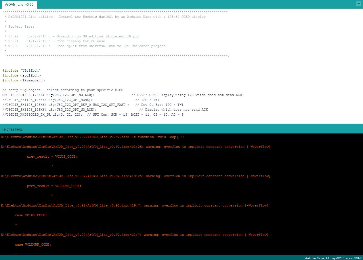

It is my first attempt, I have only a few experience with arduino yet.
I am using the Arduino 1.8.5 (I think the newest) version.
I've installed all libraries, so it is not the problem.
The OLED display works fine with ug8lib, tested before...
I do not have an IR receiver yet, I'll buy it soon, so I did not want to modify the code. But it is not the problem, it comes only into play if I want to make some inputs...
It compiles just fine here but I haven't updated the relevant libraries in a while.

Being new to arduino I realised that updating the libraries was helpful. After that I could upload the program to the nano without any fault codes. Thank you so much for the board, Dimdim, and the code - I have now coded a remote, everything seems to work fine, with signals to the screen and to the serial port on the computer- I now just need to connect it to the dam - will do that tomorrow.

Well - When I give it power, it is turned off, and the screen looks like yours. Only the power led lights up. When I press the on/off button that I have coded on the remote the LDC shows what it is supposed to do, and the L LED also turns on. But I get no warnings when uploading the code.Hi, do you have some idea why are these error?
(I have at the moment no IR receiver, but it should be not the problem I think)
Dimdin, it would be nice if it starts on -but I cannot recognise where in your code that could be changed? Can you give me a hint?

@zarandok: I just realized that you are getting warnings, not errors. Does the compilation finish or does it end with an error?
If it finishes, you should be OK in spite of the warnings. If you're getting the "static" that I see on your picture it just means that your code is running but your OLED is not properly "blanked" at power-on. That is a known bug, I have a fix for it.. I was planning to release it along with dsd compatibility and rotary encoder support but since that is taking longer than expected I'll just let you know of the necessary changes in the code later today.
