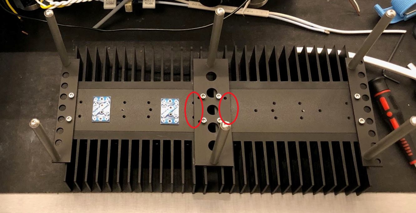

So here is a summary of the issues that Morde has encountered.
We are pretty confident that these are the only ones, due to a drawing version error.
My apologies, to you all and to CeeVee. 100% not his fault.
We have 4 issues, 2 are must-correct, the other 2 optional :
1) Front panel holes for protection board TO220 devices wrongly drilled to M4.
2) Rectifier holes on the bottom side of the regulator heatsinks partially covered. See photo attached.
3) Rectifier heatsink a bit close to top plate.
4) Space for the regulator heatsinks quite tight to the Aux Tx.
1) is a drawing error.
We shall ship to you 6x M4-M3 adaptor screws at our cost.
2) can be rectified by moving the two inner rectifier bridges away from the centre by 6mm or so.
There is still enough space away from the outboard rectifier bridges.
You only need to drill and tap 8x M3 holes.
If you prefer not to drill & tap, we can supply you with a new mounting plate with cutouts to solve the problem
3) is because we designed for GB1 maximum height for some AMerican transformers.
The Toroidy transformers used by most are much lower in height.
And therefore you can have a better balanced use of space by shortening those 6x standoffs by 4~5mm.
If you do not have access to a lathe, you can send them back to CeeVee and he will shorten them for you.
Please get in touch with him directly for arrangements.
4) is a result of the fact that Toroidy no longer produce 15VA toroids.
The 20VA version is just a few mm higher, but space was tight before anyhow.
We can make some 4~5mm extra space by using a set of 3 new mounting plates to redistribute the regulator heatsink positions.
So they solve 2 problems (2&4) in one solution.
To summarise :
1) will be solved at our cost.
3) is functional but not perfect. Send them back, we'll do the mod for you.
2) will require you to redrill and tap 8 holes.
If you wish to have the perfect solution for (2) & (4), then we need to make a set of 3 new plates for you.
I shall pay for those out of my own pocket, as it is my mistake and not CeeVee's.
But I shall very much appreciate if you could contribute half of the cost (20€) to reduce my pain. 🙂
I'll pay postage for all subscribers in any case, for screws, standoffs and optionally new plates.
Hope this is a fair & satisfactory workaround to all,
Patrick

To help us get organised, please indicate your choice of solution as follows :
a) DIY (no action from us required other than M3/M4 adaptor screws)
b) Standoff shortening (send 6x standoff back to us for trimming off 5mm, + adaptor screws from us)
c) Perfect solution (as in b, but with 3 new regulator heatsink mounting plates)
Please help to fill in the list as follows (example):
Nickname Solution (c)
Once we hear from everyone, we shall proceed to make the necessary parts.
We shall then inform you before shipment.
Many thanks in advance,
Patrick

That center bracket connecting regulator heatsinks has another pair of holes. If you mount it by those, the whole assembly becomes a bit longer, but it still fits. The diodes have just enough clearance this way. This is what I did, I have PSU done and given first fit in the case, looks alright so far
The spacing of holes for regulator PCB stand-offs is off, again, a non-issue really
Hi Soldersober,
M4 to M3 adapter :
Screw Thread Adapters
but i bought already so can send when i receive them.
Making the heatsink assembly longer means that the small accessories transformer that bolts on the back plate will most probably not fit.
