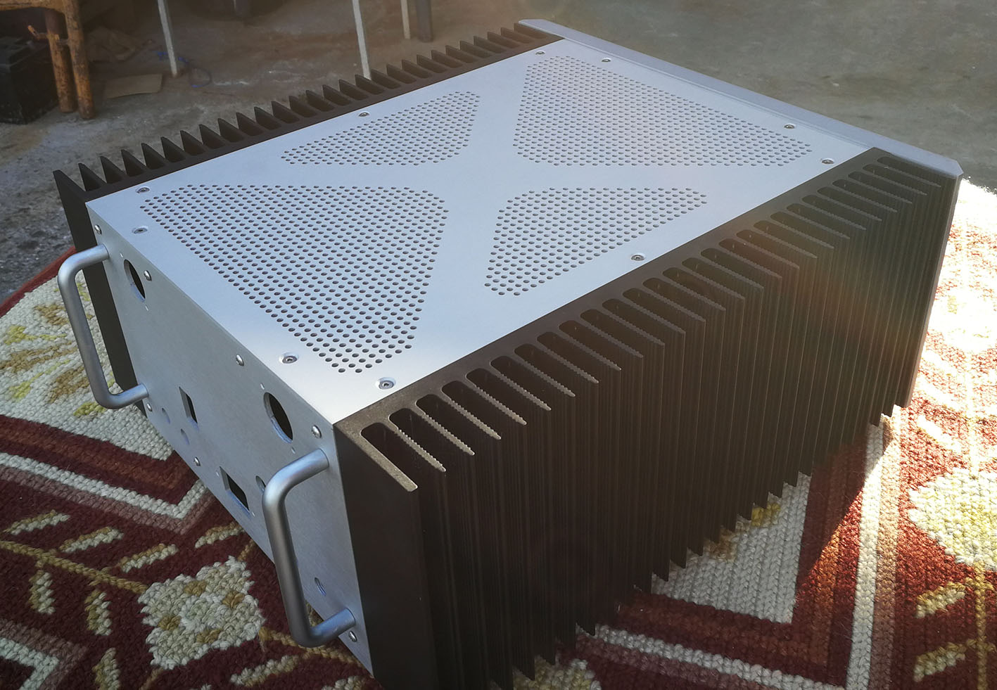

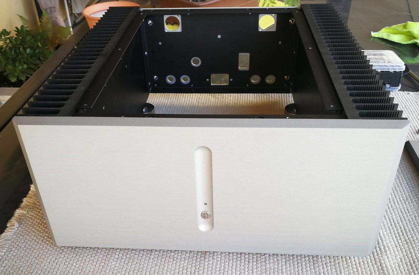

We have reached the end of fabrication, cases are ready although we hit a last minute issue with the front panel which we sought to resolve as soon as we could so we would be able to show you the final product here.
There were also issues with the shipping costs due to covid-19 and this led us to wait a couple of weeks more to see if prices would drop....the good news is that they did so to less than half namely to USA and Canada the others remain the same and are reasonable.
But lets go to the details of these 2 issues:

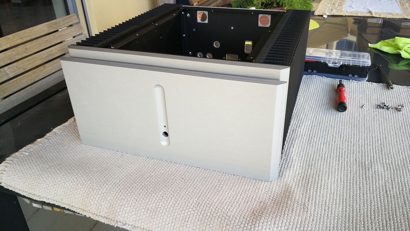

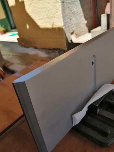

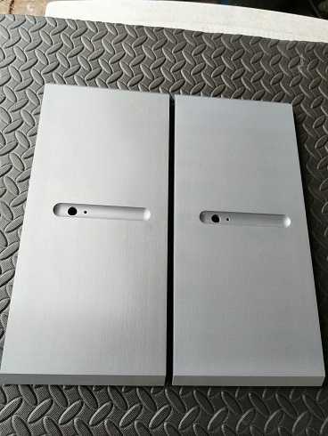

First that of the front case panel, we found at the anodized that due to the process of fabrication of very thick aluminium panels by cold rolled process the center of the panel has a slightly altered micro grain structure , this is not visible except in anodizing due to the growth of the alumina capilaries being slightly irregular.
the effect can be seen as a very light shadow down the middle of the thickness of the panel....if you look closely.
Extruded aluminium does not suffer this issue ( to take into account for next time ).

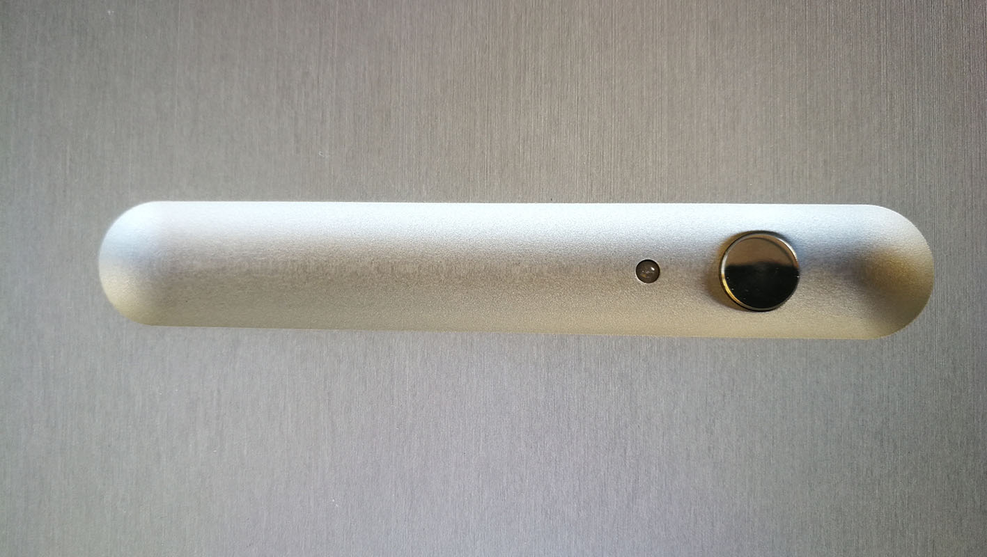

We decided to try alternative solution and found that using a very tough acrylic clear coat ( 2X ) used for optics protection would give an effect in terms of look and feel that is indistinguishable for original anodizing.
As can bee seen by the image where you have 2 fronts next to each other...one is anodized the other clear coated....it is not possible to tell them apart in look and feel.
You have the option to take the front as is anodized or clear coat with a simbolic cost of extra 5Euros as we take the brunt of the cost to de-anodize , media blast, rebrush and apply 2 coats of very expensive clear coat.
...but it was our mistake so we assume the brunt of the cost.
Second issue was the shipping and this showed values of 235€ to USA and Canada which was the lowest possible but we thought it to be completely not viable, too expensive even though the reason was clear, with the airlines flying at circa 70% of the fleets now ( at least out of Portugal ) we thought prices would come down...and they did to around half that !
So we will go ahead with shipping as soon as we receive last payment from you for last installment.
For Europe the prices are very low so no issue there.
I will contact each one by email with details, this is important especially for those of you in Hong Kong, USA and Canada because of customs and invoices.
I will ask each one to PM me with current email address so we can proceed.
We will ship cases fully assembled to make sure there are no assembly issues, also because we found no cost advantages with flat pack shipping, case weighs 11.5kg and the size of fully assembled box does not make it more expensive to ship that way so less work for you.
Pictures follow.

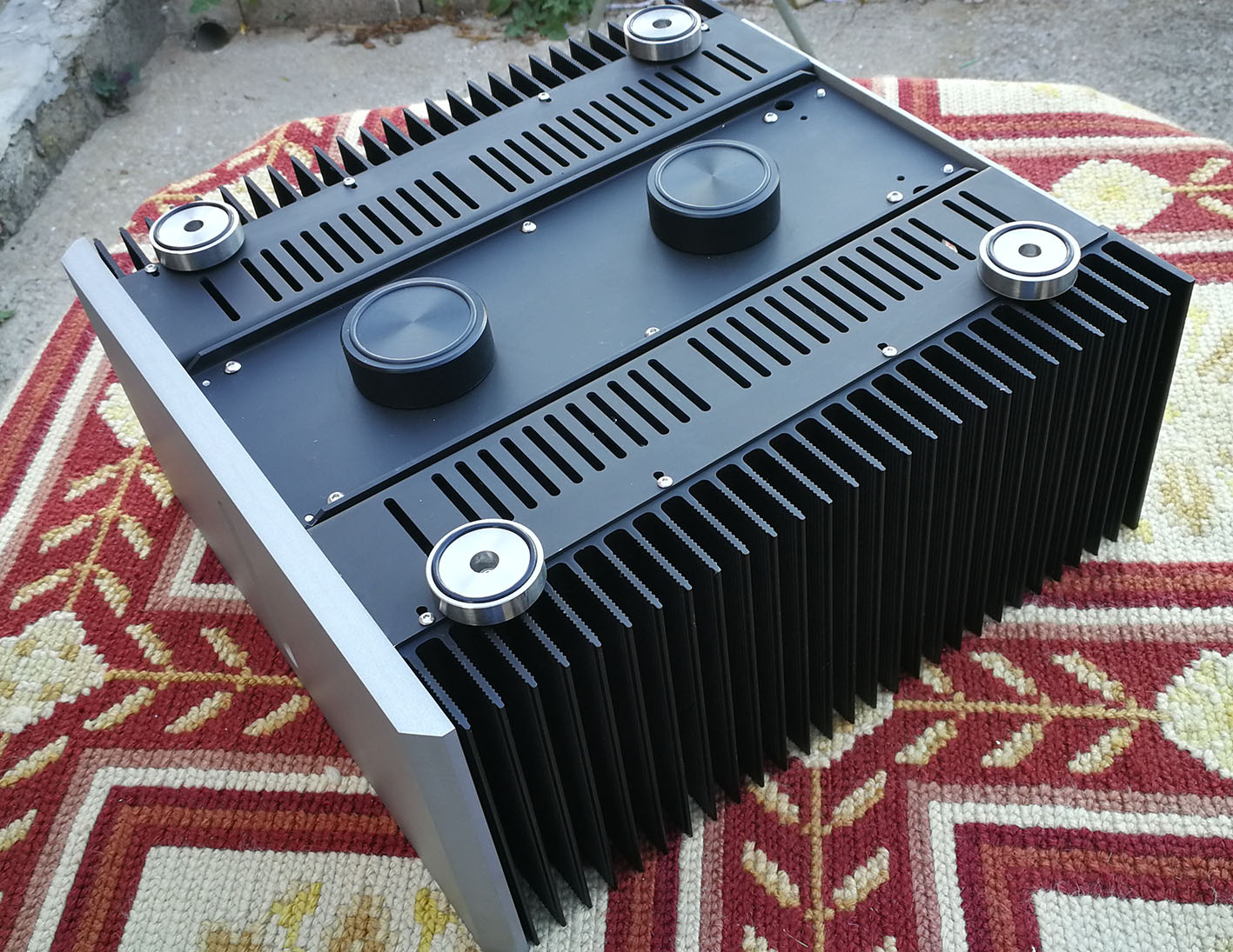

The cases look immaculate. 🙂

Most excellent work Carlos!
I can’t see much differences between the two in your third picture so I’m good with anodizing. I believe you allready have my e-mail address...😉

For clarity, the first 2 photos from top left are the ones with the light shadow.
The 3rd is the reworkrd (acrylic painted) panel against a perfectly anodised one from an ealier batch.

Preamp will mot have the effect....it only happens in very thick alu..15mm as is the case and up.
Preamp front plates are thinner and effect does not happen.
in very thick pieces you can even see the effect in black anodized ones,
The factory took the trouble to show me examples....
The solution is extruded alu... if it is available in the distentions you need.
It is not a questions of the alloy it is the fabrication process that produces the effect...we only use series 6 an higher 5 that are targeted for anodization....
