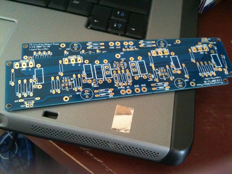

Got some new toys in the mail from the west coast.:D:D:mischiev:

Christian, you have two locations on there for a pair of power supply caps? Have you (or has anyone) tried putting caps that close to the outputs? I thought I read a while back that someone was having issues with oscillations with caps close to the outputs.

I'm happy to hear the boards are starting to arrive! ;)
The caps are marked "casc." because they are for cascoding. You can rewire them to become rail caps, but I would advice against that.

You can use a cap multiplier to get rid of a few volts, and then you could cascode the F5 to make it run on higher rail voltages - might be too advanced, but also pretty cool. ;)

Regarding the external psu, that is a question that pops up once in a while. I think the best solution is to have the first bank in the psu box and the second bank in the amp chassis.

I want to do the full board any ideas as to best place to obtain the extra cascode parts q101 and q102 , should they be matched prs also ?
Do i need the thermistors ?
regards,
You can use the ztx transistors as the rest of the amp or bc550/bc560 would be perfectly fine too. For the caps, papa would recommend elna silmic. You do not need to match the transistors.
The thermistors make the amp more stable with temperature, which is good, but it is not essential to the functioning of the F5.

a. wayne, I'll look at the parts list later, hopefully tomorrow. The cascoding is mainly for people who want to fool around with it, but I can give you an example: resistors 4.7k and 220uF caps. But you may have to fiddle around with these to get the perfect operating point.
