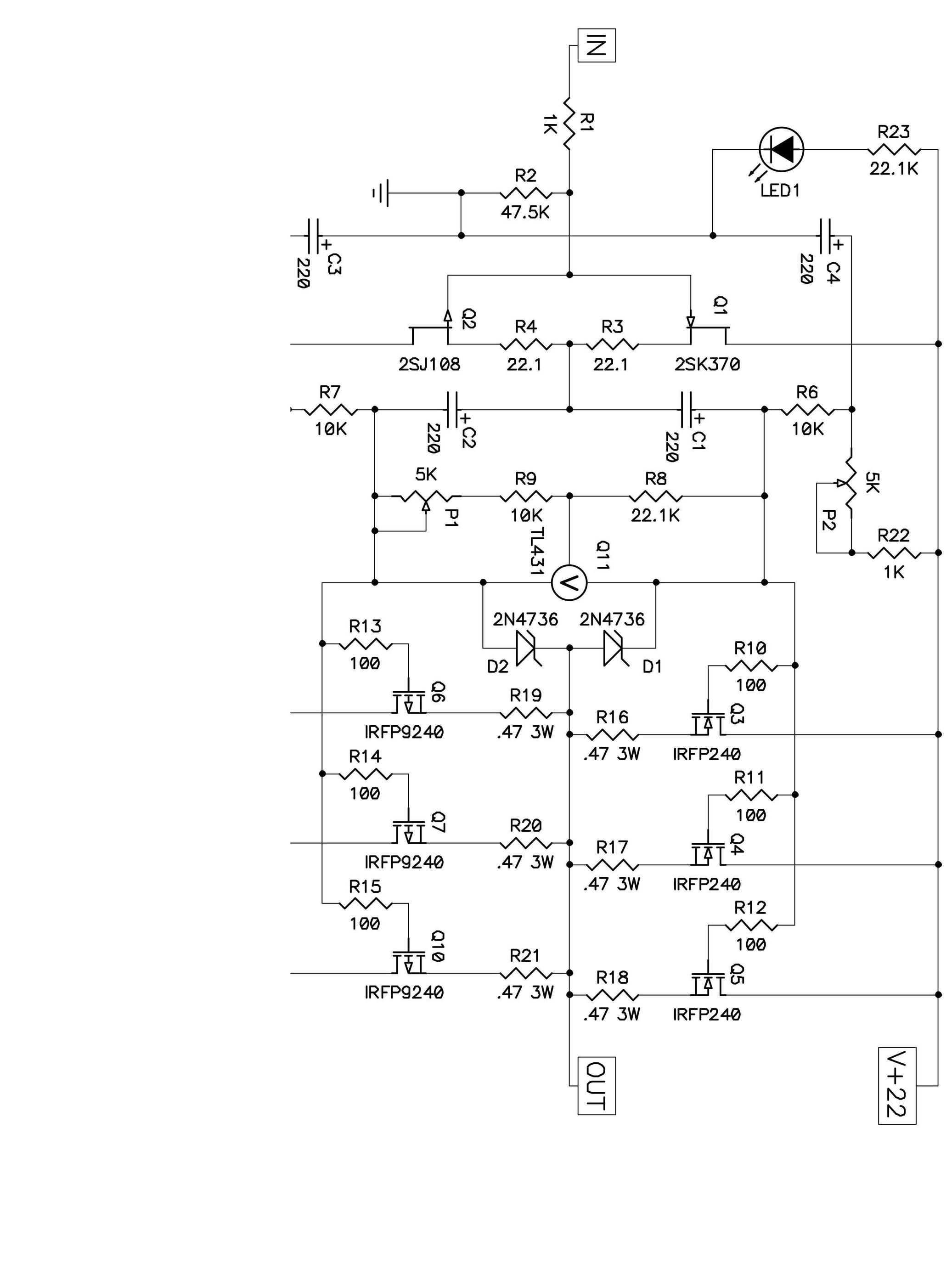

Chris,
I'm about ready to power up my F5 that I built using your boards. Just Beautiful!
Remember I owe you a beer at BA in October!
Before I put power to them, I have a question about the voltage present on the LED solder pads, are they 24V or 48V?
ie; positive referenced to ground or Positive referenced to Negative rail?
Checking the continuity, they seems to be referenced to ground. But I thought I should ask before I burn up my LEDs. :eek:
I should have asked before I soldered in Resistors calculated for 24V, but it's not too late to change them if I need to!
Thanks,
Ron
Yes, the led is between gnd and a resistor connected to V+. You can select R35 to give you the desired amount of light from your diodes. The value I have shown is very conservative compared to papas (10k in the F4 schematics!!!).
Did I miss something..............?????????
or am I just lost again.
Thanks Chris,
But.......I think you are thinking of the other R who's value is 22K not R35 :D
R35 value for 1 blue LED is 1.2Kohms.
At 10K your not going to light up a LED. With 24V supply and 3V forward drop across the LED, your only going to supply 2.5mA.
Thank you for being quick on the keyboard though!:)
Ron
OK,
now that I have looked up Papa's F4 schematic, it am totally confused. :confused:
It looks like he has a 22.1K resistor for his LED.
Yet, when I used an online LED resistor calculator for a pair of Blue LED 3.3V 20.mA in series driven by a 24V source, I came up with a R of 870 Ohms and .58 watts. Rounding up I have (and installed) a 1K Ohm 1Watt.
This seems radically different than either 10K or 22K.
Help a brother understand what the difference is.
Lost again :headbash:
Ron
