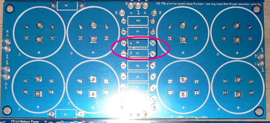

sandbasser said:Hi Christian -
Regarding your PSU board... What's the area in the red oval for in the attached image???
Thanks,
That is the connection to the negative rail.

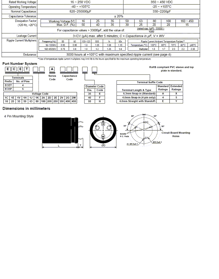

Christian,
I've got a bunch of Panasonic T-HA 33,000uF 35V 105deg 35mm x 80mm 'industrial' grade caps I'd like to use with your PSU boards. The ESR is really low .015 (lower than any of the THSAs) and all other specs equiv. But these are std 4-terminal mount, top vent !
Question, what would you suggest as best/possible way to adapt to your boards 10mm 2pin pattern?
Charles
Christian,
Charles
cowboy99 said:Actually 39,000uF T-HA ECET1VA393EA DigiKey P10628-ND
I do appreciate your opinion!
Charles
Are the "extra" pins to be connected to gnd or + or nothing at all?
It should be fairly simple to drill new holes and just bend the legs to touch the solder pads. Alternatively, you can remove the solder mask on the rail traces and solder them in directly, just remember that you need to use the plated holes in order to reach the gnd plane on the top side of the pcb, so no drilling through those holes. 😉

Re: Your suggestion appreciated
Hi, I ordered these 4 pin type panasonics (mine were TSUP series). The extra two pins do nothing. I think they are to force a certain orientation so you don't put them in the wrong way. I just cut them because they were in the way with no ill effect.
cowboy99 said:Christian,
Charles

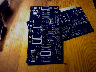

I received your boards today cviller, thanks!
I also happen to have 4 pin caps that I was hoping to use with the boards with some modification. I didn't realize the pin spacing on the caps were 22.5mm
so I think it might be a bit more difficult than I expected to get them to fit.
