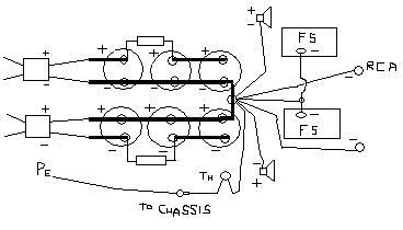

Re: PSU schematic
you are right - the lower bridge Is with reversed polarities
Lee35210 said:Samoloko, You need to watch that lower bridge. As drawn will result in a large mess when lower cap bank explodes! You have polarities of lower bridge reversed.

samoloko said:anyone got measured rails with load and no load
I got 25 Vdc no load and 22 Vdc with 2 F5 amps at 0.5 V bias
Mine are ~ 22-22.5v loaded.
The posted drawings from http://www.diyaudio.com/forums/showthread.php?postid=1814765#post1814765 and http://www.diyaudio.com/forums/showthread.php?postid=1814874#post1814874 are wrong - reversed polarity of the lower bridge
here corrected drawing
