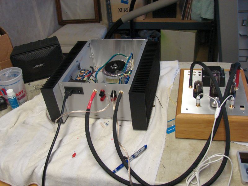

This was my 1st amp build (thanks N. Pass, C. Viller for boards, and U.Dailey for step-by-step power supply pictorial) and I bought my 1st multimeter and variac. I put everything together, plugged it in and slowly turned up the voltage to 125. I was very happy to see the little led lights glow. When I first measured the rails they were 29vcd!😱 😱
Some things I thought were perhaps my toroid was incorrectly labled (antek 300va 18x18) or my variac was defective. I had to turn it down to 105 volts to achieve 24vdc rails. My initial reading across r11 was 0. After p1/p2 adjustment my rails were 25 at 120volts and generally I have measured 22 to 23.5 average off the mains.
Most variacs go over 120v to 130v or so. You have to be careful.
Small changes on the variac can make huge changes on the output dc voltage rails in your circuit, especially with solid state circuits that work under 50V for the most part. Tube circuits on the other hand are high voltage circuits and you have a little bit more legroom (and tubes are a little more tolerant). Either way, turn up the variac slowly and measure at intermittent points before going all the way to 120V AC.

Novice mistake. Next time I will definitely measure the rail voltage as I turn the variac up. In fact, I will test the power supply before integrating it with the amp.
I'm up and running. Still waiting on a jewel lamp for the front panel, then I just have to dress it up and rack it.
Thanks to everyone for your patient assistance!
I'm up and running. Still waiting on a jewel lamp for the front panel, then I just have to dress it up and rack it. Thanks to everyone for your patient assistance!
That looks like a DIYenclosures 1013 chassis, and Antek transformers you are using. Nice work. Some very nice oversized heatsinks 😱
Anand.
Anand.
Good eye, Anand. I'm surprised you didn't call out the Conrad heatsinks though.
I got it running Monday night late so I didn't have time to wait for the temp to stabilize and had to wait 24 hours before I could tweak the pots. Its surprised me how warm the thing got!
