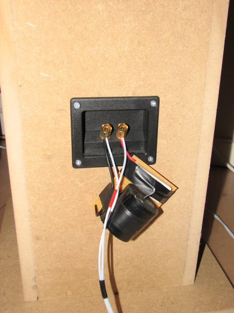

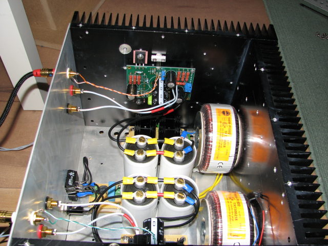

Naah, what you really need is a spiffy amp like this ZenV9, set up as a current source amp. It does wonders for the Abby's, and one have to admit that they sound pretty enjoyable with that amp. This is my ZenV9 on Peters boards (It is still not a F3, no matter what you guys keep calling it😉 )
Even better with the correct // filter attached. Seen here dangling at the back of the poor Abby. The filter brings extended bottomend (really needed!) and smooth out the harsh midrange (also needed!) Subjectively I think it extends the topend a bit too.

Steenoe,
How are those heatsinks holding up? I have similar size, except the fins on mine are vertical.
Thanks,
Vince

vdi_nenna said:Steenoe,
If yours have vertical fins, they will do fine. Mine are getting a bit hot, so I will have to figure out a way to increase the ventilation a little.
I'm curious myself if you can get away with those heatsinks. They seem a bit small. I even wonder if they'll run cool enough if you turned them vertical.
Only one way to find out! 😉
I have the same heatsinks and when running the F4 with them, it was often a good idea to use the vacuum cleaner to pull out the hot air...
Unfortunately a vacuum cleaner is also noisy so it kinda spoils the sound! 😉
Vacuum cleaner to the resque😀 Great idea...
The most sensible thing to do with those heatsinks, is of course to have them cut in half and turn them around for getting the fins vertical. In that way they will easily cool the F5 (or F4) Small? no. Ever been fooled by a big donut😉 BTW the F5 only dissipates 65 watts per channel. Not really an awfull lot. The sinks with my F5 on them are running at 45 Deg C, measured (with an IR thermometer) between the fins, right behind the fet's. They can run for years at that temp.
