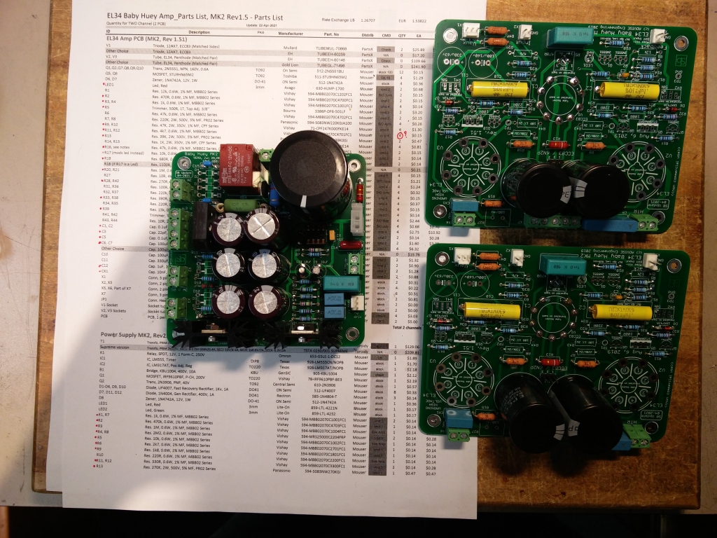

Hi. You're welcome, hope everything will run fine. Just started to assemble the PCB, a reminder: This AMP PCB version is called ''BOTTOM'', for a good reason, some parts, in particular the the tube sockets need to be mounted ON THE BACK of the pcb.
So once the amp pcb is assembled, the tubes are mounted on the bottom, and pointing toward the top of the amp, meaning that the PCB top is in fact pointing toward the bottom. The adjustment trimmers R5/R41/R42 are also accessible from the top, so mounted on the back of the pcb...
Other wise the tube will be assembled in reverse, and the amp won't work...Hope it is clearer...

Assembled all the parts I have so far, and all the recommended parts form the BOM fit the pcb nicely. Will try to test the supply PCB this week...

The BOM calls for 0.6W Resistors, are the small blues ones all 0.6W, they look like 1/4W to me.
Yes, they are 0.6W... Check the BOM, and take any MBB02 resistors part number, insert it into Mouser and check the specs, you'll see 0.6w...
If you prefer to use the 1W version, the PCB accept the larger size body as well...

Reviewed the boards and they look very nice. Would have preferred a thicker FR4 material, but for the size of the PCB 1.6mm should be fine.

Can C10 on PSU (47uf 500V) be replaced with a 56uf 500v I have. Having a hard time finding a 7.5mm pitch part that fits the bill. One mentioned in BOM is out of stock at Mouser.

gabbar I don't see why not, electrolytic caps values are easily +/-10%, so your 56uF is almost the same thing...
