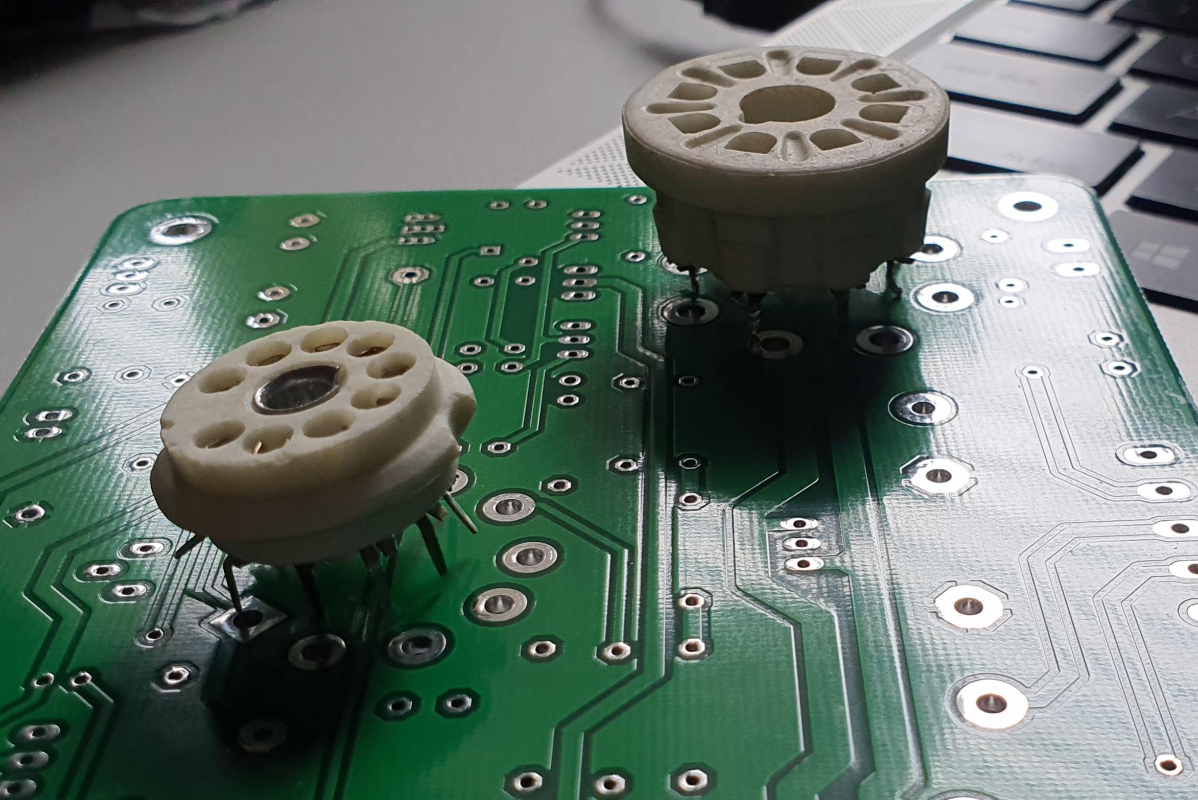

Sorry if this is a dumb question but I can't seem to find tube sockets that will fit the PCB. I have several types in my stash I was planning to use but none come close to fitting. Can someone send me a link for a socket that they have successfully used please 😕
Thanks!
Andrew
I don't know if it's me but I can't get any socket to fit. I can order new sockets but that will have a month+ lead time and there's no certainty they will fit either. Am I missing something?? 😕
Hi Dagwood,
The picture isn't very good....the pins aren't long enough to reach the holes. I think I have to buy some sockets . The pins in the photo for the octal have a diameter of about 20mm. The part you linked to has a diameter of 26mm...
Indeed I don't think it is the correct socket. I tried the usual metal pins, and the teflon socket with machined solid pins and they fit nicely on the PCB. My PCB octal footprint is my own custom one, with larger soldering pads, larger holes, for easy soldering, and l more flexible mouting depending on socket used. Keep in mind that sometime you have to bend the socket pins to fits, there are a few models of tube socket and or mounting pins out there. You need to make them fit the PCB.

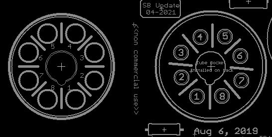

Just got a question from a user regarding the socket mounting on the back. Here my answer. Yes the marking is correct, and yes you mount the socket on the back.
I used a custom reversed octal tube object in Eagle for the PCB. I wanted to show from the user point of view the actual tube pins, if working on the pcb from under the amp. Check the picture, the one on the left is the standard octal tube from Eagle library, the one on the right is my custom reversed octal, with pin number reversed
So to resume the pin number you see are as seen through a transparent pcb, of the tube socket mounted on the back...
Hope it is clearer.
