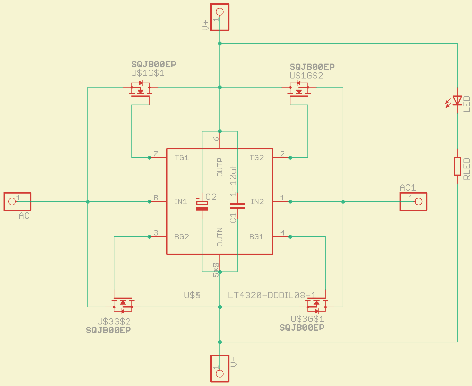

Hi Prasi,
Did you ever post a schematic with part numbers for the active bridge? I noticed this is an 8pin SMT and different than the 12pin MSOP package I used. DFNs are a bit trickier to solder as there are no exposed leads like MSOP. Just confirming you are specifying the LT4320xDD package? Let us know if you have a dual die n channel low Rdson MOSFET in mind. I was going to suggest the SQJQ910 as a possibility. Maybe you spec’d all of this but I must have missed it. Good call to add an indicator LED on backside and optional electrolytic. Thank you for including these as gifts with our CRCRC orders. If folks give this a try and use it instead of the bank of 8 x TO220 MUR diodes and their requisite heatsinks and caps, you will find improved voltage headroom, lower (none) switching noise, and almost no heat dissipated for a cooler running amp. Plus, overall cost is less than traditional route and it’s faster and easier to build.

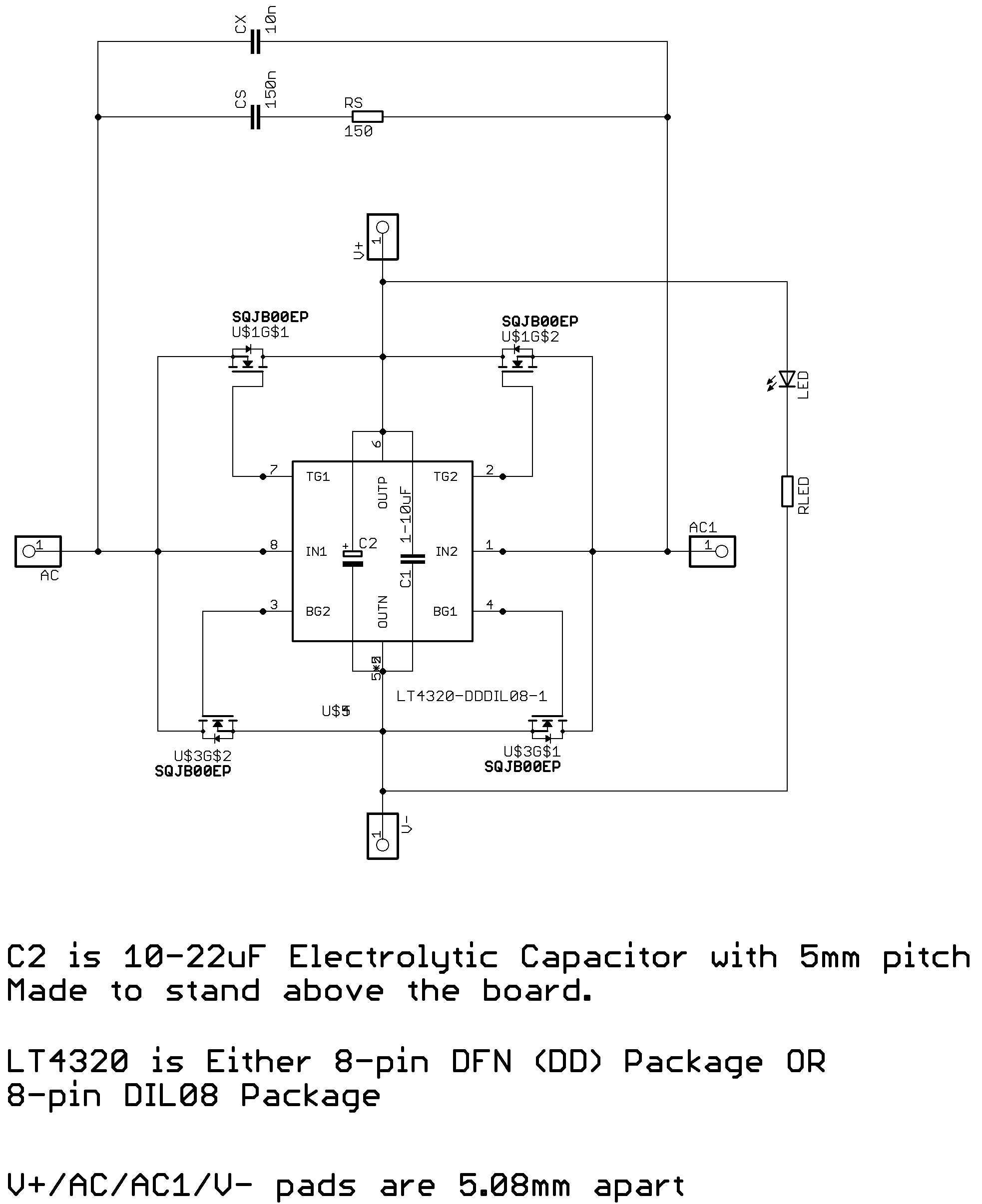

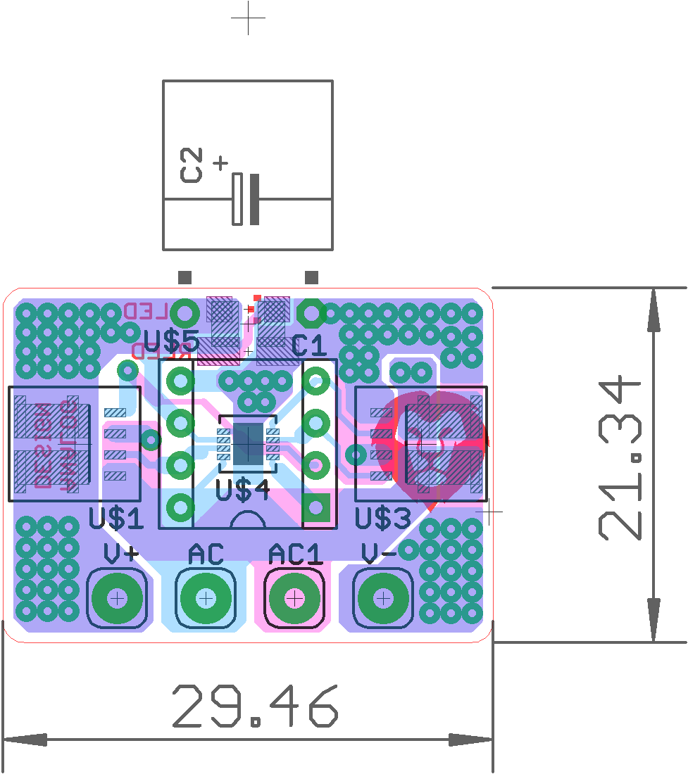

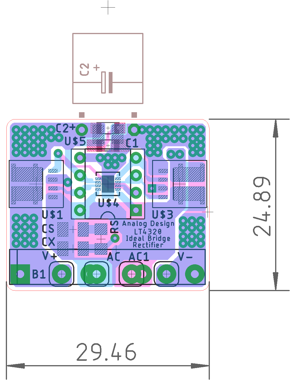

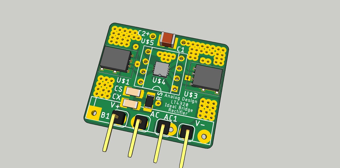

Here are the schema and BoM for both versions of the ideal bridge rectifiers.
ver1. without AC snubbers (smaller PCB- 21.5mmx30mm)
ver2. with AC snubbers (bigger PCB- 25mm X 30mm)
I was unable to include these in all the packages as I ran out of rectifier PCBs.
The BoM attached is for the rectifier with snubber components.
I had in mind , the SQJB00EP mosfet , which is will generate about 10mW/ amp more than the mosfet you suggested above. Still should work well in the design.
Regarding the LT4320 package, I have incorporated options for both DFN as well as DIP08 package. Only those who are good with smd soldering may attempt soldering DFN package.
