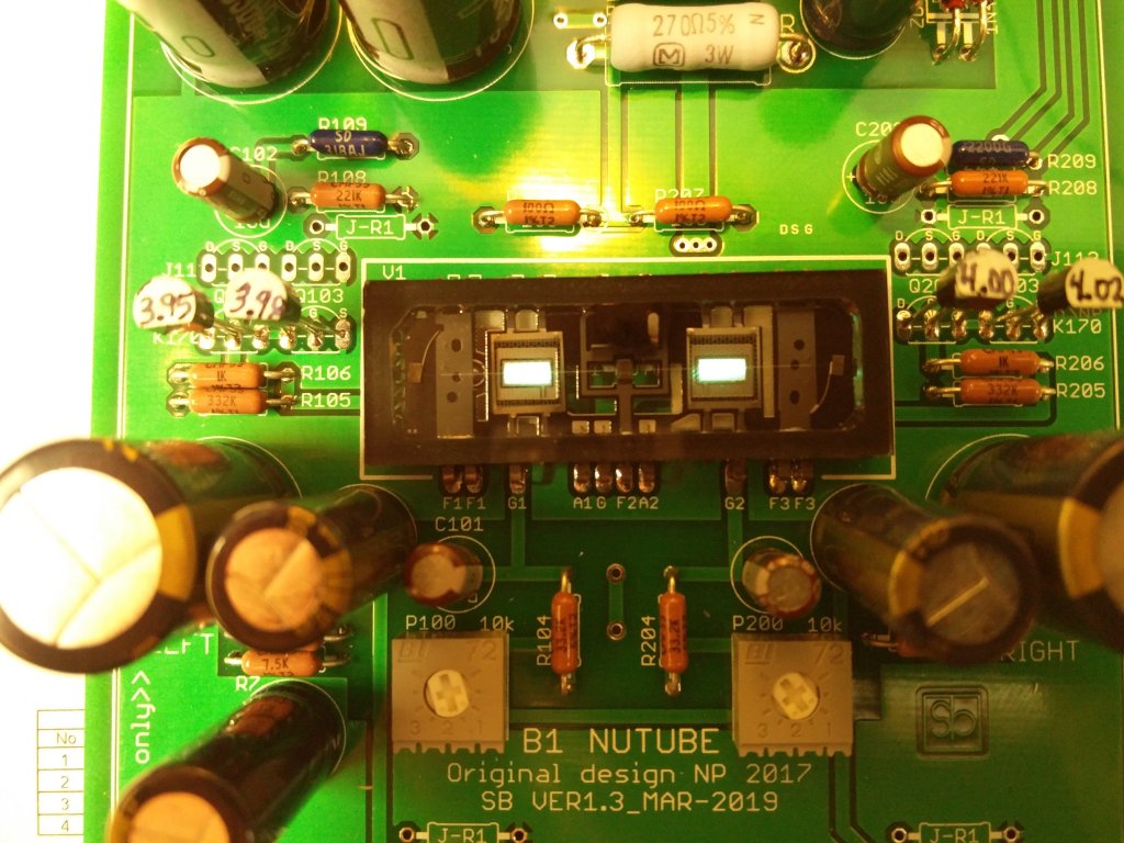

Hi. Tallest capacitor, at the most! is 40mm, if using the 1455N2201 Hammond enclosure. The PCB size, designed to fit the same enclosure is 4'' x 8.75''
PCB was shipped a few days ago, should be here within the next 1-2 weeks...

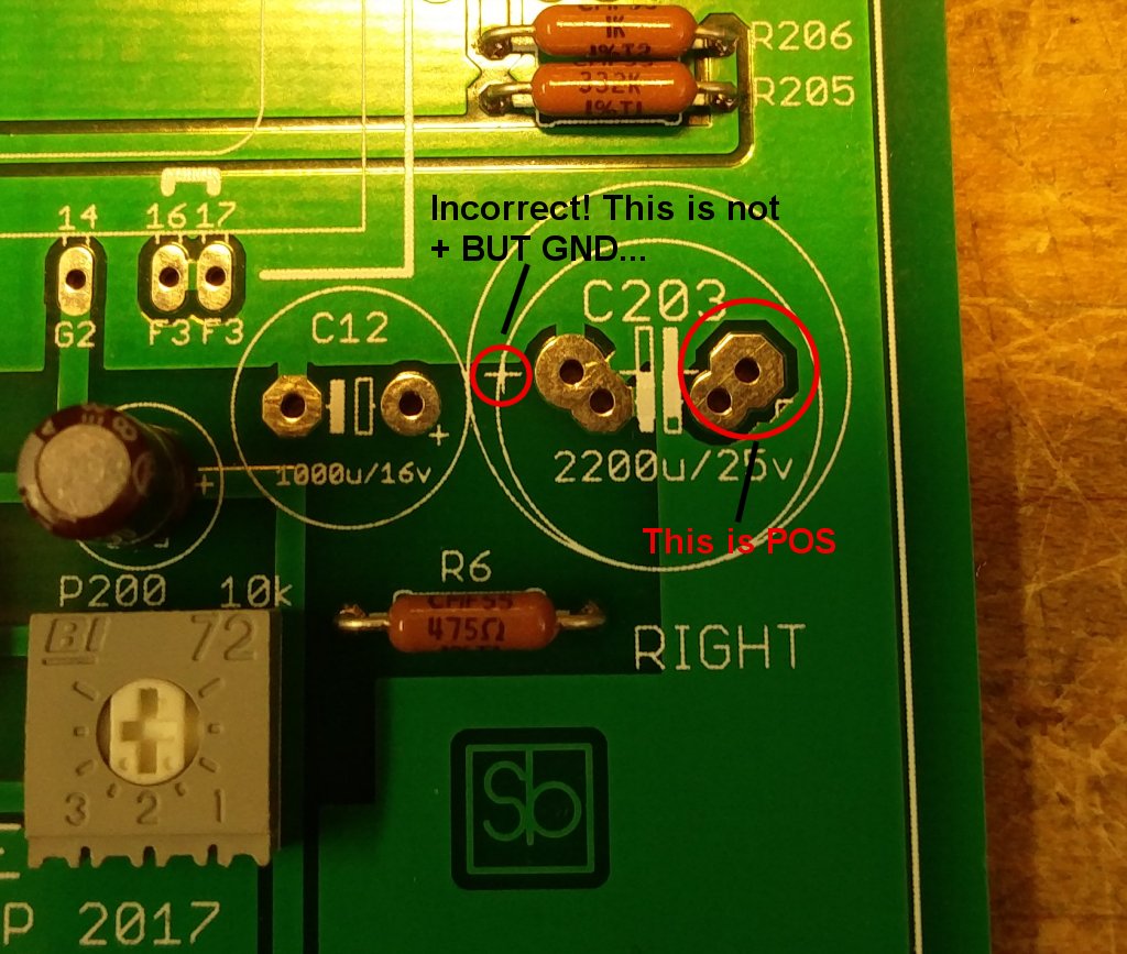

Found one error on C203 silkscreen, see picture. One '+' sign is wrong, it is in fact a GND pin. Please make sure to install C203 correctly...
