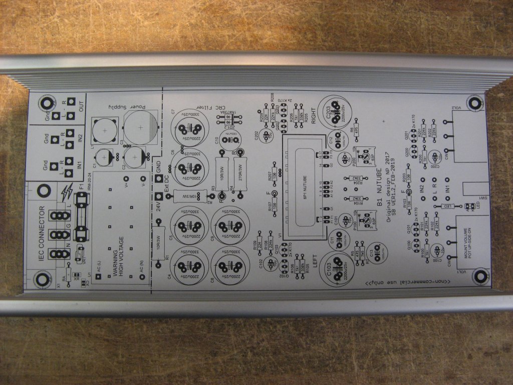

I completed the Gerber, with extensive checks 😉 and I'll place the order tomorrow.
Here the PCB mechanical check into the recommended Hammond enclosure, it works perfectly 😉
Absolute capacitor height inside this enclosure is 40mm

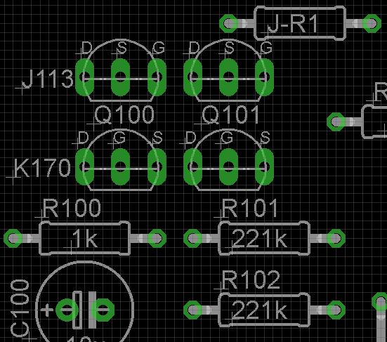

Hmmm, diyaudio kits come with Fairchild j113 and two options on the board to solder 2sk170, LSK170, 2sk370 OR J113 which has a different pinout. IT would-be be nice in “our” boards have this option too. Do you think that would-be still be possible Algar-emi? Am I right that when using J113 a resistor value changes? (R1 in the original Pass scheme?)
For me J113 is a serious option because it is easily available over here.
Just enough time. Will check to add the J113 pinout, but the board won,t be as pretty 😉
But just a question, is J113 usable directly or will need a degenerative resistor, like into the LX-Mini crossover?
Thanks! I'm afraad my tecknical knowledge is not enough to answer your question.

Q1 and Q2 transistors are selected for specific Idss values, and the R1 values are matched to the Q2 Jfets. For J113 parts, the Idss of Q1 is set to be equal to current through Q2, and with the 2SK parts it is matched and the value of R1 is zero. The kits are provided with selected J113's, and note that Q1/Q2 are not interchangeable. The use of the other parts involves matched Idss values ranging from about 4 to 8 mA.

OK, I'll reproduce the same K/J layout and the addtion of R1, but I cannot help you with the special JFET selction 😉
Should be done this afternoon. SB
