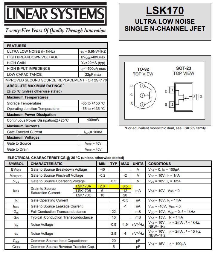

I believe we need the LSK170A to get them matched between 3-6.5mA. Unfortunately Pass' paper specify between 3-8mA and there is a risk of getting a few below 3mA as per the attachment.
I plan in matching them like Mr Pass' post.

GASCo take note that LSK part are much more variable from JFET to JFET than Toshiba part used to be. You may need more to be able to do a match. I recommend that you ask someone in the admin section of this forum to get in touch with the Diyaudio Store guys.

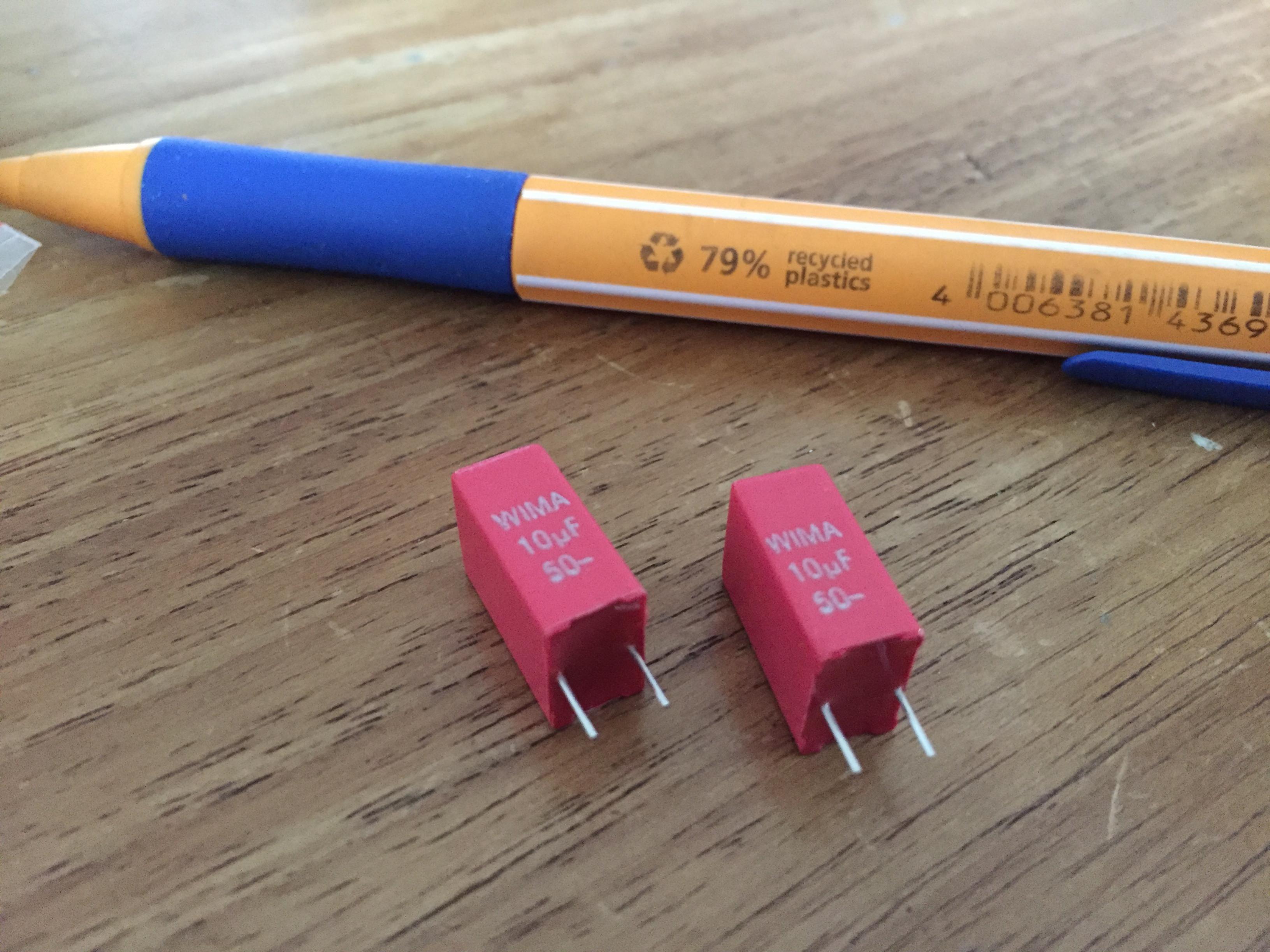

Then adapting to 10 µF 50V film caps in 5 mm pitch still is possible. They just need a few mm more space than electrolytic caps as they are wider. I really do not understand the design goal when using tubes and precious JFETS together with the worst of the worst in caps.
I'm with you on the capacitor upgrade. I've been focused on replacing electrolytics with polypropylene since I read Walter G. Jung's and Richard Marsh's article in Audio magazine back in 1980.

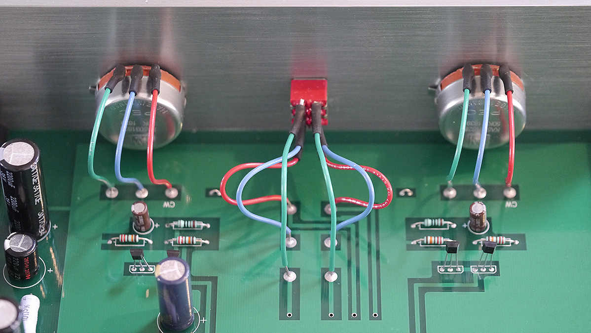

Probably a silly question, but are the 50k pots to control the volumes of CH1 and CH2 or to control LH and RH?
And the silk says 'mount volume pot upside down'. Does that mean the pots are connected via flying leads if the PCB is mounted at the bottom of the case?
Also - is this board always live when plugged in or has a jumper been incorporated to allow for a switch?
Two pots, volume, one per channel. See the picture. You can also use just one stereo (2 channels) pot, and connect the wires accordingly...
Always live, but you can easily modified the board to add a switch, just one trace to cut, or use an AC inlet with integrated switch, or don't use an ac inlet pcb mounted, and run the ac wires from the socket to the pcb, while doing so, run the live wire through a power switch.
The PCB is made to accept Stackon tab connectors on the AC inlet location to use an off board ac inlet for this reason... There is a lot of options.
