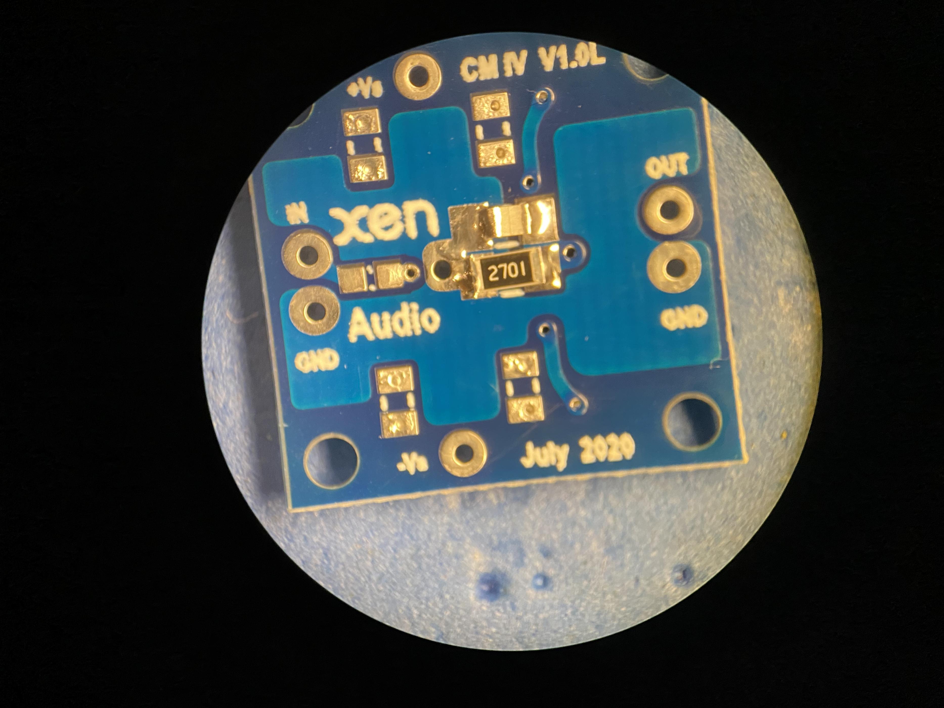

Someone asked about a component pad in series with the input.
This is for a 0603 0R (jumper) resistor if you are using 1mA DAC current.
If you have more DAC current, you need to use multiple modules in parallel.
In that case, you should use a 1R resistor at that location.
So at least one person has started building. 😉
Patrick
Yup, that was me, guilty as charged. Thanks for the clarification of this resistor/jumper pad Patrick 🙂

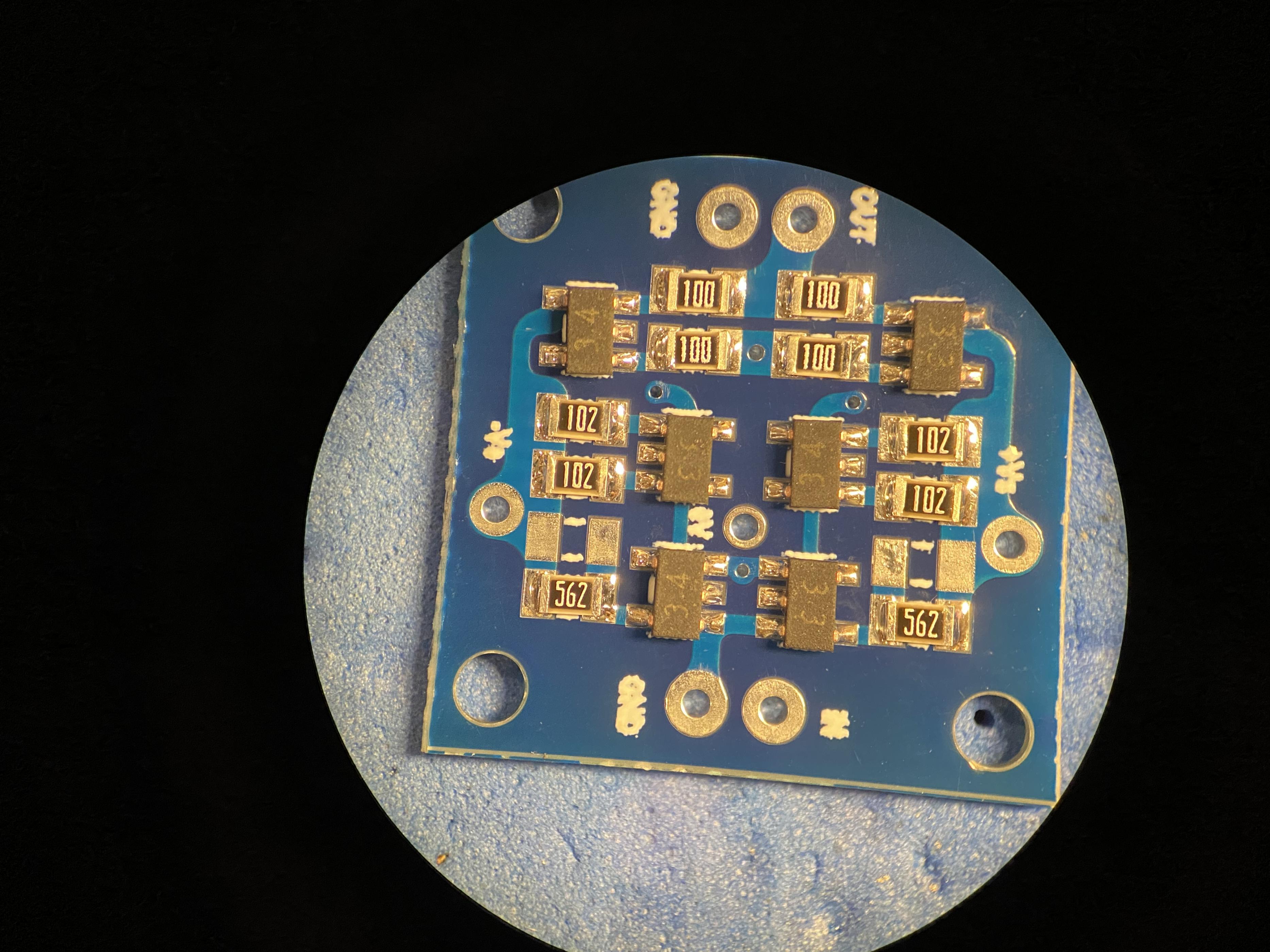

I finally got a chance to solder up a pair of boards, neat little buggers! Next step will be fine tuning with the trim resistors.
