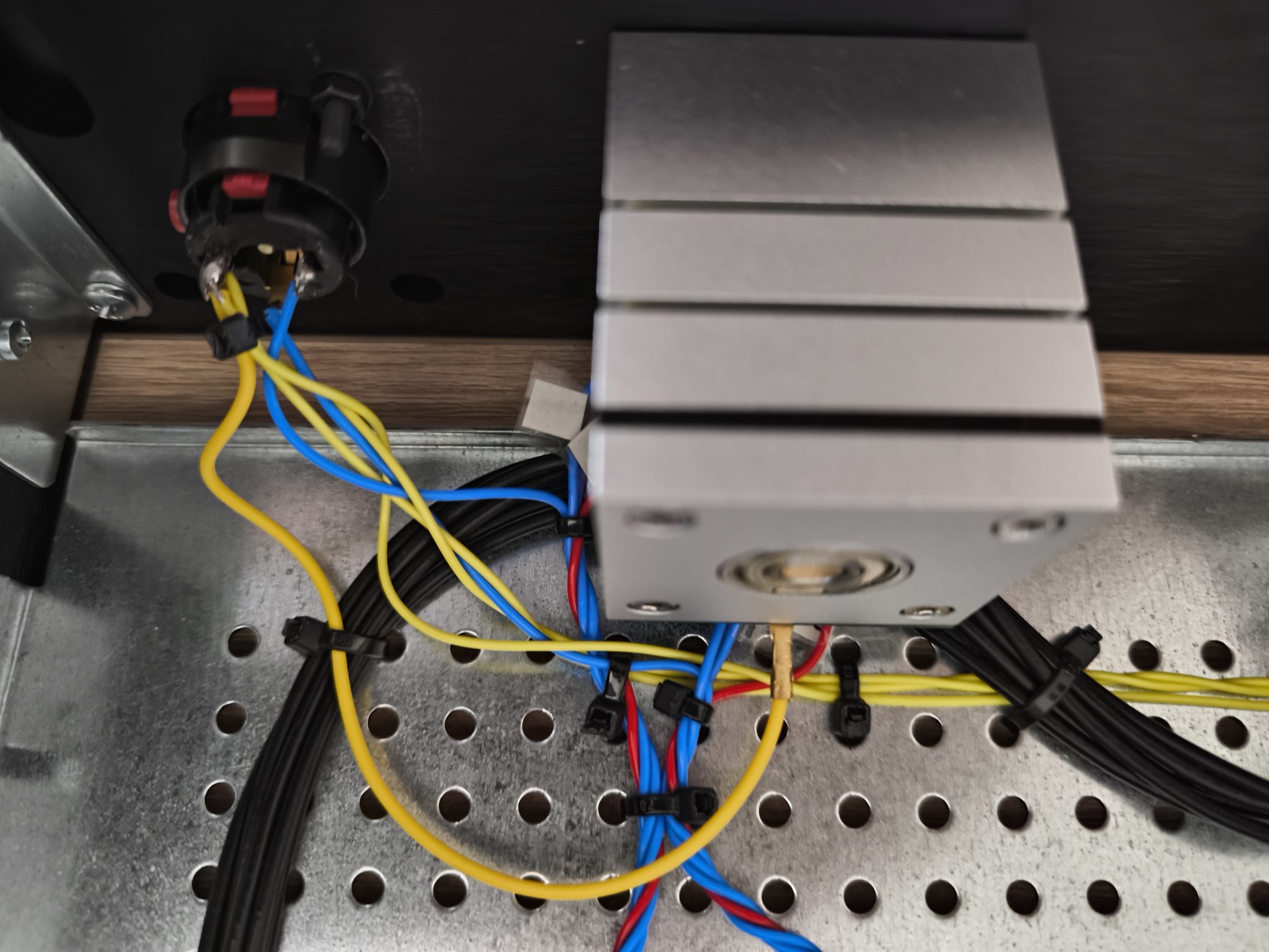

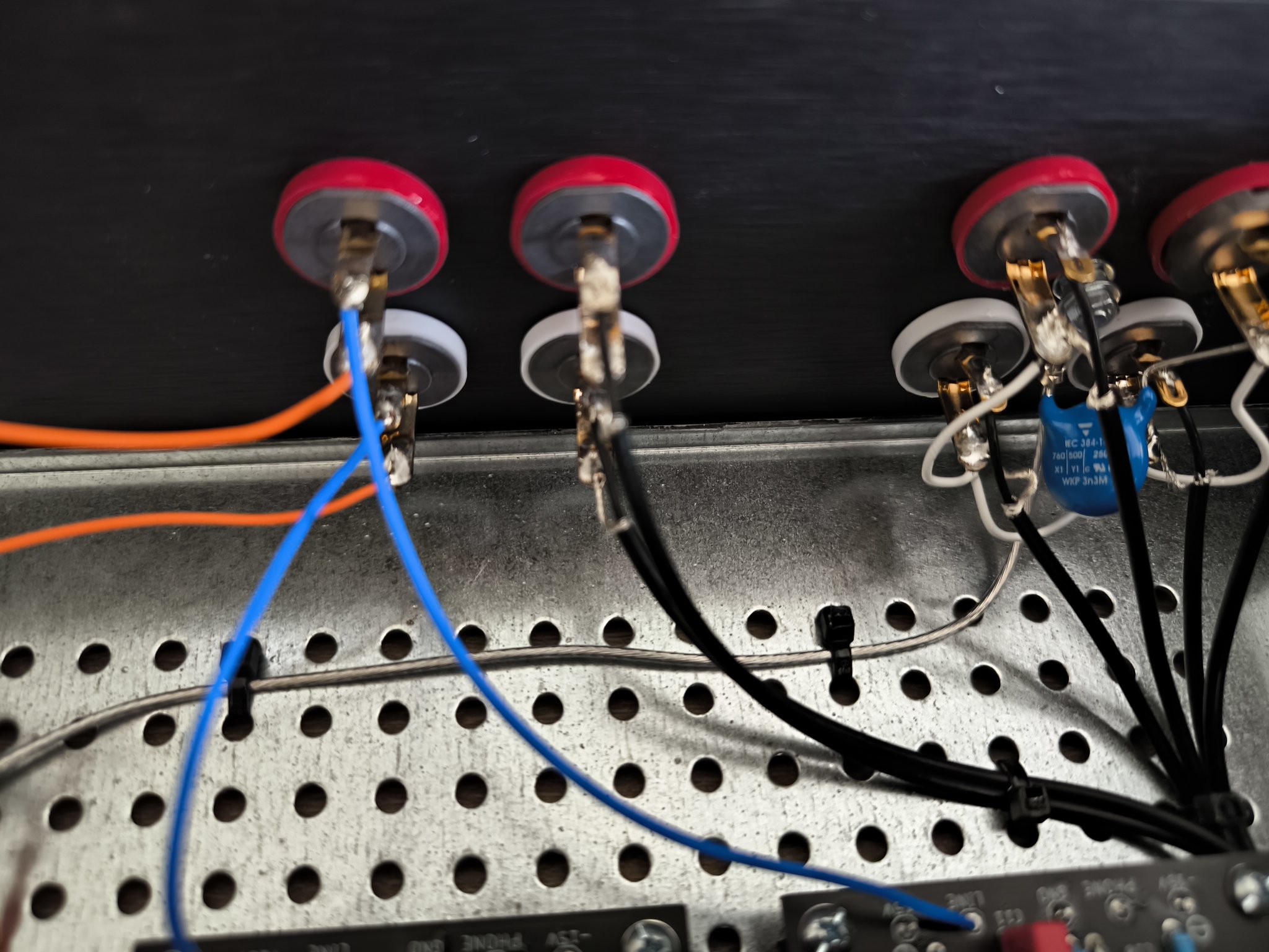

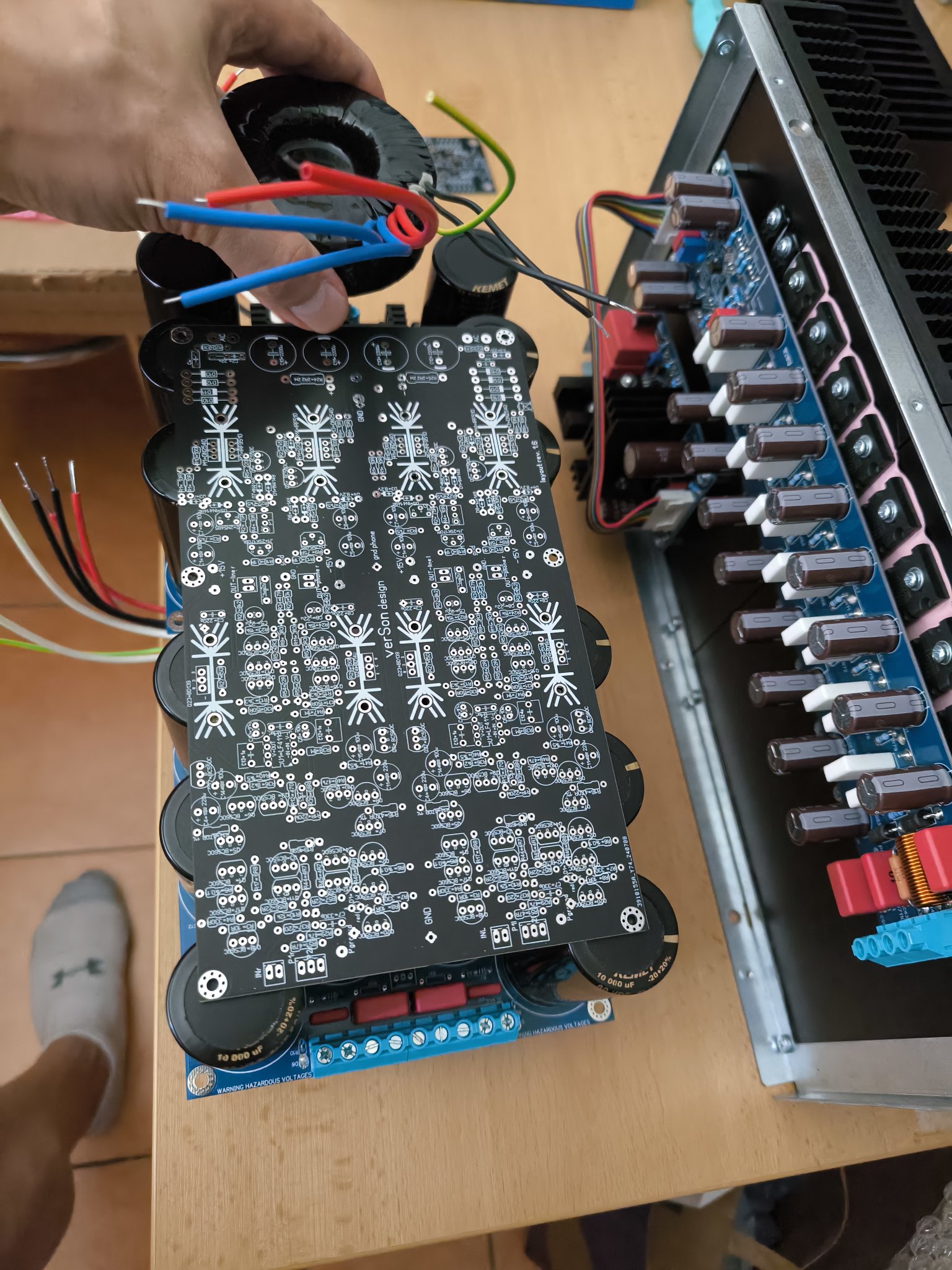

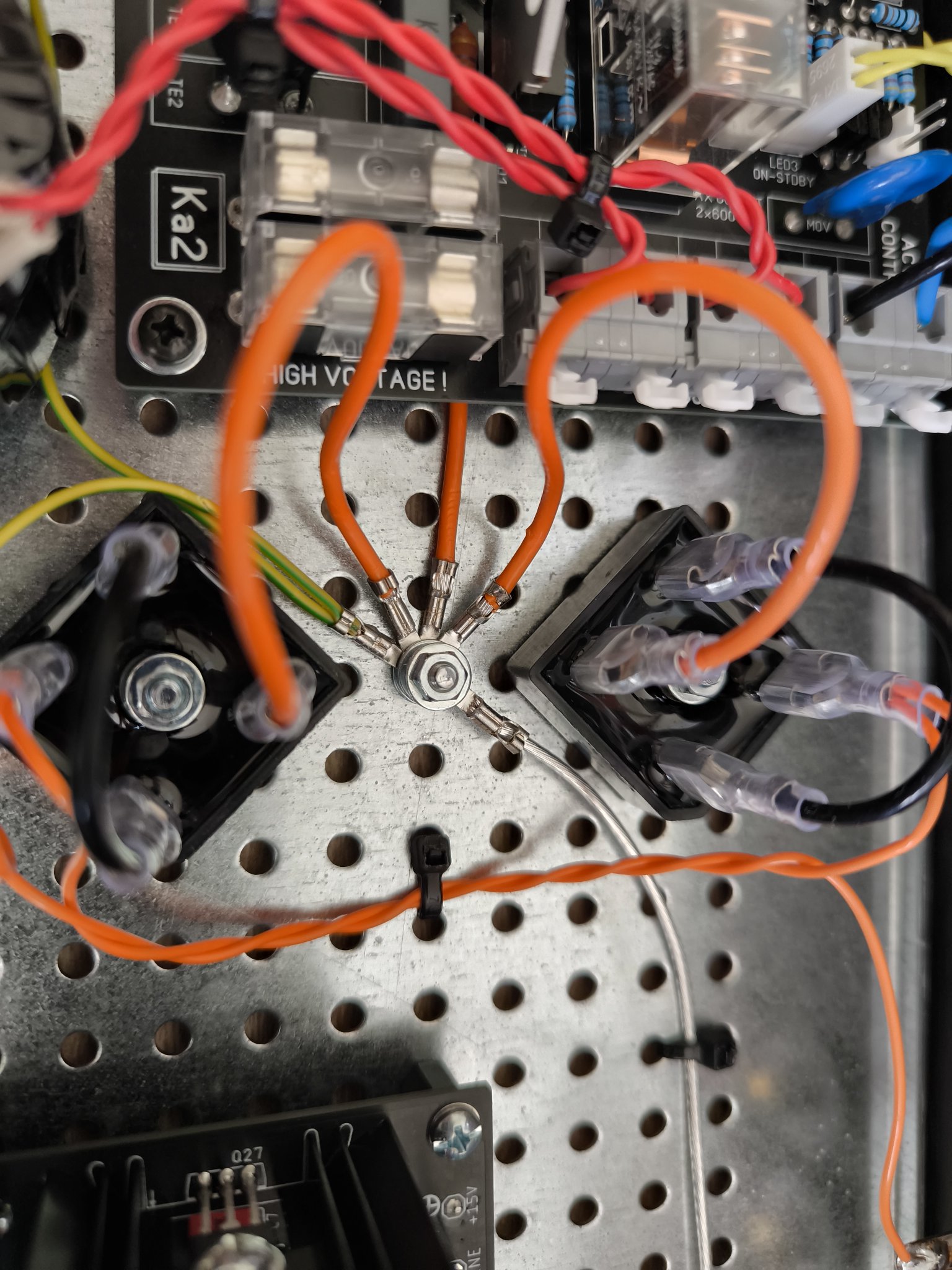

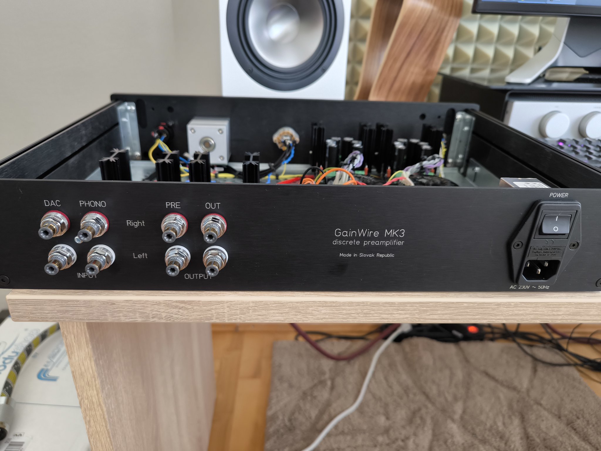

I'm done, I'm happy with the sound. All I have to do now is to fit the sturdy Dynavox feet on the bottom lid.
I've listened to different genres (techno, hardstyle, pop, rock), the bass is stunning, the vocals are crystal clear...

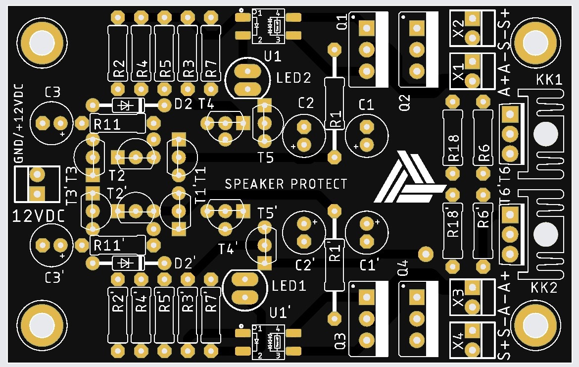

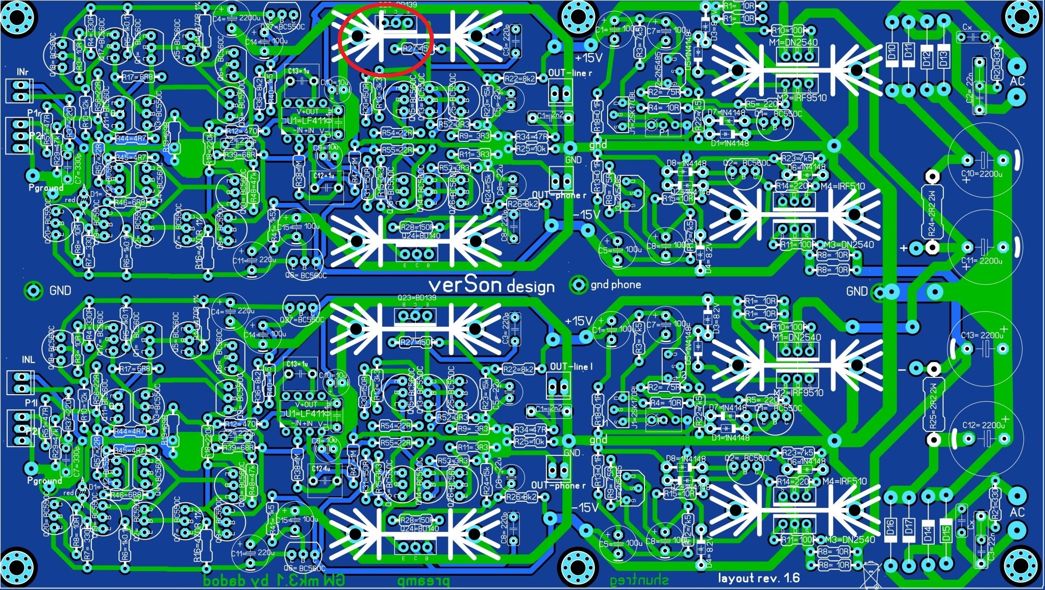

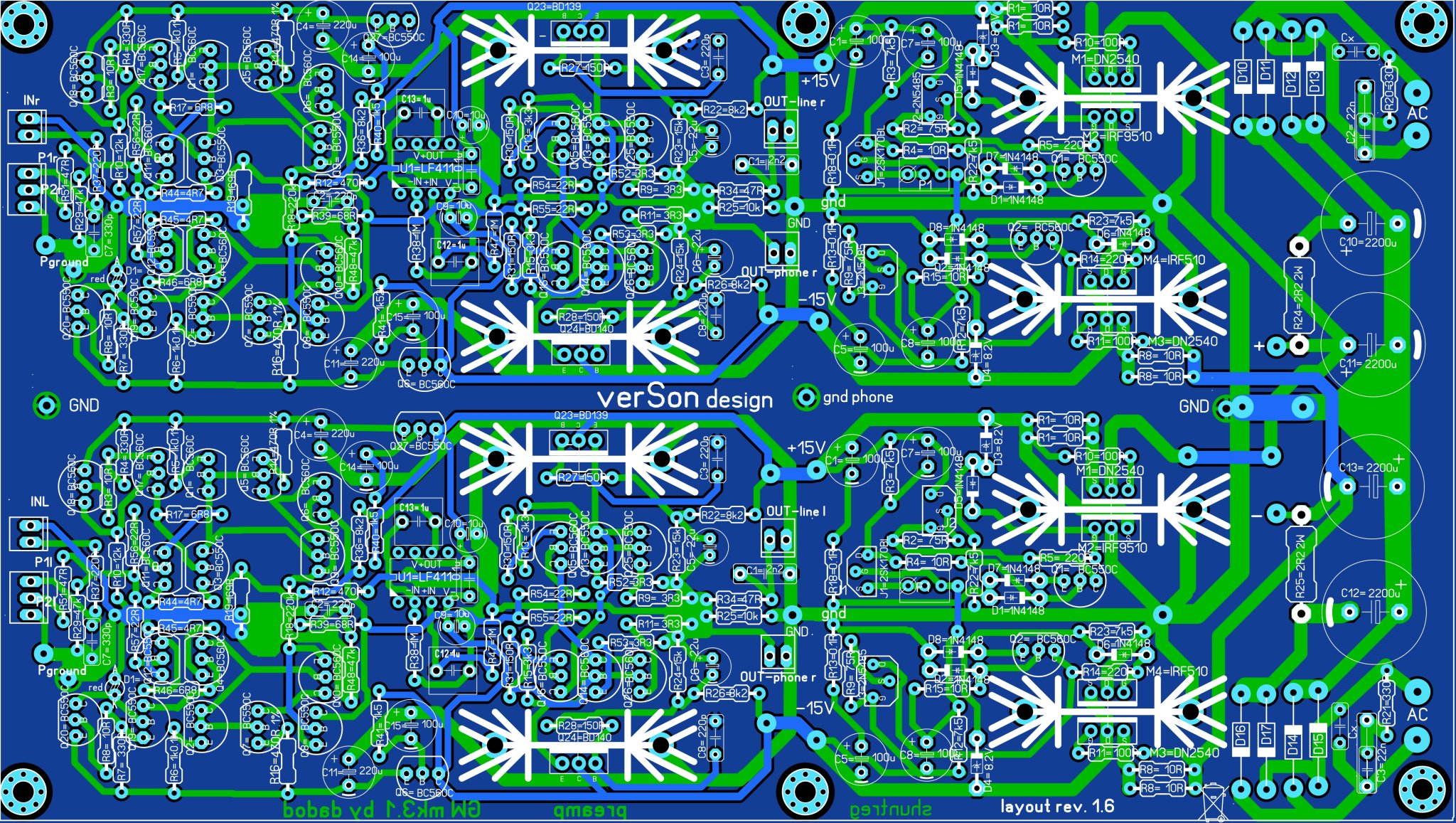

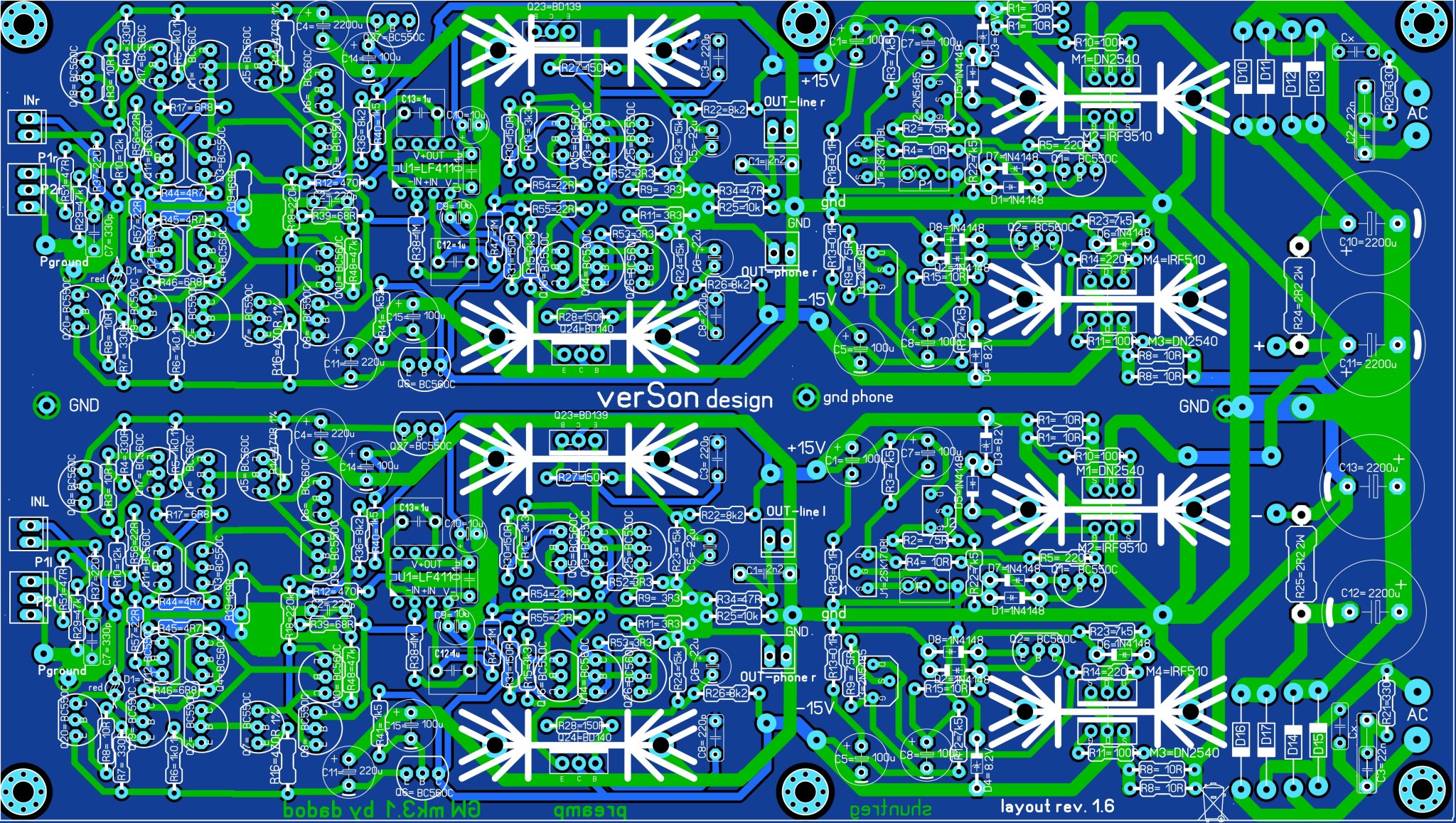

Here is new layout with Molex connection and R32 removed and replaced with short connection.

With my PCB no need for two mains transformer, one is enough to get full dual mono configuration.

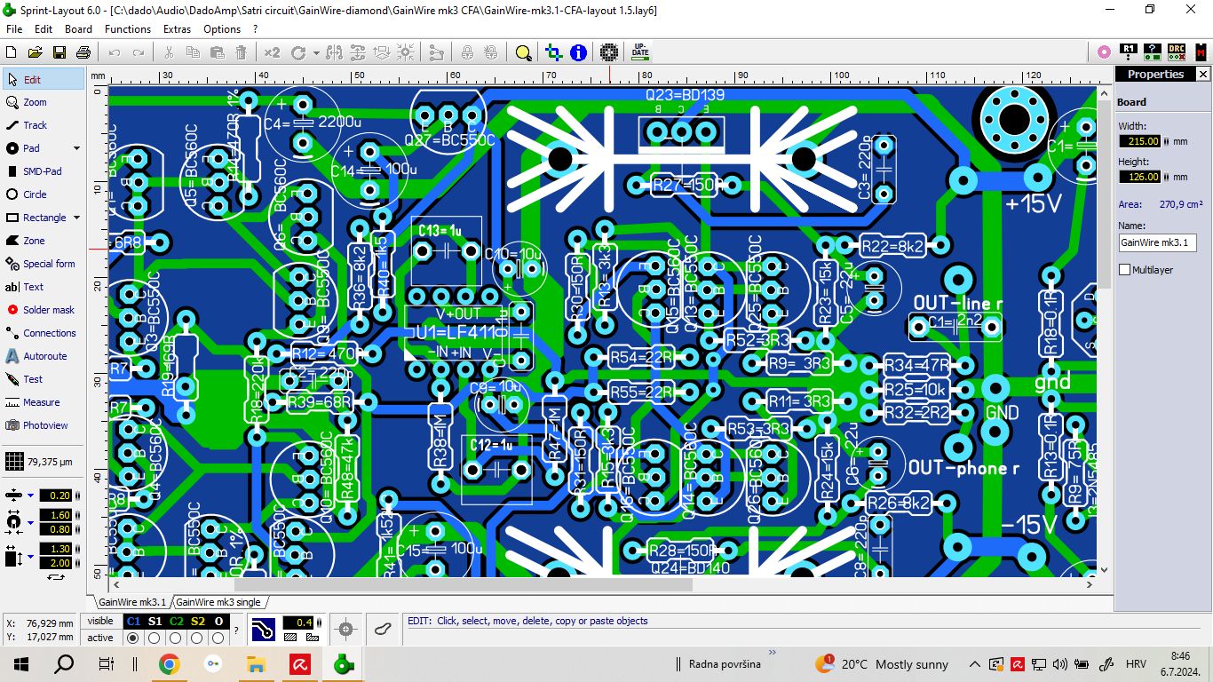

Late I noticed the pcb contains a bug. The boards are already in production and I can throw them in the trash.Here is new layout with Molex connection and R32 removed and replaced with short connection.

Q23 at the top (bd 139 is outside the heat sink)
correction on silkscreen: C4 at the top is wrong 2200uF should be 220uF
I am very sorry, was in hurry to add molex connectors and by accident moved that transistor.
You don't need to throw the boards just drill to new holes for Q23 and some intervention on the tracks it should be OK.
Sorry Damir
Regarding C4 and C11 not critical, you can also use 100 uF in those positions.
Sorry Damir

Next step is to use SMD parts, but I don't have time now to design completely new layout.
Thanks for the great design Damir! I really appreciate the gerbers you have shared also.Correct gerbers, in the post #422 gerbers with error.
I have a request, can you please share only the pre-amp part of the board (gerbers) separately, without the power-supply. It would be of great help to me.
I have designed only this PCB with preamp and power supply ingreted and not separate preamp, sorry. This preamp is designed to work best with this power supply.
I could in future design the new board with SMD parts, I finnished with trough hole parts.

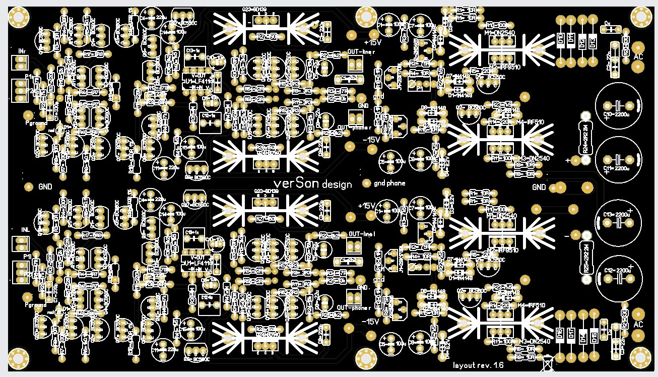

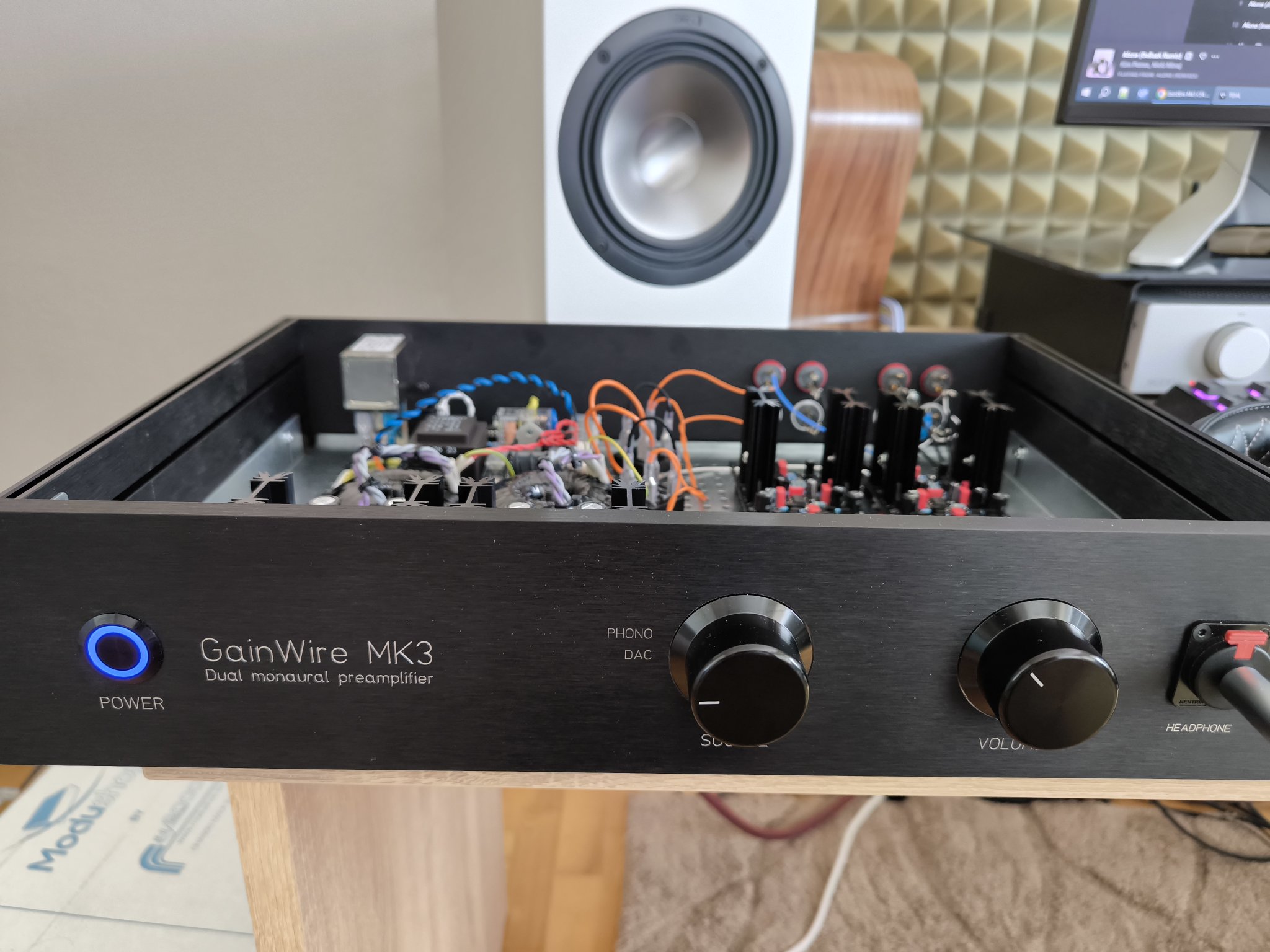

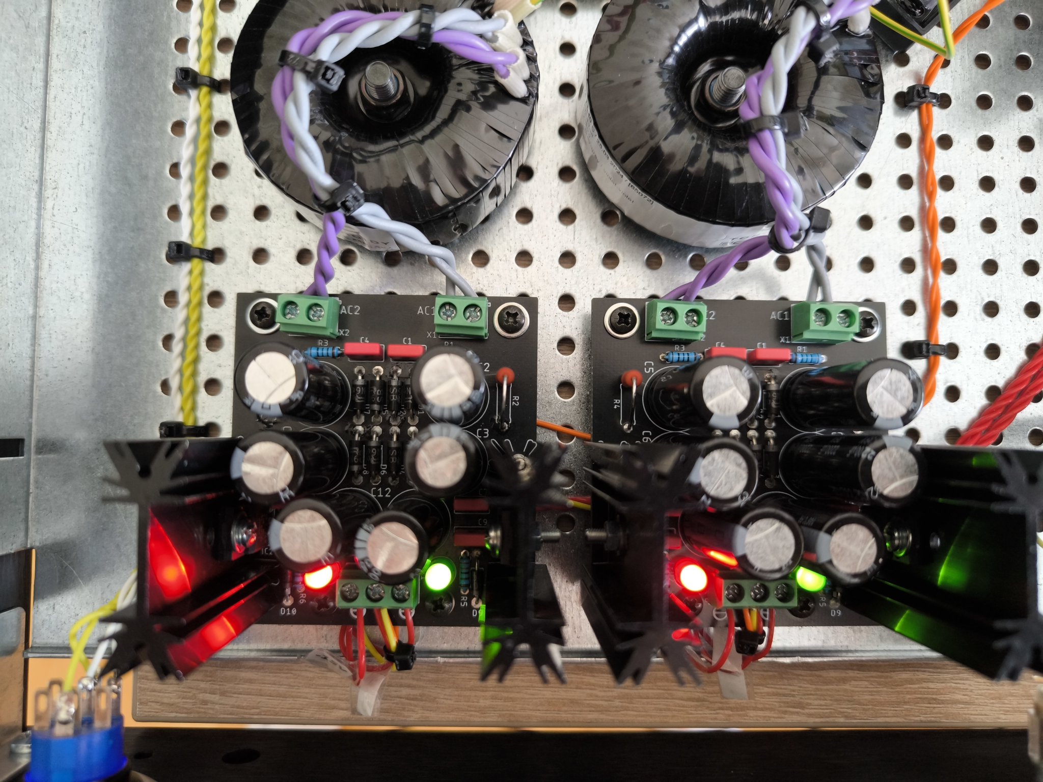

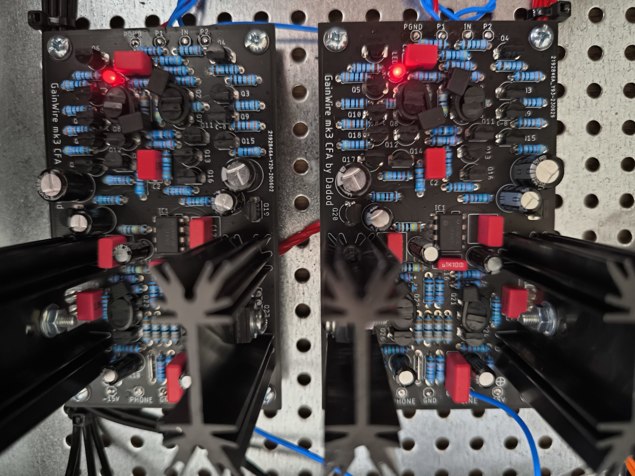

Hi, I want to fit the new GainWire board with better resistors than the prototype above, but I don't know if it makes sense? The prototype was fitted with ordinary YEGEO resistors, and no noise was audible, now the question is whether it makes sense to use Vishay MRS25 or RN55/CMF55 low-noise resistors on the new board?
I already have the boards at home, expecting the parts from digikey at the beginning of the week. I have decided that I will only do this GainWire MK3 (CFA) and it will be part of a large integrated amplifier in a 5U modushop box. I really like the sound of this GainWire MK3, and I have to listen to it (until I'm completely deaf) not just build new ones over and over again...
For dimensional reasons I have to use heat sinks with a length of 38mm (11K/W). The 50.8mm long heatsinks reached a temperature of about 30°C (9K/W).

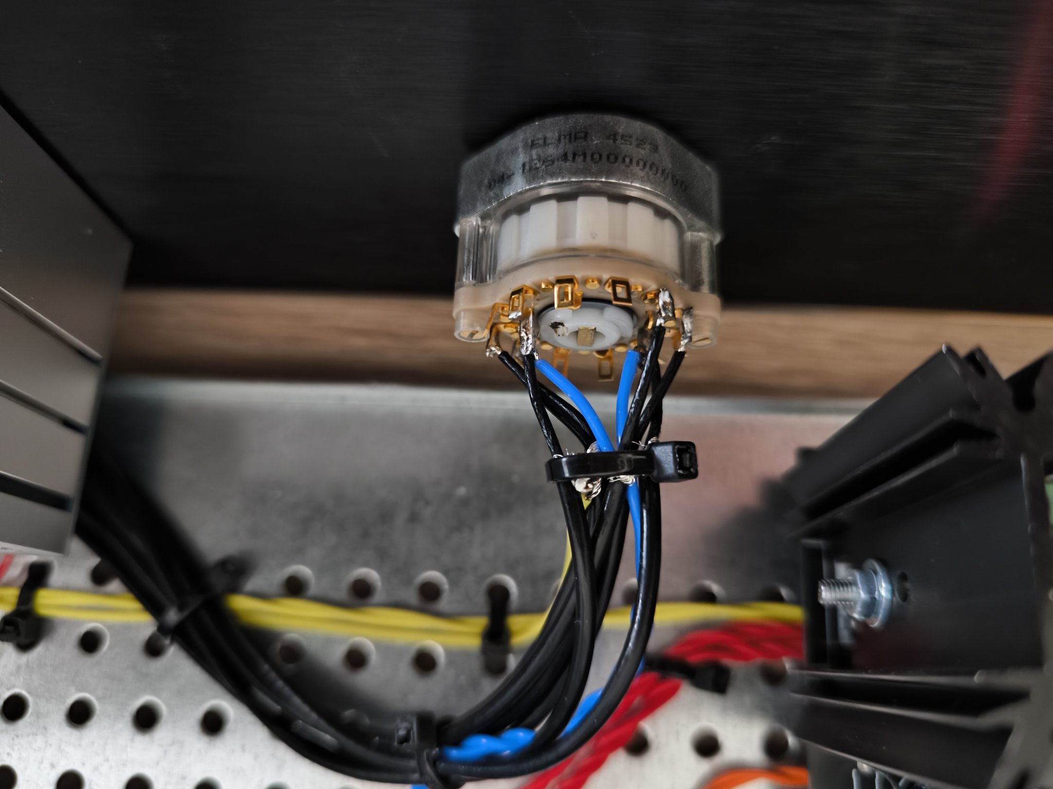

The input switching will be from Salas (I-Select), which already has it on the way. Above the filter capacitors will be the inner pierced base will still be adjusted to the required size.
