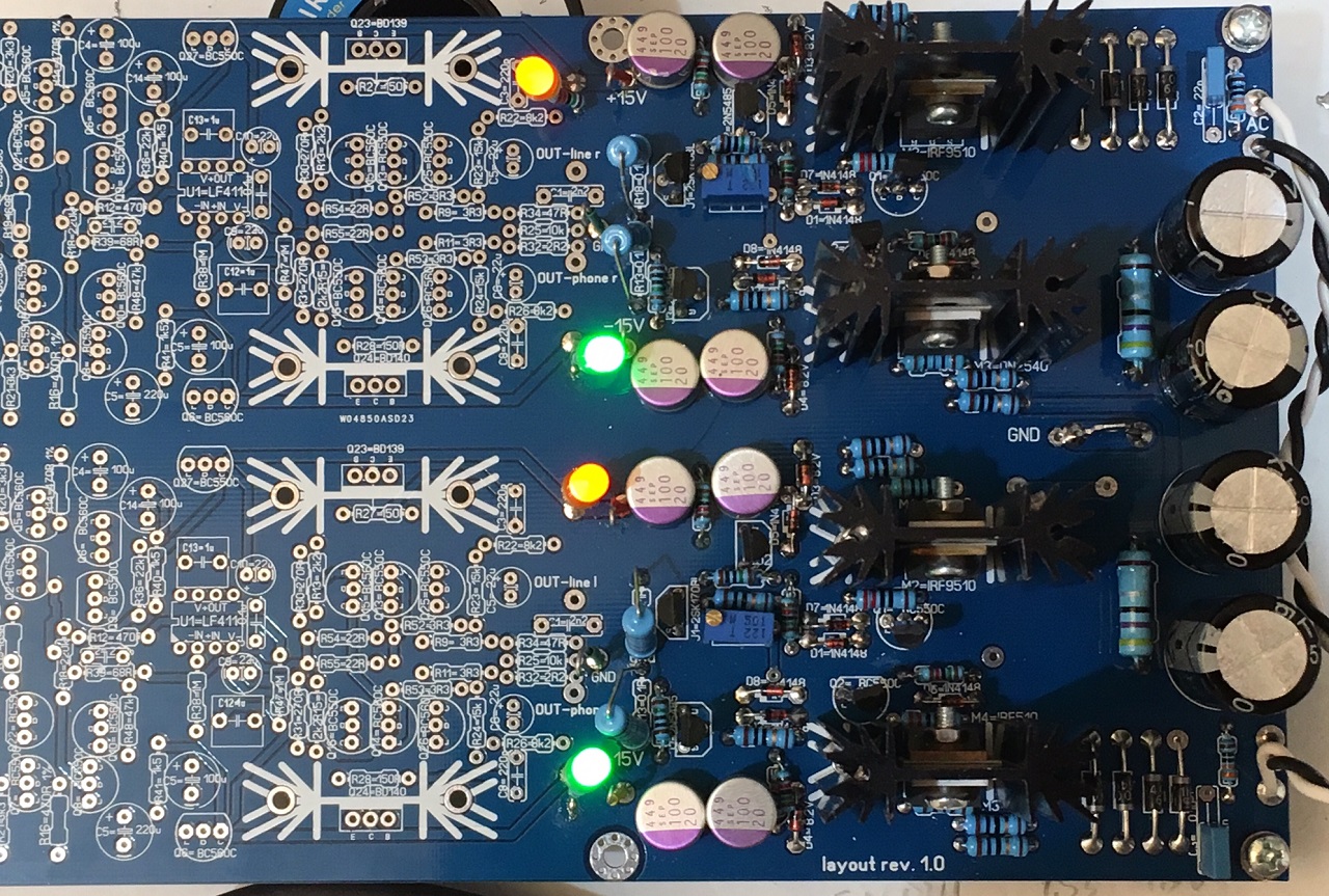

I pulled out the 2SK170 from the top +ve rail and it tested it and it was dead. So was the 2N5485. I did not have anymore 2N5485's so replaced with a 2SJ113 and replaced the 2SK170BL. The top has adjustable voltage now. I decided to change out all the 2N5485's with 2SJ113 so at least they are all consistent. Both +ve supplies shunt regulate to 15.0v well now. However, nothing happens on the negative rails when the trimpot is adjusted. Is the negative rail supposed to be a mirror voltage compared to the postive rail? Why does it not have its own pot?
I went in and pulled out all the BC550 and BC560's in the PSU (they tested fine) but replaced them with fresh ones (also tested prior to installation).
I used a diode tester on all 1N4148's and the 8.2v zeners - they all show typical 0.56v forward voltage drop as a diode should. Their orientations are all correct.
Here is a closeup photo. For 75R resistors, I paralleled two 150R's. For 7k5 I paralleled two 15k's.
So at this point, the positive rails are responsive to pot adjustments. The negative rails just sit at -19.5v and no heat is generated in the MOSFET heatsinks - so no shunting is happening. On postive rails, the MOSFETs are shunting and it is warm but not hot.
Also, in case you are wondering about the tabs on MOSFETs and heatsinks, I am using silicone insulator pads and insulating shoulder washers on bolts and nuts clamping the MOSFETs to the heatsink. I used continuity checker to makes sure none of the tabs are electrically connected to the bolts or heatsinks.

The photo is not very clear, but it looks that D8 is up side down on both channels.
Indeed it is reveresed! I missed that silkscreen error note!
Thanks!
Will flip those and give it a try now. Maybe we can move forward off of the PSU finally.
Edit: ok that fixed it! 🙂
Thanks for catching that. Ok can move on to the actual amp now.
That was my mistake, I forgot to put the link to that silkscreen error in first post. This is valid for first PCB order, second order had it corrected.

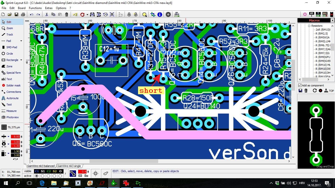

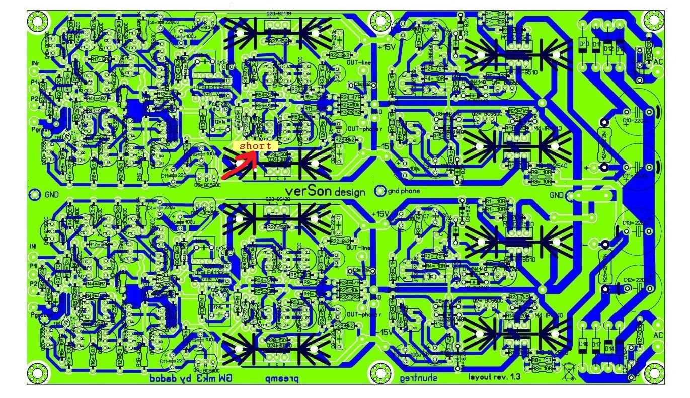

I have to report one error in last batch of the board layout rev. 1.3
There is on short connection showed in attached pictures. The short connection is between the upper trak going from R31 an R15 pad. It's necessary to remove tiny part of the copper between from the top side
I am surprised that no one yet reported problem with this board. Does it mean nobody assembled the board yet?
Sorry for inconvenient.
Damir

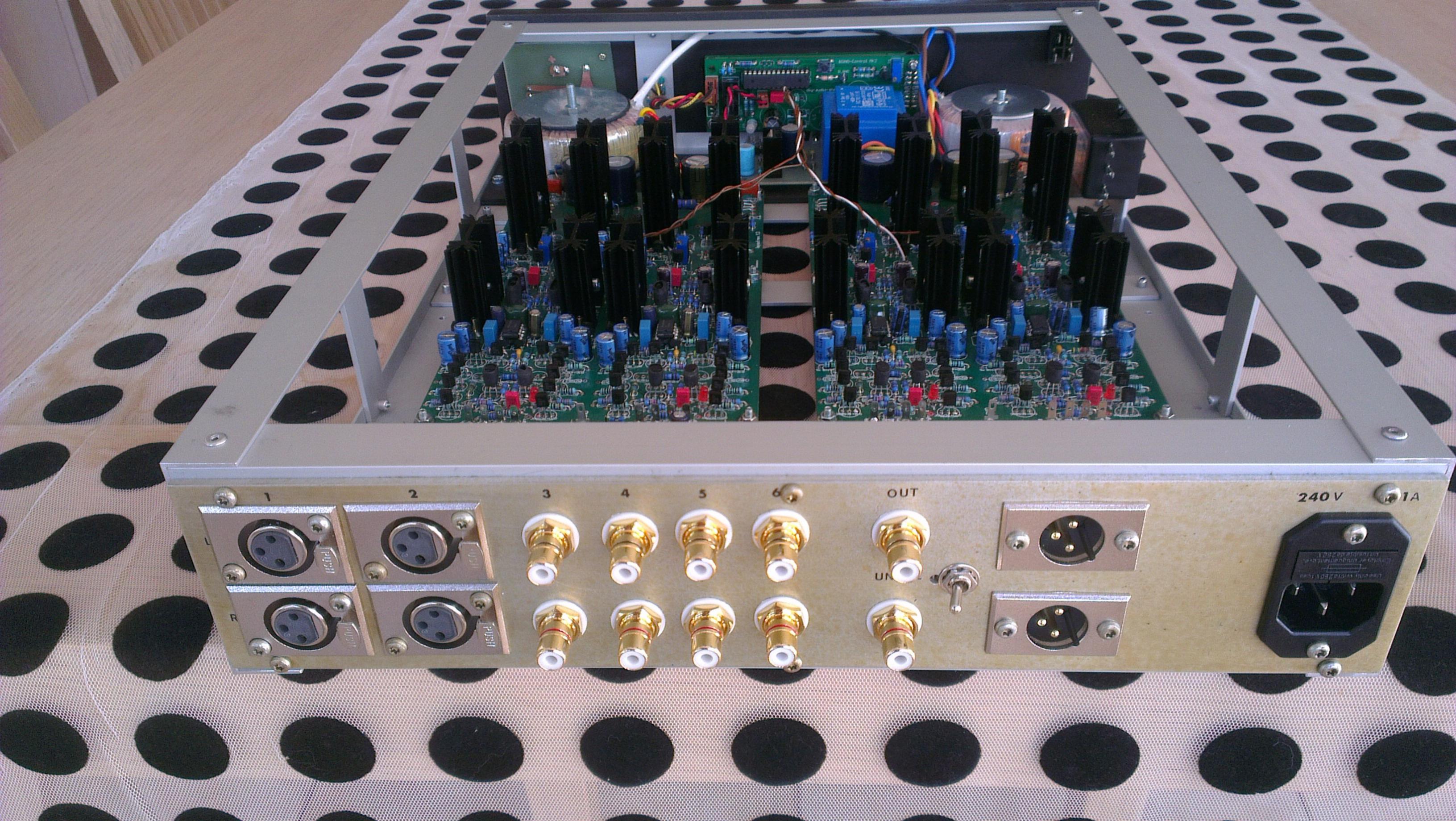

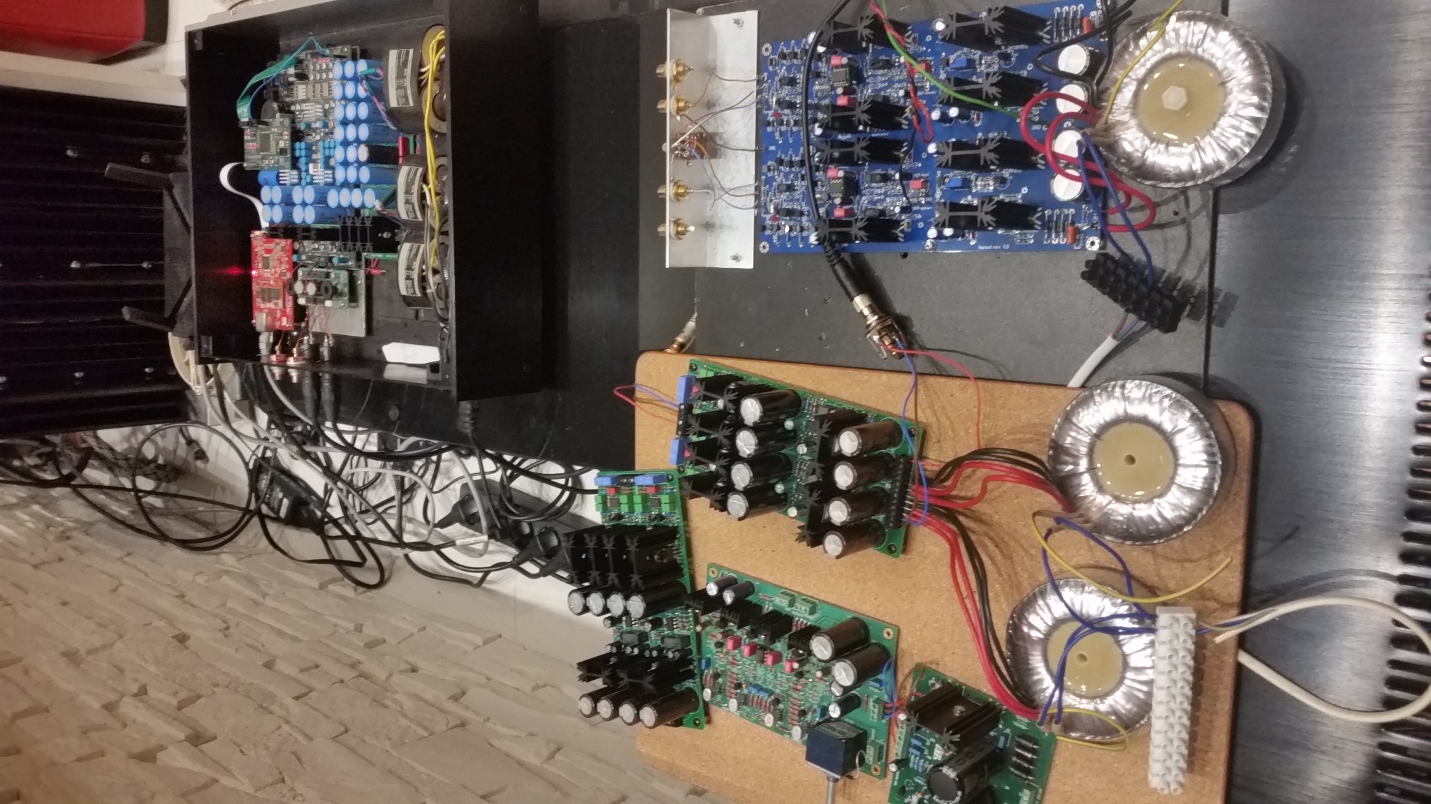

Finally I have some progres here, assembling the GW mk2 inside enclosure. Attached are progres photos, wiring and delayed output relays nor finished yet.
Beautiful work, very nice to see it all together.
The boards you use for the input are not available anymore.
Hope to see it all together with a Power Amp and then hear from you the whole SINGING impressions.
Great Job
