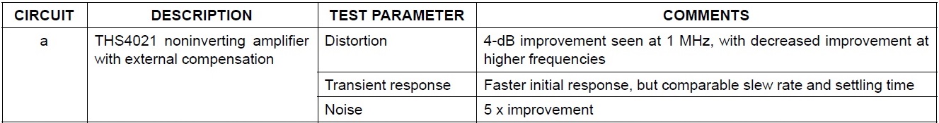

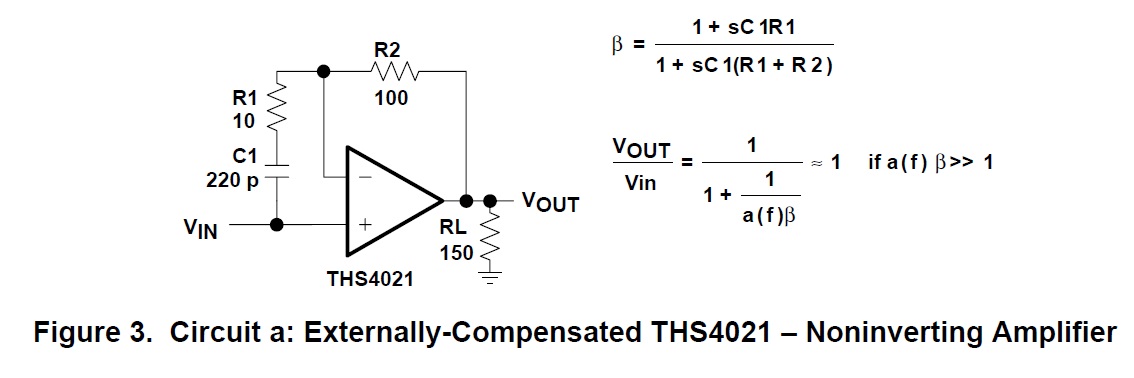

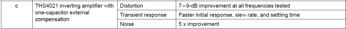

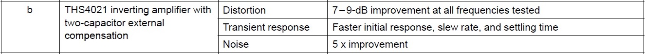

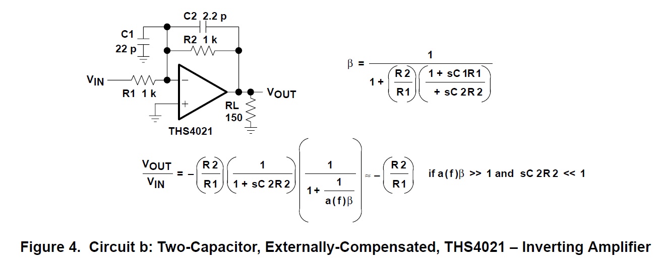

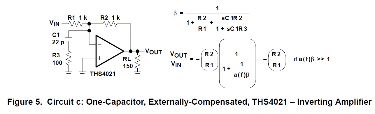

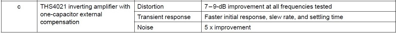

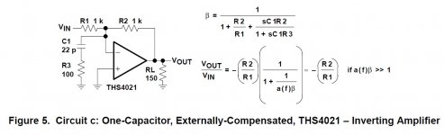

Improving Performance with Decompensated Operational Amplifiers
A chip amp is essentially a decompensated power opamp - the circuits for getting unity gain are shown in figs 3 and 4 (non-inverting and inverting, respectively).
Nice, thanks:
From the Conclusion:
The most obvious application to use a decompensated amplifier is in higher gain circuits. In applications with gains of 10 or more, using the THS4021 instead of the THS4011 results in over ten times more bandwidth, noise reduction by a factor of 5, and 1.5 times more slew rate.
To consider unity-gain performance, five different circuits have been tested for distortion, transient response, and noise performance. By comparing the noninverting amplifiers (circuit a versus circuit d) to the inverting amplifiers (circuits b and c versus circuit e), the following conclusions are drawn about using an externally-compensated THS4021 versus using the internally-compensated THS4011.
A tabulated comparison is shown in Table 2. In the inverting amplifiers (circuits b and c versus e), significant improvement in THD performance is seen across the frequencies tested. There was no significant difference between circuits b and c. For the noninverting amplifiers (circuit a versus d), improvement in THD performance is also seen, but it diminishes with frequency, with no advantage seen at 16 MHz.
Transient performance shows mixed results. Slew rate and settling time are somewhat better when comparing the inverting topologies, but appears to be little change for the noninverting amplifier. The noninverting amplifier (circuit a) shows considerable overshoot, which may be undesirable.
If the noise is bandwidth limited, the THS4021 shows better noise performance; but little difference is expected if the full bandwidth of the parts is utilized.
Wow, inverted really seems like the winner! 😱
