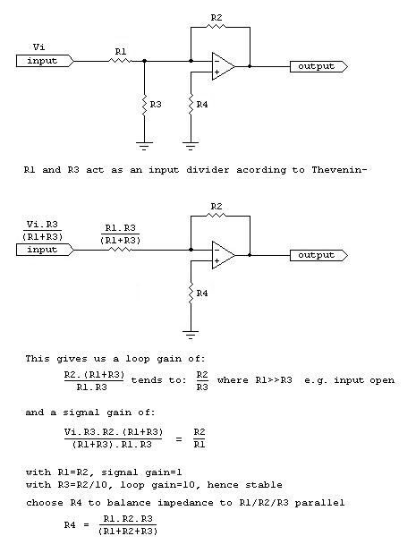

Unity-gain inverting clone
Built the circuit as per Keui's schematic (using TDA 2030, not the LM series), with the resistor values at 5.6 (- to GND), 4.7 (+ to ground) and 56 K (feedback and input).
How does it sound? In a word, brilliant. Deep and rich bass and controlled and clean top end, the non-inverting clone sounds like cough syrup now. Sweet at first taste, but...
Now here's the issue: I cannot get the unity-gain amp to play loud (I have 93 dB speakers for my main listening). Excessive input is causing the input to overload, creating a nasty distortion at high levels. The preamp has to be cranked up really hard and therefore is giving distortion adding to the problem. In addition for some reason the protection circuits are getting activated at high input levels creating the spiking sounds we all know too well.
I have tried the circuit again without the gainfaking resistor, instead setting a gain of 10 through 5.6 K/56 K resistors with inverting input. Sounds better than the other amp, but not as good as unity gain configuration. I could add another preamp, but that would defeat the purpose, sort of...
I have also managed to destroy my first IC. Five to go. A collision between two prototypes in open air with P2P wiring, some kind of short, and lo and behold, one's dead. 🙁
Anyway I am going to use inverting for all the chips now. And probably a small tagboard for the components maybe...

There seems to be a deal of confusion over this circuit configuration.
In fact this is a conventional technique for getting a signal gain less than the minimum stable loop gain with an op-amp.
I have expanded the math in the attached diagram. In essence the configuration provides an above unity loop gain (in this case approx. 11) but at the same time attenuates the input signal in exactly the same proportion, hence preserving the signal gain.
You can see this effect in the way the effect of R3 cancels out in the signal gain equation below.

Thanks for the good explanation. BTW, what is the benefit of unity gain circuit over a simple follower? Would the follower be unstable in the case of LM3875? Sorry for my ignorance. But DIY is a process of learning, isn't it? 😀

it should read gain = 1 and yes the output would stay pretty much the same as the input.... the purpose would be to supply the current needed to drive the load.
