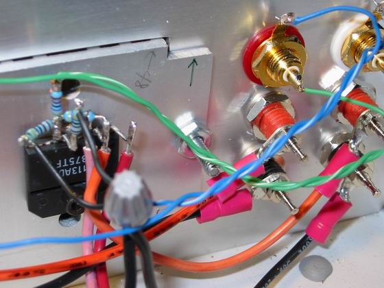

Guys, guys. NEVER build slavishly a "gurus" schematic (not even my ones - neither the original inverted gainclone nor the amended one - yes KYW = Thorsten).
The "new" schematic is UNITY GAIN. It means it has NO GAIN. If you want the usual 26db gain of the Gaincard and/or inverted gainclone you need to keep the NFB resistor 220k and the input resistor 10k.
The only change to the original "inverting gainclone" is the added 22k resistor on the inverting input and the removal of the RC combo on the non-inverting input and it's replacement by a 18k resistor.
If the full original "inverted gainclone" the input potentiomenter (if a linear one is used and the source has low impedance) will pretty much make sure the Amp remains stable. It cannot be removed without risking instability, if unconnected the amp is potentially instable. Adding the 22k resistor ensures unconditional stability even with input open.

Sorry? This seems not to make sense. The 18k resistor is on the positive input, there is no connection to "feedback".
To repeat, my suggested adjustments to the original "inverted gainclone" are as follows:
On the positive (non inverting) input remove the 220k and 0.1uF and replace it with a 18k Resistor (approximate - tune this resistor to minimise offset).
On the inverting input connect a 22k Resistor to ground.
The input coupling Cap MAY be removed, but I would likely leave it.
BTW, it matters VERY MUCH where the 18k and 22k are connected. Both need to be referenced to the Input ground, not the Amplifier starground IMHO. Failing to do may lead to increased offset or noise.
Sayonara

Kuei Yang Wang said:To repeat, my suggested adjustments to the original "inverted gainclone" are as follows:
Ok. I thought only the 22 k to ground was the only change. Now I've changed the 220 K to 22 K and offset is good again.
Removing it seems to double the offset. Now with them I have 8 mV on one channel and 5 on the other.
Mmm. Tough subject. As you might see*, I have a star at the amp section. At that point, both input ground and power supply ground meet, so I'm not quite sure how to interpret your saying.
Well, at least now I have enough gain to run AutoQ (since I have the digital add-on).
Thanks, and, in advance.
Niels.

Thanks, Kuei Yang Wang. I finally completed unity gain Gainclone. Without the input coupling cap, the offset voltage is only a few mVs. I think the input cap is not really necessary. Attached is a closeup of the chip. Now, it's up and playing. BTW, all the grounds are connected at a star ground, and it seems to be okay. Next project will be to find a simple tube preamp to match this amp. Any recommendation?
