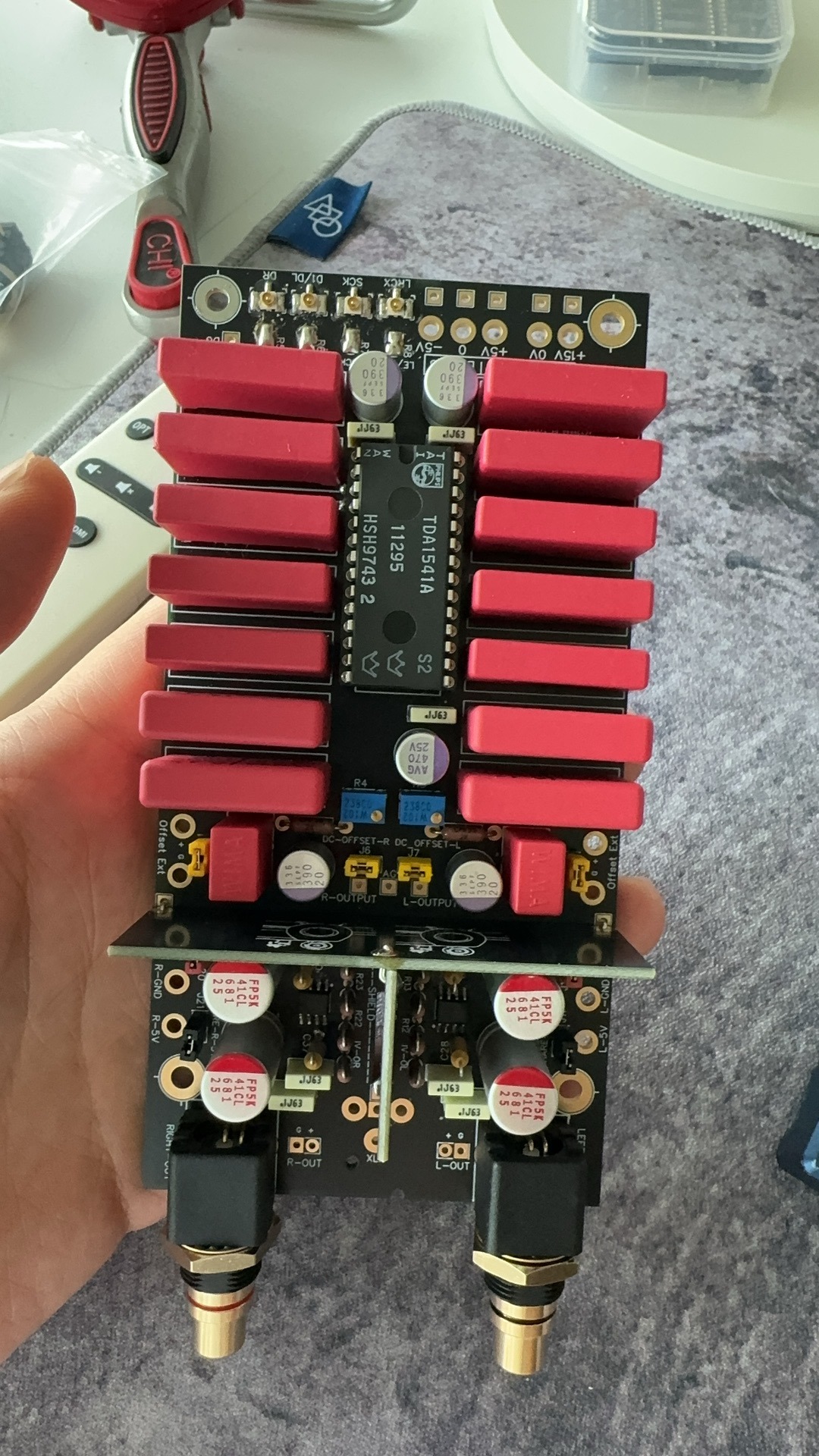

Yes promise to finish that Aya base on your recommendations. When I first tried the recommended Dem 100uf caps I didnt like the sound,
yes fat & slow but recalled piano sounded more real. Guess I was bored recently something told me to give it another go, well had spare
KZ 100uf 25v caps & gave it another go, wow much more transparency but sound was tight & in your face, than I remenbered that I kept
saying not to use 25v version of KZ so out it went & in with the 50v KZ now this is a tight squeeze but with the 0.1uf pps caps as bypass,
it really is another level. you should give it a try sometimes. After all I see that you modding the ouput into a tube stage so what's there not to
try just for experience sake & fun. lol

I promiss to retry Bro with your mods when you try sim mod at least and SC Cut crystal at 5 M hz, I just will have a pcb cause I do not like average grounding with that chip if i try again that no so good 50 Hz DEM... I even do not understand however why some still use ceramic 0.1 uf to bypass that mod and make resonant tank circuitry... Well, as far they measure just the level of THD they are happy !
About the tube I/V I have good guidance and a sota non microphonic NIB tube (I mean for a tube, lol ) or I would have not put any fingers in it... And still It is with transistors in it (so half or less than a tube sound, story to illustrate and if "tube sound" words has any sense). Passive elvating traffos have their own drawbacks and the best cause more expensive than a plane from here to Spore, ahahah ! (so not elevating traffo or OT traffo for me, as big H numbers chocks... (Well I did some interressant experience with ad1862 and a 4 layers pcb I draw but I do not propose you as I have to wait 8 years or more with you, lol ... and I still think tda1541A with good chip selection from it still has an edge, me still have only 2 ears yet !

He probably got the idea from me after seeing what I did with opt Iggy. lol
what's special with mine is very wide band width & can handle 60ma of dc
current. Somehow bigger is always better in opt regardless of current that
is coming out of the I/V stage.

It didn't changed things in mine with my 47K pre DC coupled. theorically the second opa has the same current output, no ? Just lower impedance as it is used base input and open loop) ? Btw wonder if it is still G+1 after the 120R output well...
In the AYA5 the diamond discrete output buffer should be more musical perhaps, though I wonder how is made internally the opa861... maybe diamond structure as well, duno...
You try frst, my tweak is older, from 5 years vis a vis of the one with the OT, ahaha ! After I try your ! Better we eat half the banana than I eat the entire banana and you its skin ! . Hurry up, populate your spare in order both to try the arrengement and mostly the sim mode with your Wave I/O before.
