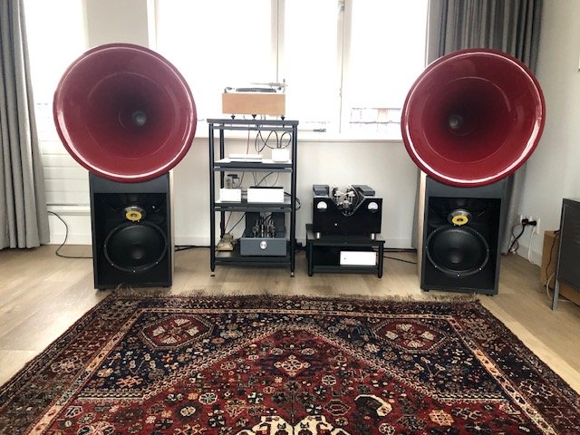

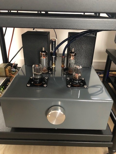

Power dissipation on G2? Within limits?🙂Just finished the build of a PL504 g2 as anode amp
Wow, you did a great job. Also with tube rectifier right? Beautiful colour of the housing. Could you discribe the sound as it comes to you?
