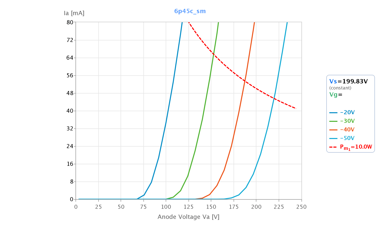

Last weekend, I put a Russian 6P45C on my curve tracer and got some curves with the tube in "screen mode" (g2 connected as anode, g3 tied to ground).
The curves are really impressive. Unfortunately my curve tracer (uTracer3+) cannot supply grid bias lower than -50V.
What was most impressive was the Ra and gm: ca. 550 Ω and 7 mA/V, respectively (I don't remember the exact figures, since I didn't write them down). Amplification factor is ca. 4.
Attached is an image of the traced curves. Quite linear as it seems.
