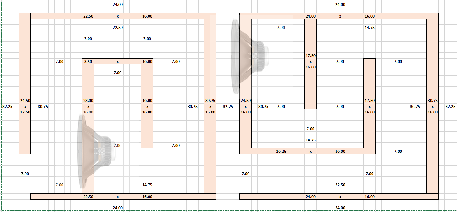

Hey but flatter is better....right?Brian is right. ODTL trumps a TH when you choose small and low.
Light = ODTL.
Dark = straight flare TH.
Both enclosures are the same dimensions L x W x H.

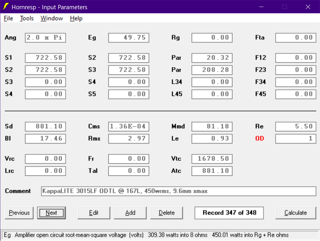

My ODTL is only 167 liters internally. 32.25" H x 17.5" W x 24" D externally.
I based the volume of the 2 enclosure off your 2ft3 cube double fold TH enclosure that equals 168 liters internally.

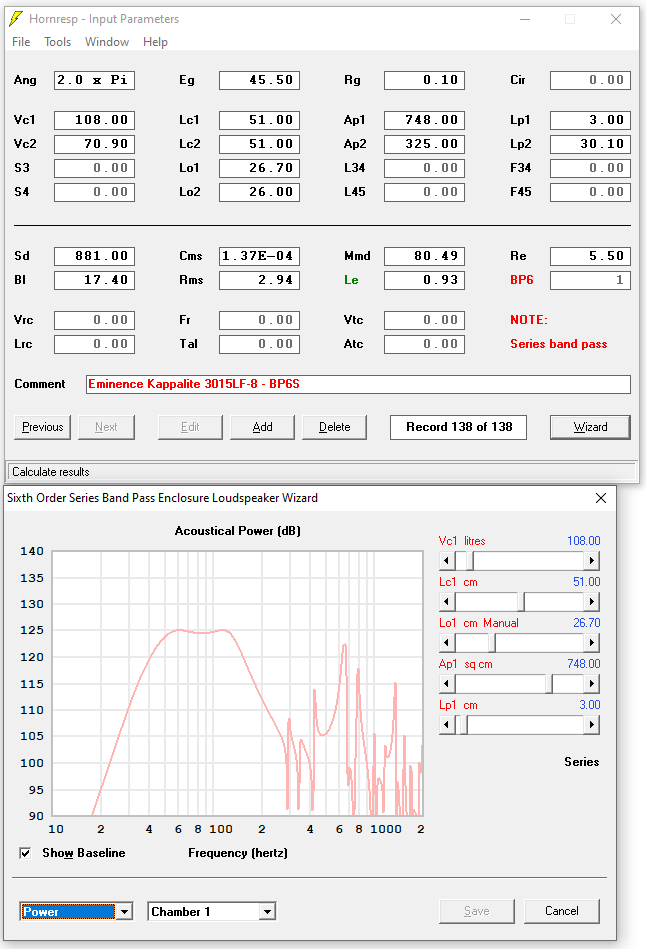

With some fiddling around, I was able to come up with this - a series-tuned 6th order BP design that has a decent response and an Ok size (net Vb is around that of an SS15, and as it requires less panels, it might just be possible to build it with one sheet of ply.
Caveats are that, unlike the case with THs and TLs, I haven't had the opportunity to do a POC based on Hornresp's bandpass sims, so I can't say how close the actual response would be to what the sim suggests. The other catch is how to convert this sim into an actual box. Note that it calls for offset driver arrangement (i.e. none of the vents should be pointing directly at the driver), and the offsets will likely have to be adjusted once you try to "box" this sim.

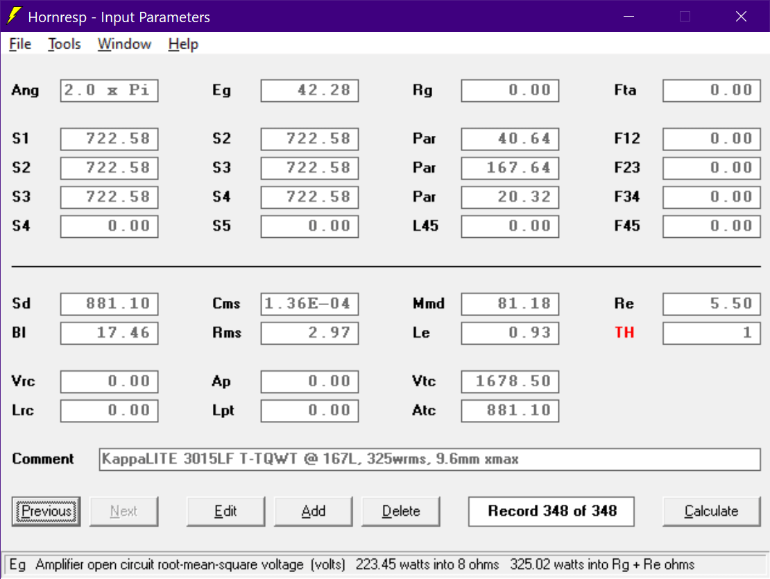

That's exactly what I did. I had to "keep it real" for a fair comparison. I designed the 2 enclosures within the 9.6mm xmax and 450 wrms for the 3015's maximum limits.
TH = 325 watts.
ODTL = 450 watts.

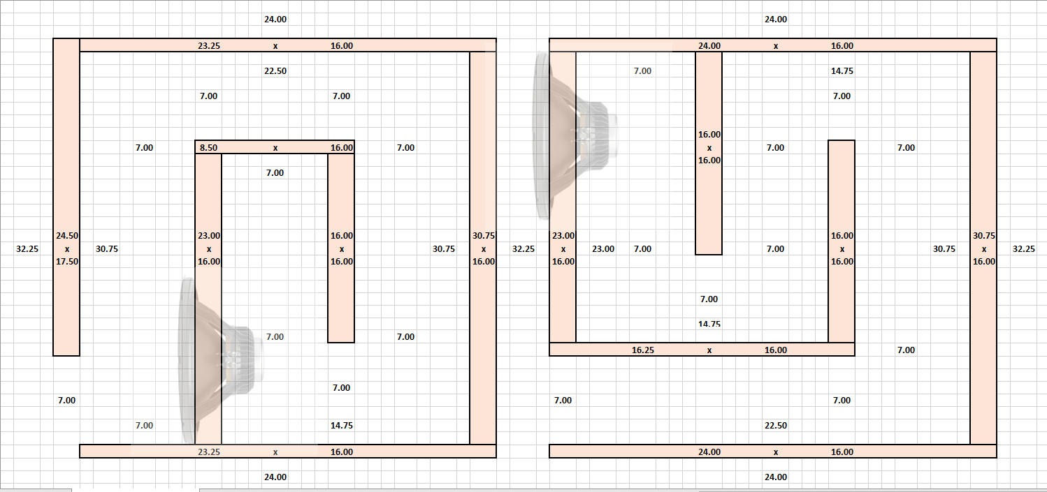

D@mn it B, you caught another mistake. With both enclosures, the speaker plate needs to be doubled. The 3015 mounting depth it 7.25".

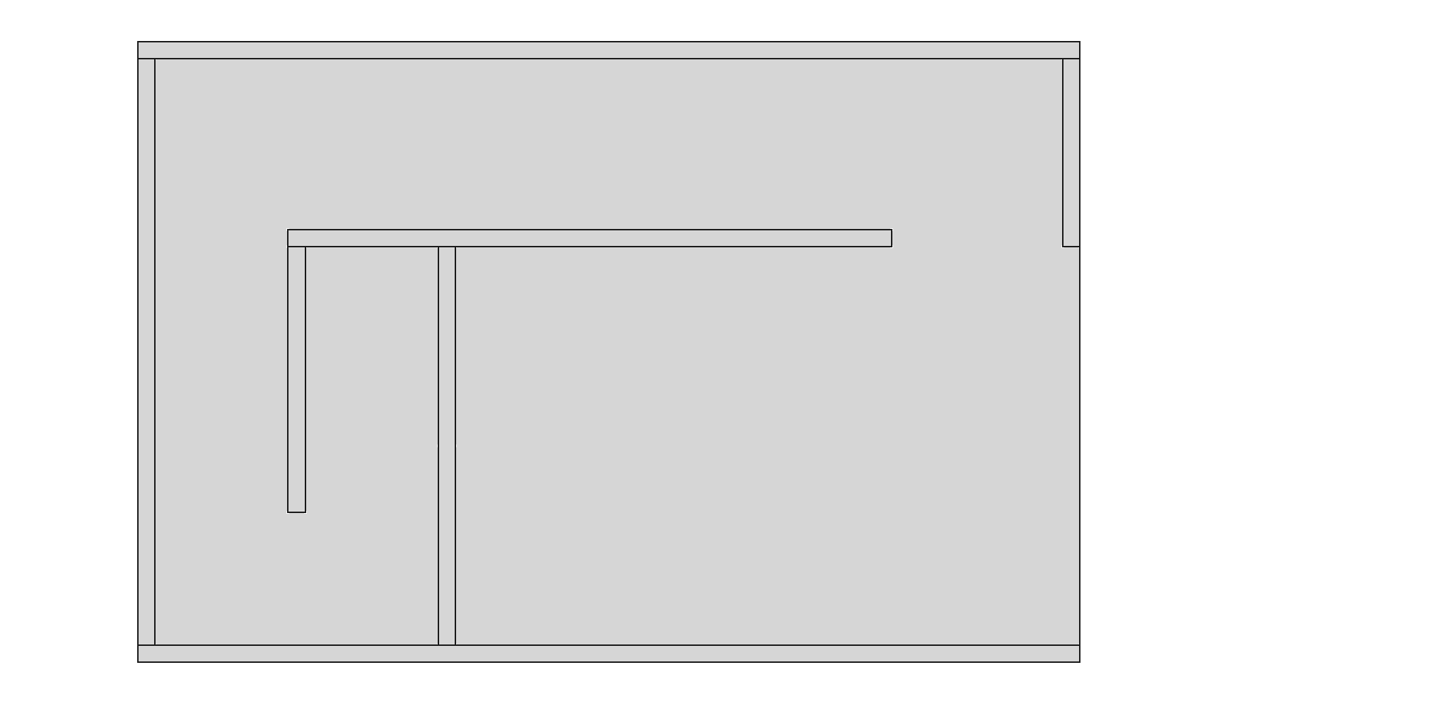

722.58cm2 = 7" x 16".
The new external depth is 24.75".
Of course, you could do 7.25" x 15.75" from throat to mouth or 7.5" x 15.5" and still equal 722.58cm2, but the enclosure depth increases. The 3015 outer diameter is 15.39". I prefer to go up to the next inch (12" to 13", 15" to 16", etc) when designing BP boxes for easier driver installation and removal.

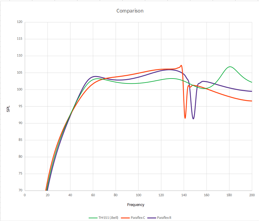

Take a look at this comparison:
TH-SS1 (Jbell) vs Paraflex C vs Paraflex R
The Paraflex R is even easier to build compared to the C type and you can achieve better results because you can tune the "ducts" with different sizes.
For TH-SS and Paraflex C you can use Brian boxplan in excell or FreeCAD model, for the Paraflex R only FreeCAD model is available.
Box Volumes:
TH-SS1 (Jbell) = 260L
Paraflex C = 260L
Paraflex R = 295 L
The diaphragm displacement are basically equal for all three simulations at the same voltage.

With the 3015LF?Take a look at this comparison:
Box Volumes:
Paraflex C = 260L
Paraflex R = 295 L
