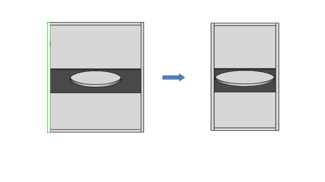

With wall that thin and with a high-ish xmax driver you need to make the box more solid, you also said that top-end is worthless.The higher the subwoofer can go, the easier it is to blend it with the main speakers.
... With a TH, the internal panels help to stiffen the box.

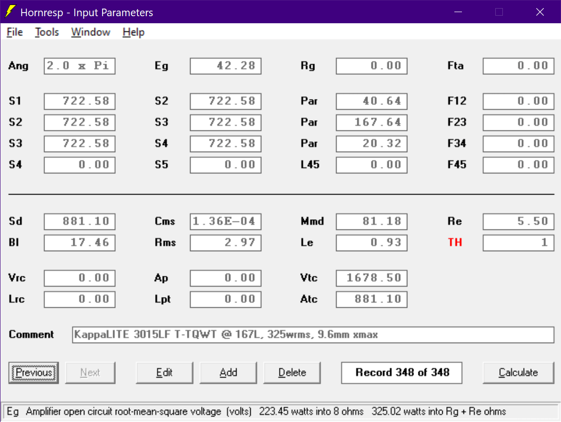

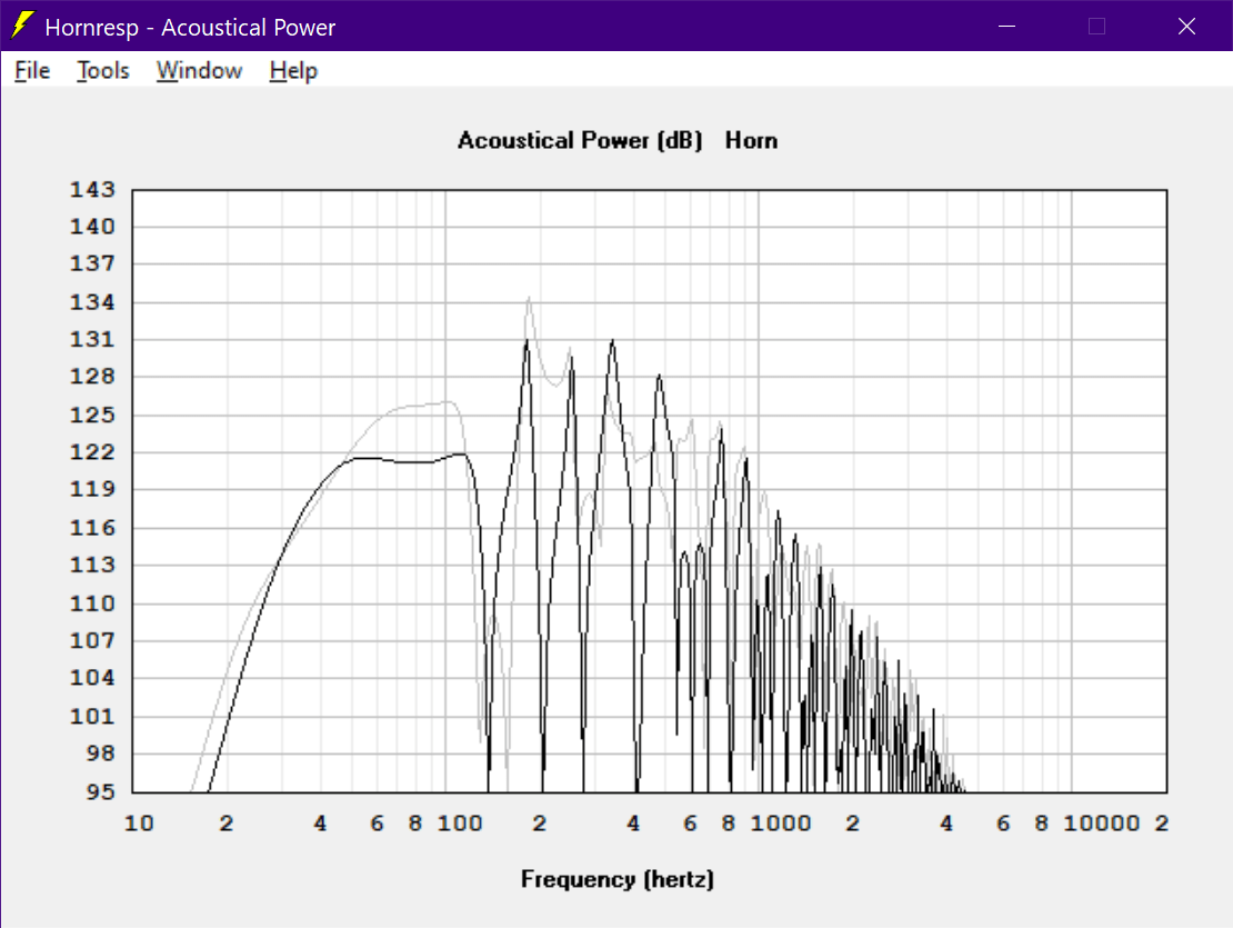

Hello Maxolini,
Taking other projects as inspiration and lessons learned is very important, but just copy and paste and build a plan as it is, I don't think is the best approach, unless you like the results and are going to use the same driver.
So you already defined the driver: kapalite 3015LF 8 The next step is to defined box design to use.
You can achieve a good result with many different design options, but in order to avoid them to be overwhelming I will mainlly stick with Tapped Horn because looks like you prefer this type, here are my suggestions.
Once you defined that you don't need frequencies above 100Hz, it make a lot of easier and basically almost everything will work. This is your Upper limit.
kapalite 3015LF 8ohm version has the Frequency Resonance of 44Hz, so this is your lower limit.
If you do not have much experience building loudspeaker I'd suggest starting from the models that are more friendly to build with less panels and preferable orthogonal (90deg) panels.
Each tapped Horn Project has a different design freedom that you can use to optimize the frequency response. They also have different aspect ratios.

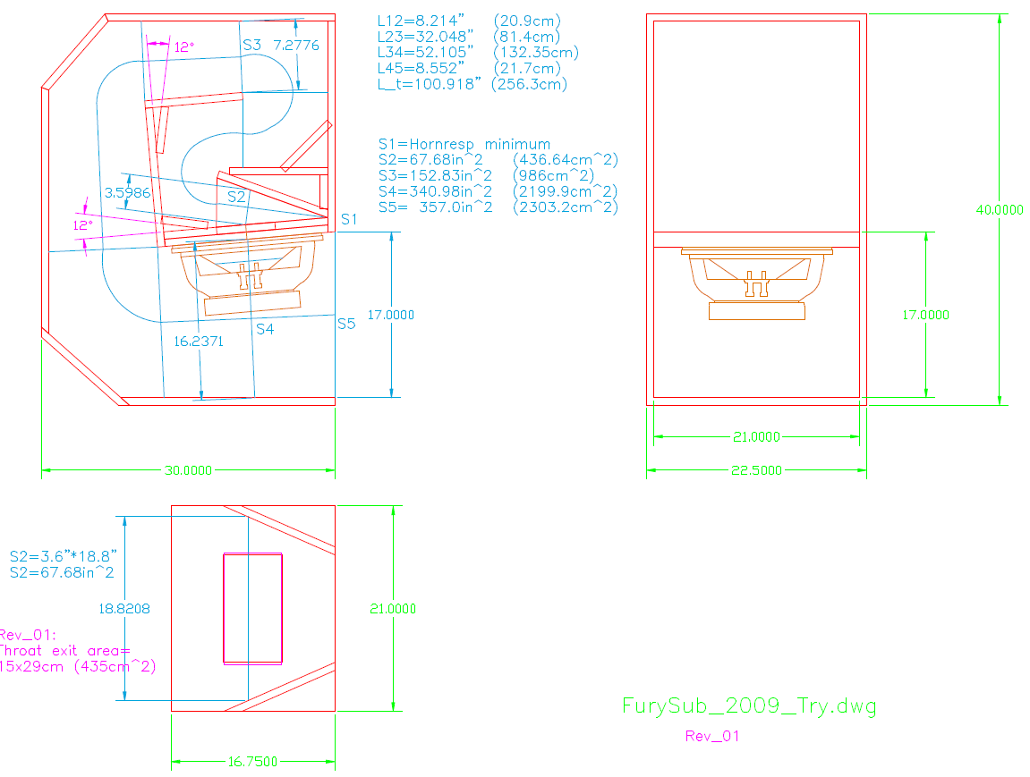

So I want to repeat the recipe.
Btw anyone know if screamerusa still hang around? His website is not up, i was hoping to get the plans of his furysub. That he build for a club and he commented thoroughly on the collaborative tapped horn thread.
The tops he made for them was some otop variation.
Kind of what Jbell done for the stadium horn.

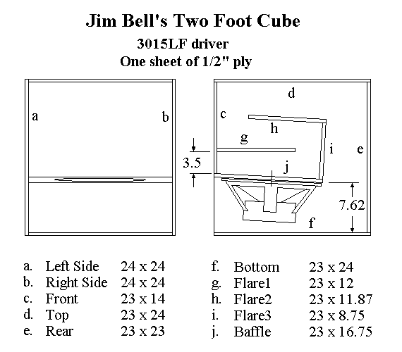

that was a very! Informative list Mr. Sansui.
Highly appreciated.
I plan to use 1/2" ply as the 2' cube
So I will need some carefully bracing but just the minimum for weight constraints.
As I read the whole thread were the cube originated Jim do not used any bracing but adviced us to add some if we will run hard the cabinets to save a couple db from being lost due to flexing.

If your intention is to use Screamers furysub, Apache H15 And jbell 2' cube as they were defined from their designers as they are without modification, other guys already helped you.

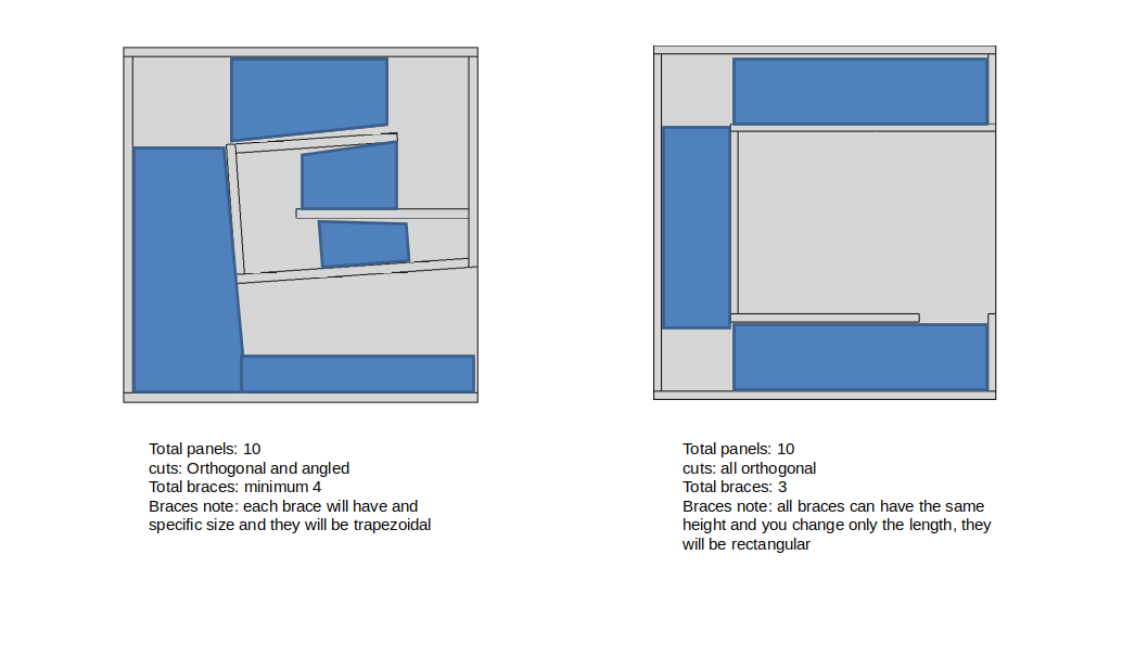

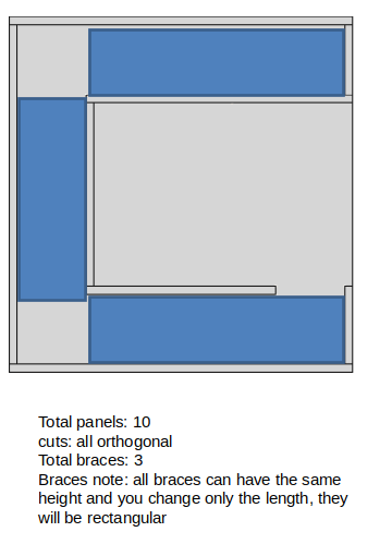

The Apache 15, from the image, looks like a single-expansion TH, and I have some concerns about the first section of the fold and how well that can translate to a Hornresp sim. The SS type fold allows for dual-expansion and provides built-in bracing for the top panel as well, in a cabinet with similar dimensions. If I had to choose between the two folds, I'd go with the SS fold.
JBL's use of 1/2" ply for the 2' cube likely means that box losses (due to panel flex) are going to be higher than expected compared to if the cabinet was more rigid. This would tend to smooth out all the peaks in the response curve, including the peak around 50 Hz predicted by the Hornresp sim.
I think the JBell 2' cube is more like the TH-MTH1 rather than the TH-CUBO, BTW. The TH-CUBO doesn't have the "g" panel in the diagram. Like the Apache 15, it is also a single-expansion TH.
BTW, Based on my experience with POC#2, boxes in that type of square form factor can end up being a pain in the butt to move around. Boxes with a rectangular form factor are easier - just put corner wheels at the bottom and a handle on top, and then you can just tip them and wheel them into place. Also, with a 2' width, you probably can't fit two side-by-side in a car unless the trunk is at least 48" wide ...
Thinking in terms of structural needs, the driver you choose offer only 450W and so you don't need the same reinforcements as 1500W one but, consider that you are a not working for an engineering company it means you probably are not going to use software FEM software to optimize the box in terms of structure so as DIY you need to choose the safe path. Using a 1/2" ply is a risky you need to evaluate because you are spending a lot of money and time.
Considering that, I would reduce the box width as much as possible, the minimum needed to assembly the driver, this will help to make panels stiffer. See attached image. Doing that you will change the aspect ratio of the design. If you fix the width, the design options will start to show more differences making it easier to choose the best one for you.
You need to find something to support you to pick the right design, it can't be random, puts more ration behind it. For instance Brian is point about where you will transport the box, think about more constrains to consider. Each design offer a different grade of freedom, like, compression ratio, how many expansions, , how many folding, how many panels, driver position, and so one. They will result in different performances. So if you define more constrain, slowlly we can eliminate some options and find the best candidate. Once you pick one, lets modify it to you needs.

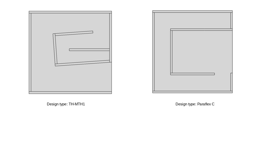

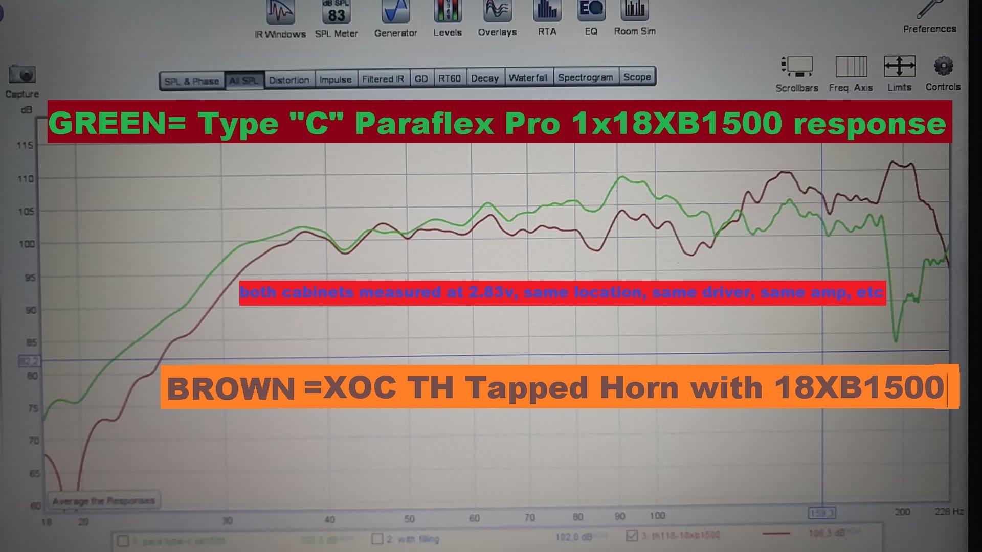

Take a look at the practical comparison attached as an example and check the differences.
Tapped Horn MTH1 vs Praflex C
Did you already compared the performance you can achieve with both designs? SPL, Diaphragm displacement, Group delay, etc

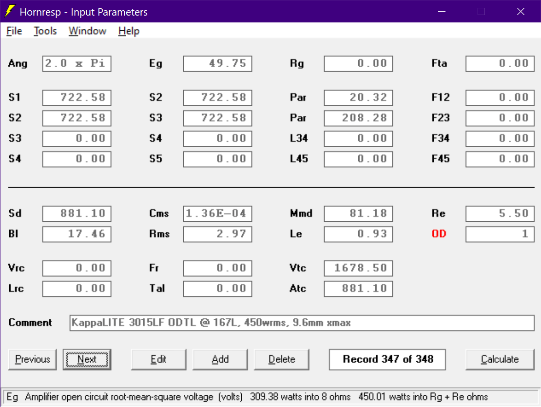

IMO, the ODTL, the TH and the Paraflex alignments are all basically attempts to deal with the impact of harmonic resonances on the combined output of the system.
With the ODTL, the first (and most troublesome) resonance is nulled out by locating the driver partway down the path. There is however a small price to pay in terms of efficiency with this design (compared to an end-loaded TL).
With a TH and the Paraflex (when both are designed properly), the intent is to "fill in" the dip in the response caused by this resonance, without giving up anything in terms of efficiency. However the phase behaviour in this "summing area" in the frequency response is not very smooth, which does make the idea bit suspect.
In terms of peak output, the TH and Paraflex will likely beat an ODTL (using the same driver). Large "vent" = less compression at peak volumes. But the boxes are larger, sometimes much larger.
These days, my preference is for ODTL alignments. The box is smaller and easier to move, and amplification is cheap, and no special filtering is needed to get the best results from them. YMMV 🙂
Hey Brian,IMO, the ODTL, the TH and the Paraflex alignments are all basically attempts to deal with the impact of harmonic resonances on the combined output of the system.

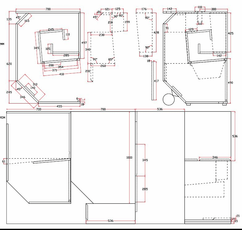

i am having a hard time pulling the Furysub from the thread, looks like there was an updated one on screamerusa site but it is down now
i tought there was a repository place where the old sites was mirrored i dont know if it can work on screamers
on the thread him says that because the design have a narrower mouth there was compression and that protected the driver from damage,
so can you DAMP the driver from too much stress with air compression i mean acoustics?
what caught my eye on the furybox is that the ditortion was bare minimum according to him, there was people from big sound companies

FOUND IT !!!
at least on this forum
the furysub is in screamerusa's thread: http://www.diyaudio.com/forums/subwoofers/131852-live-sound-specific-tapped-horn-thread.html, there is a lot of interesting stuff in that thread, here are a few items:
- Page 52/53/54/55 have all kinds of interesting comments on the actual construction by screamerusa,
- initial attempt at drawing, Post #530,
- interesting comment by jbell, Post #532,
- updated drawing, Post #535,
- screamerusa's comments on box and drawing, Post #537,
- GM posted interesting observations by Tom Danley, Post #544,
- attempt at AkAbak, Post #563,
- Posts #579/580 Hornresp SPL plots,
- Hornresp Input screens, and references, Post #583,
- altered version by runrod1948 in Posts #715/717,
ok, the cube is discarded
Jbell comment for the SS15
post#59
https://www.diyaudio.com/community/threads/single-sheet-th-challenge.170771/page-3
so its down to the Furysub and SS15

and maybe paraflex C, its worth to do the SPL graph to see if we can do something good with the 3015LF
sooo easy to cut the wood on the Paraflex C layout and bracing
post#59

Screamerusa comments
One side of each piece is cut at about a 12 degree angle, yes.
15x29cm is the original opening, correct.
I will do some rechecking in a couple of days as this is my bust part of the week. The drawing looks spot on.
Removing the other reflectors all yielded unacceptable dips and losses.
The one "missing" reflector was my insane atempt to "cut" the path length and create a higher spl "Bounce" affecting the 100hz area as I was not getting ANY gain over the direct radiator.
Please remember that the goal was not to build the best tapped horn live sub (That's Tom's job), but to match or exceed a double driver cabinet to eliminate the amount of amps and wall power required to achieve high quality high spl with a 2.6ohm minimum load (3 drivers).. Smooth response at about 102-103 db from 38-125hz would be a realistic goal, for a single"
A TH and ODTL are the same physical enclosure.
Both enclosures can be single, double, etc. folds.
TH = internal driver mounting.
ODTL = external driver mounting.
TH = BP6S.
ODTL = BR.
TH = BP6S.
ODTL = BR.
