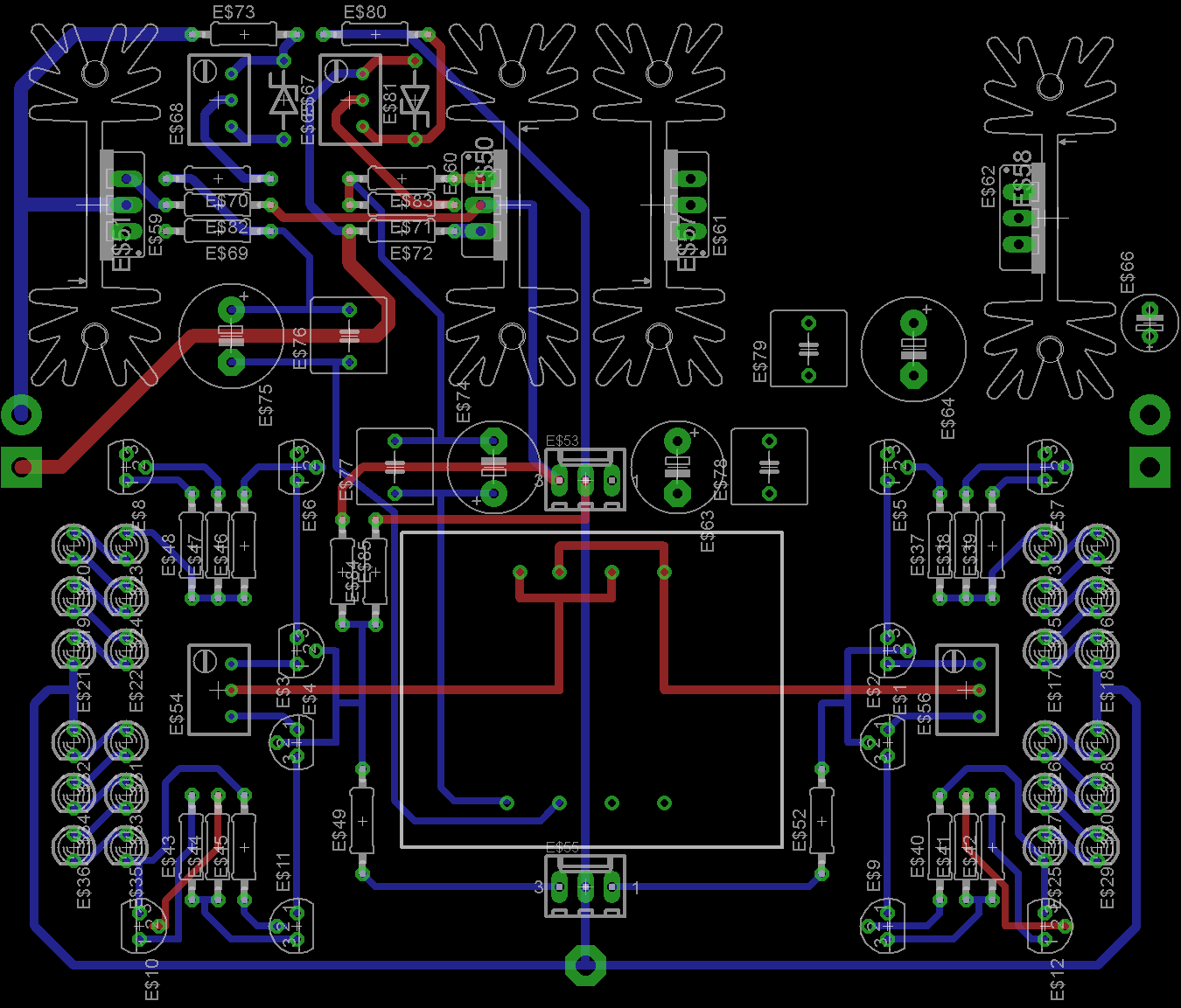

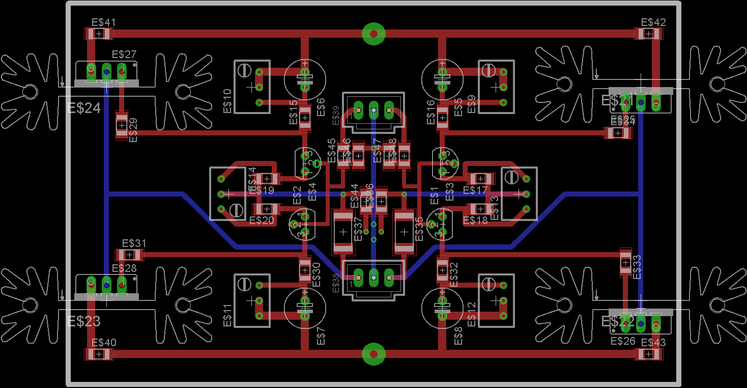

Couple of options
Currently, a set of SS outputs for this amp would run you close to $400. I would pay it without hesitation and it would be at the top of my list if starting new system. I am interested to see if the 5 fillar winding version from ZM will best it. Unfortunately the delivary time is mid June, so no new excitement for a while.

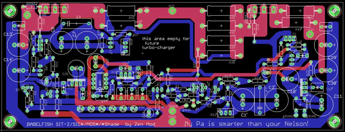

SE iteration enclosed - sort of universal project/pcb ; still need to be confirmed in vivo , but I have no doubts
you can Shade output but ..... few things :
- same as for Ultralinear connection of toobz , it's important to note that every part is having own sweet spot ; say that for IRFP240 1K for gate resistor and 10K from drain to gate is proven combo ; for every other part one need to find proper combination
-to have Shade and place a part in most linear part of load lines , think about at least 50% higher PSU voltages
