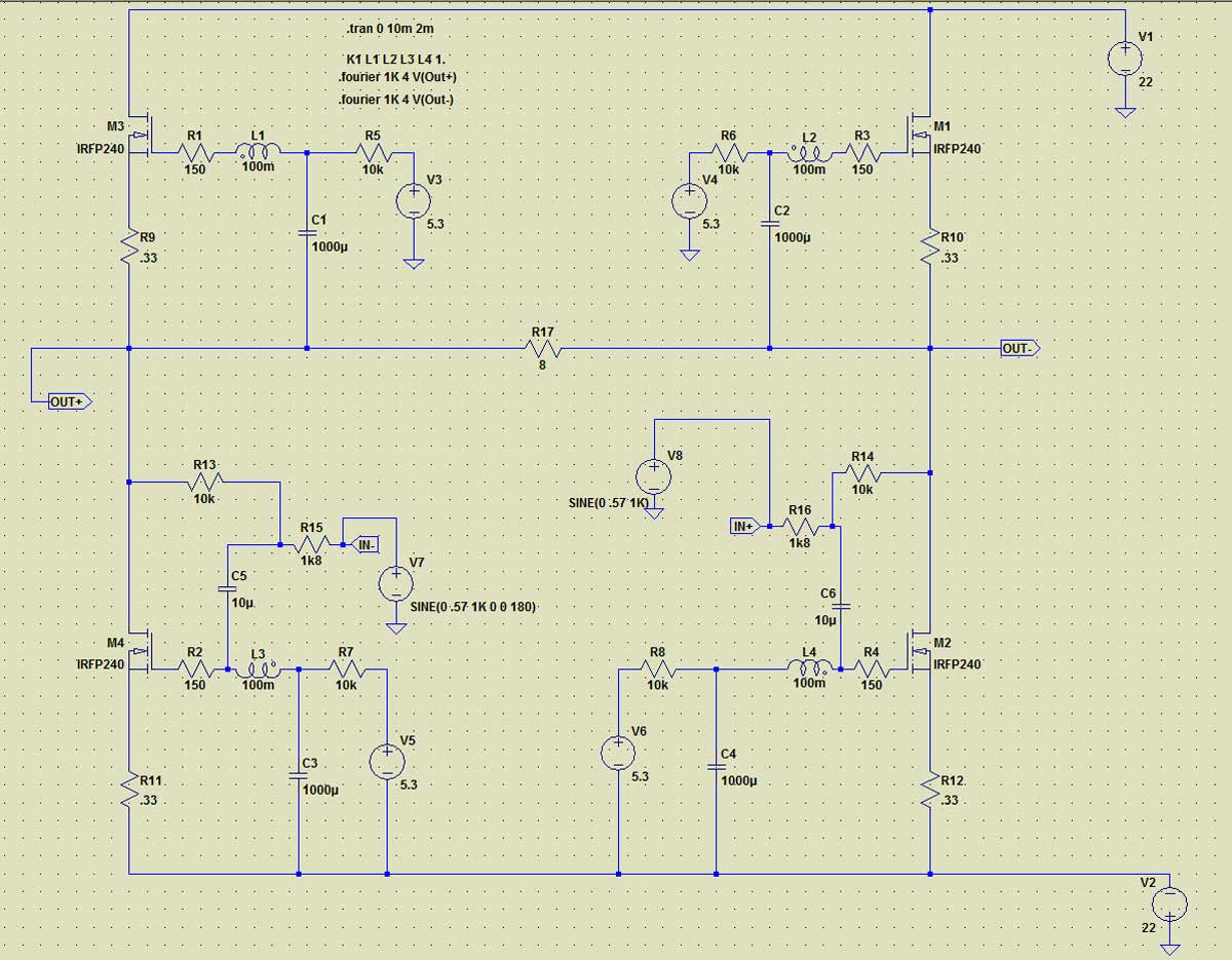

just as reminder - here it is
please - repost it in F6 thread , I think I made mistake posting previous one , having slipped position of one 1K8 resistor ( just in capture , not in sim file )

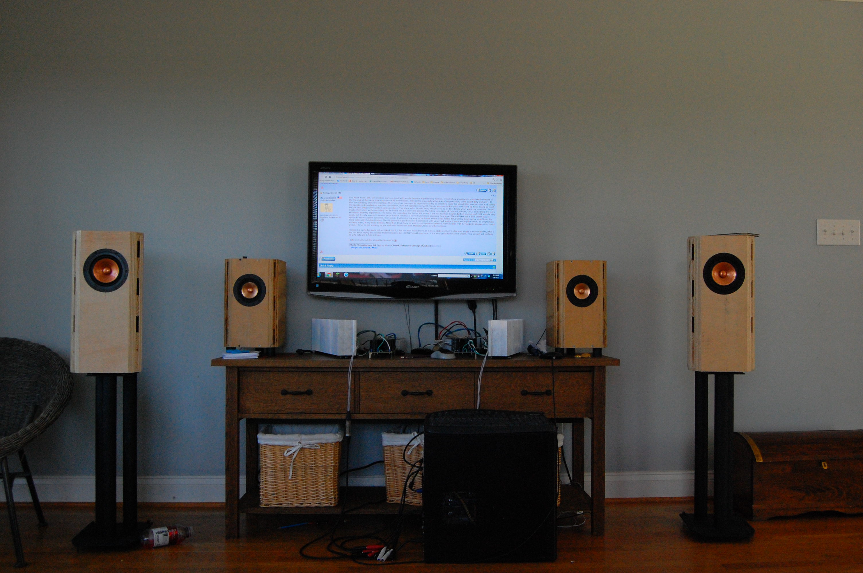

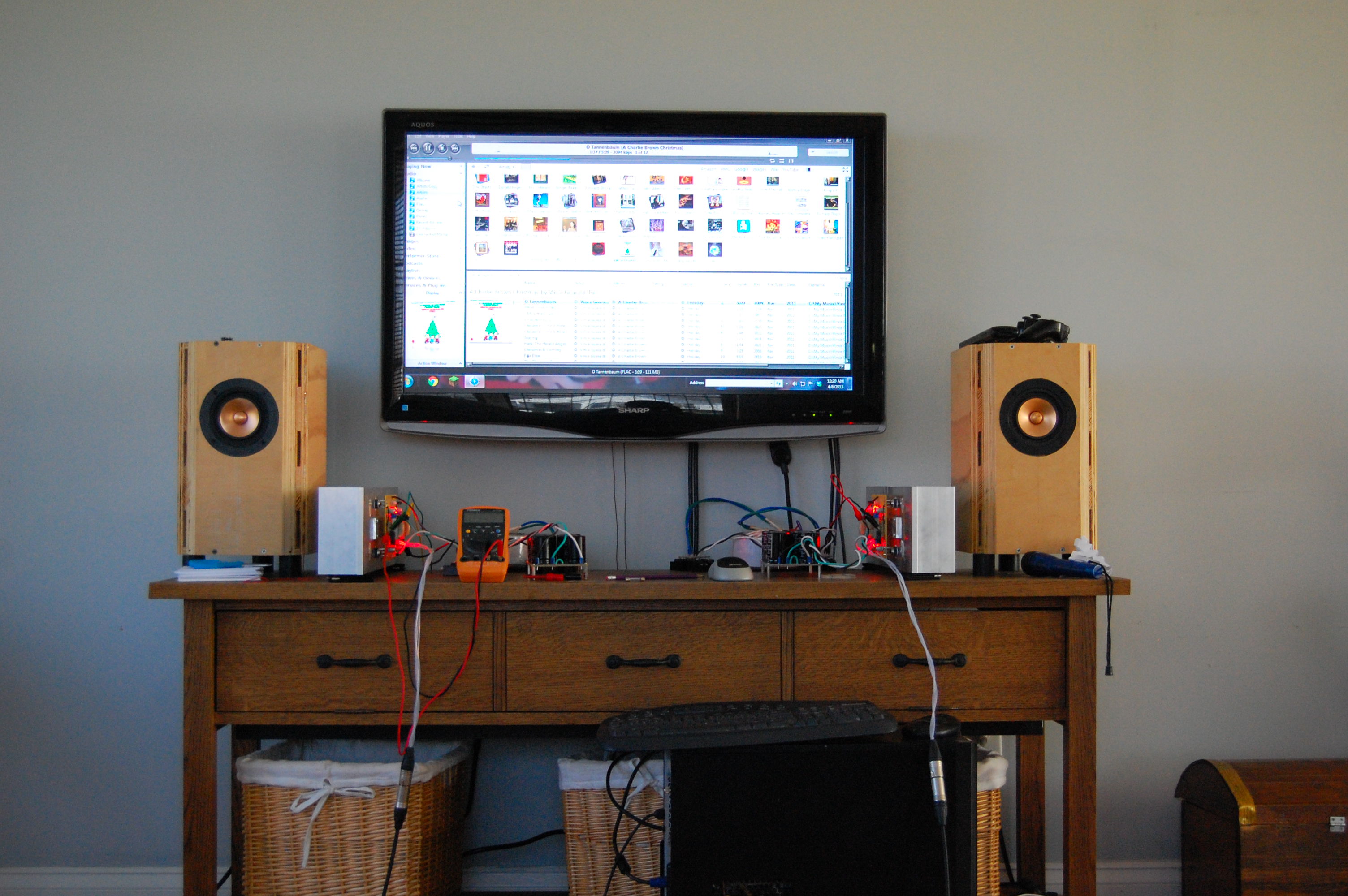

Here is Phase two. If it continues to improve, I will get edgy. IT makes me think that with each improvement in chain, I will be rewarded. That is when you are on good track. THis is kinds sound I was expecting from future BA3B build. Certain freedom to it.
Speakers are Alpair 10.2, with Dave's/BudP's eNabling pattern. THey are in Dave's custom sweep back dMaKen.

I am using a version that has cascoded FE with LED Vref , fed by sK170 cs. THere is no degeneration on FE to speak of(10R pot). The output only has .1R degeneration resistor up top, otherwise, nothing. I am using 470uF polymer caps with no bypass at the moment. I have MKc coming to bypass them. I also do not have bypass cap on LEd string of FE. If anyone is interested, I can post exact wooking schematic.
