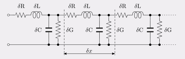

I'm wondering what the minimum gauge of speaker wire I could use from a pair of 100 watt SAE 2200 power amps to a pair of 505 mini panel electrostatics, in kit form from Australia.
Against all my previous expectations, the supplied leads from the transformers appear to be 35 gauge, or possibly even smaller.
Any reason to be running my usual 14 gauge speaker wire from the amp to the transformers' inputs?
Is virtually all speaker wire thicker than 35 gauge just a marketing ploy to waste copper?
Or is this because it's pushing high voltage, low amperage into what I'm figuring is about a 20 ohm load?
If these little wires are harming the signal, I can't hear it; these are the first drivers I've ever connected, and gotten quite wonderful sound from, with zero tweaking.

Let's see if I can explain this in non-technical terms...
The transformer does what its name suggests. It transforms the low voltage, high current signal from your amplifier to the high voltage, low current signal needed by electrostatic speakers. High currents need thick wires, low currents need thin wires. So you have thick wires from the amp to the transformer and thin wires from the transformer to the speakers.

I might clarify this just a tad..High currents do indeed need larger wires. This is because there are lots of electrons to move (current is measured, basically, in electrons per second past a given point..a "coulomb" is the measure of charge. It represents 6.24 x 10^18, or 6.24 quintillion electrons. One Ampere of current (i Amp) is defined as one Coulomb per second)...
Since no conductor is perfect, they all exhibit some resistance. Larger wires have larger cross-section and thus are like many parallel resistors.. more parallel resistors means lower overall resistance. When current flows through a resistor, it generates power, which must be dissipated as heat. The relationship is E=(I^2)R, where E is watts, I is the current and R is the overall resistance of the wire. You can see that the power dissipation rises and the SQUARE of the current. Push to much current through a small high resistance wire, and it will heat up. Push enough current through it, and it will melt.
The second statement in the quote, however is slightly misleading. Lower current signals do not NEED smaller wires. Lower current signals can be sent over smaller wires without melting them.
The reason for the small wires in the electrostatic speaker is similar to the smallish wires connecting a speaker voice coil to the terminal lugs on the speaker. Notice that you may be using big fat #14 wires (or fatter #10's or something) between the amplifier and the speaker, but right at the speaker the wires going to the voice coil are rather small.. In both cases we have a tradeoff. Big wires are physically heavy, and they will add a mechanical load to the speaker transducer (either the ES transducer, or the speaker voice coil and its attached cone). For the same reason the efficiency of a speaker drops off if you put your hand on the cone, you do not want heavy wires adding to the moving mass of the speaker. The wires are chosen to be a large as necessary to handle the expected current, but no larger. Because they are physically short, the effect of heat and inductance (see below) is relatively low.
A wire is not quite like a resistor or an inductor you might use on a circuit board. A wire is distributed, whereas a resistor is a small "lumped element" device. In reality a wire can be modeled as a long string of very small resistors inductors and capacitors. The image below shows this. For a short segment of wire (denoted "dx" in the figure) the wire is actually a very small resistor, in series with a very small inductor. For a wire close to a ground plane, there is also a large shunt resistance (which would be, for example the resistance of the insulation - probably 10 megohms per millimeter), and a small shunt capacitance. Obviously a wire that is closer to a ground plane will have a higher capacitance per mm than a wire out in free space on its own. A coaxial cable has a very specific combination of inductance and capacitance per unit length, and this is what determines the "characteristic impedance of a coax cable (you have probably seen "50 ohm", or "75 ohm" cables. This is what those numbers refer to). A twisted pair will have some small capacitance (and some high resistance) between the two twisted wires.. thus also forming a "transmission line" somewhat like a coaxial cable.
Remember that these "parasitic" inductances, resistances and capacitances are distributed all along the wire, so we measure them in terms of micro-ohms per foot (or mm), and micro-henries per foot, pico-farads per foot, etc. Obviously, if a small wire has higher resistance and inductance per foot, then making it shorter will reduce the total value of that resistance and inductance (fewer feet), and for a given length of wire, making it fatter will reduce the resistance and inductance (more parallel paths).
If you were to power the entire system from amplifier to speaker with #32 wire, it would sound awful. First, because those small wires are very inductive, so the high end would get killed, and the wire and speaker would present a funky load to the amplifier. More importantly, the resistance of those wires, over a long distance would cause heating at any reasonable current level (listening level), and at high levels they would melt. Similarly, were you to somehow attach #14 wires to the electrostatic transducer, it would weigh it down and cause many different acoustic issues.
An explanation, and a calculator for twisted pairs is available here: http://www.allaboutcircuits.com/tools/twisted-pair-impedance-calculator/
