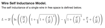

Inductance mainly comes from wire spacing, not wire size. In any case, for most audio purposes inductance is swamped by resistance.
The self inductance of a wire is based on the ratio of the diameter of the wire and the length of the wire. Here is the formula.
A 1 meter length of #32 wire has a self inductance of about 1.8 uH. A 1 meter length of #10 wire has a self inductance of 1.3 uH.
For parallel wires the inductance predominantly depends on the spacing of the wires. Although I am not certain if this is relevant here. It depends on the wire arrangement. Once the spacing is more than a few wire diameters it will look pretty much like a single wire.
In general, this inductance is not going to play a large role since it is presumably much lower than the inductance of the speaker.
The real issue for audio is that a speaker has an impedance which varies with frequency, in a quite lumpy way, so any significant resistance in the feed directly causes a lumy frequency response. This will be noticeable long before you get anywhere near melting wires.
For copper wire*:
A #32 wire has a resistance of 0.54 ohms per meter. This wire can support a maximum current of 0.53 Amps.
A #10 wire has a resistance of .003 ohms per meter. The maximum current for this wire is 55 Amps.
At 8 Ohms, .5 Amps corresponds to 2 watts of audio power; 55 amps corresponds to 24kW of power!
So, while I do not disagree that any system would sound terrible with, say 2 meter #32 speaker wires (which would add 2 ohms of resistance-round trip), I suspect that at any significant listening level, the problem would also not last very long, because the wires would fuse.

That may be so, but it is still true that most inductance is not self-inductance but loop inductance.cogeniac said:The self inductance of a wire is based on the ratio of the diameter of the wire and the length of the wire.
It is relevant, in the sense that this inductance will probably dominate over the self-inductance. It is irrelevant in the sense that resistance usually dominates at audio frequency.For parallel wires the inductance predominantly depends on the spacing of the wires. Although I am not certain if this is relevant here.
Not sure what you mean here. As the loop gets bigger the inductance gets bigger.Once the spacing is more than a few wire diameters it will look pretty much like a single wire.
0.5 amps into 8 ohms is 2W. This is probably well above normal listening level unless very inefficient speakers are used.So, while I do not disagree that any system would sound terrible with, say 2 meter #32 speaker wires (which would add 2 ohms of resistance-round trip), I suspect that at any significant listening level, the problem would also not last very long, because the wires would fuse.
