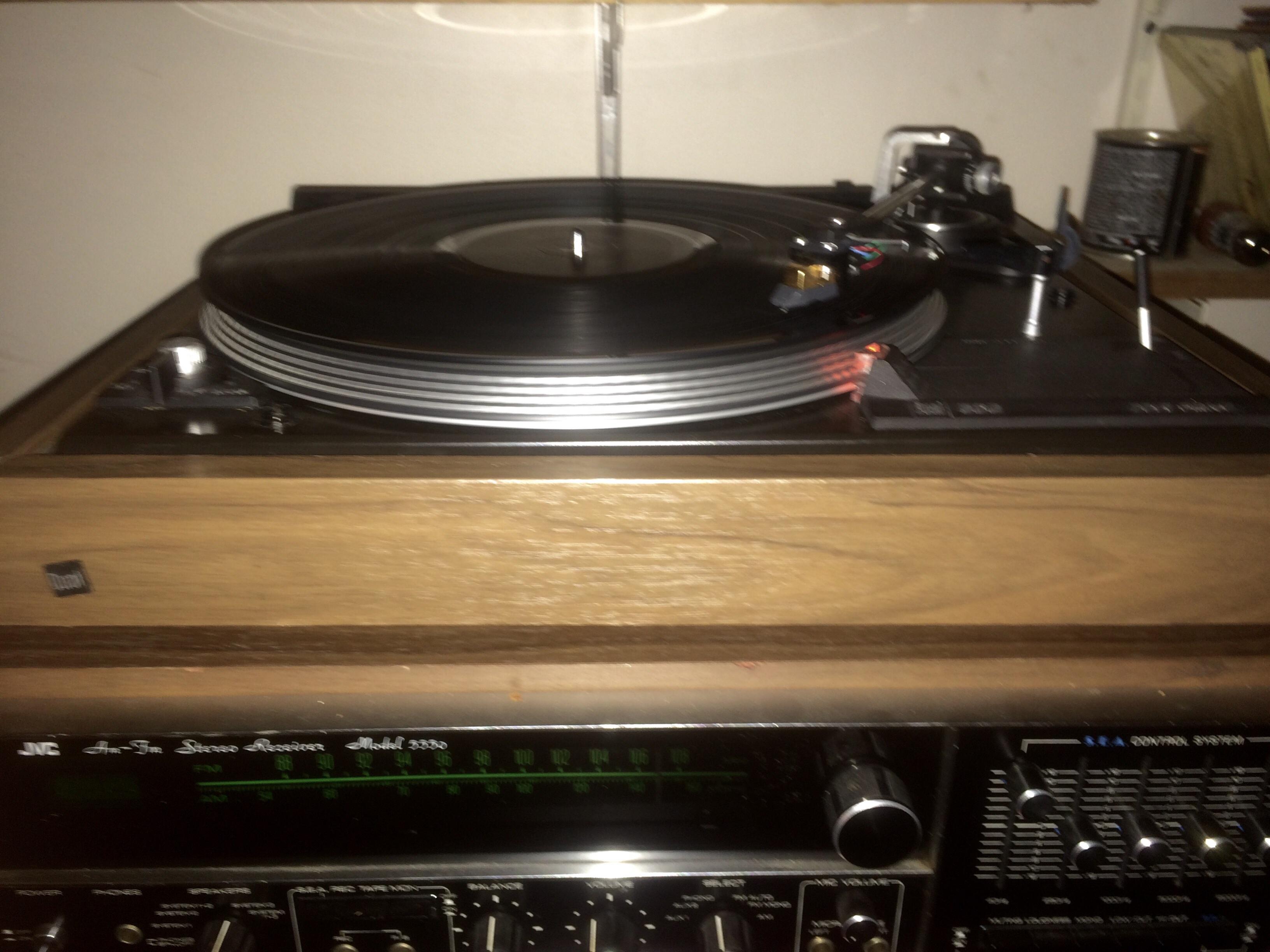

This morning, I set out to fix a loudly humming left channel on an old Dual 506 turntable, with no experience in repairing these, of course. What was inside was shocking to audiophile sensibilities- super skinny patch cord. Super skinny ground wire.
Even worse,the ground wire, power cord, and interconnect leads were twisted together, and zap strapped tightly together, presumably from the factory.
I had an old two metre pair of Transparent Audio the Link gathering a few years worth of dust, so I cut off one end, and prepared it for soldering .
To my surprise, a cable company was using unanealed copper strands, and pathetically sparse copper shield stranding over a proper looking foil shield .
Isn't more shielding better?
And I thought anealed copper was a better conductor.
Ditto for pure copper.
Even after scraping the strands with a knife until shiny, I needed more flux than my 4% silver solder had to get a good coating of solder on this "high(ish) end" wire.
Finished attaching the new old RCA leads, gave it a test spin.
Got music now, but there was still a slight hum.
I opened things up, got rid of the old ground wire, and subbed some stranded core, double shielded RG 59 for a ground wire.
Maybe I should have used it for the interconnects, too, but have no RCA plugs at hand.
My point is , things aren't always what we are led to believe:
A specialist cable maker uses cheap, obviously impure copper,
And fine German engineering has some Gerry-built in it.
The old player is fine now, and sounds better than a 2 year old Dual, and a 1 year old Pro-Ject turntable I was happy to sell.
Just not sure how anyone thought it was a good idea to wrap unshielded patchcords around a power cord.
I also think a homebuilt hardwood chassis for the motor and platter assembly, would be a big improvement over the thin plastic one, but I can understand them hitting a price point there.
