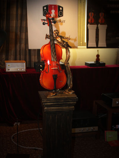

Yes, but this condition can be met by creating the illusion of a musical event, but not necessarily the one that was recorded.
Something like this, that fed with a suitable recording (of a violin probably!) can possibly create a plausible holographic 'sound field' in your living room by resonating just like a violin in your living room:
Violinspeaker - Product
Do we know that many audiophiles are not really attempting something half way similar with their open baffles and on? Trying to take a dry recording and boost their living room's ambience to the extent that it sounds like a performance in front of them. A neat trick, but really only good for girl-and-guitar type music, perhaps.
A player piano or fairground organ might also be set up to play back MIDI files for a similar lifelike illusion of a musical event!
...and back to snake-oil! Do I also need a cello speaker, a flute-speaker, and a kettle-drum speaker? Do I need to tune my speakers before every "performance"?

Well, should be no need for anyone to go into silliness to make sound, well, sound good ...Violinspeaker - Product
