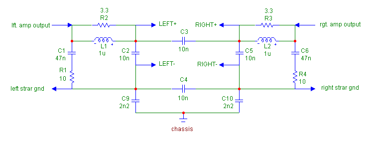

Here another Zobel network, from NAD.
Notice the 'stupid' caps (not my words!) across the speaker terminals.
Also notice C3 between the hot left and right terminal. Looks really funny. Probably done because the two channels can also be bridged, I guess.
Edmond.
