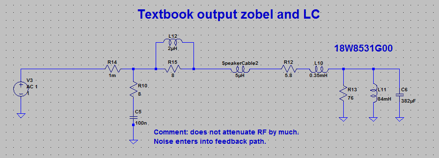

Let me do a summary of various Output Stage circuits discussed so far.
The standard text book amplifier output is a Zobel (e.g. 8R + 100nF) from Vout to ground and a LR (e.g. 2uH || 8R) from Vout to speaker terminals. The main purpose of this output circuit is to provide unconditional stability to the amplifier output stage, ensuring that there is a low impedance path at RF and at the same time some impedance to prevent excessive RF current draw from capacitive load.

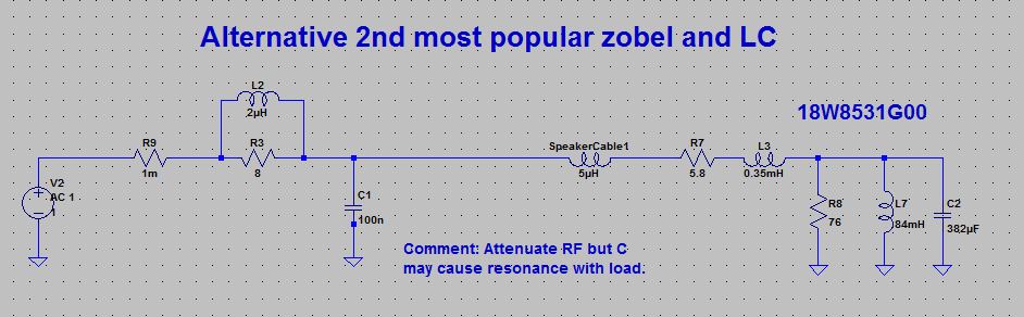

Next, This is the 2nd most popular implementation. Here the LR comes first then C to ground. According to Edmond Stuart, the C here prevents from RF ingress. It shunts RF to ground before it gets to the negative feedback of the amplifier and it does so much better than the standard implementation which does almost nothing beyond 2MHz.

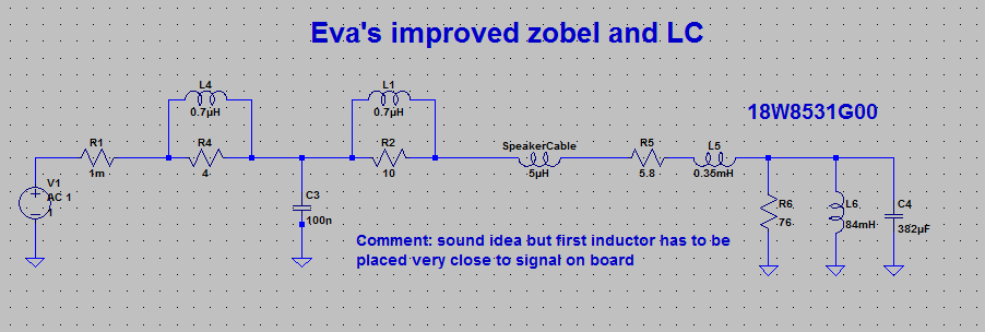

However, Eva indicated that the C could potentially cause LCR resonance because the C could interact with the speaker wire LCR and the speaker load. So Eva came up with a T circuit which does what the other circuits do while preventing from potential resonance with speaker wires and load (See post 304).
Now, I am thinking that Eva’s circuit is very fine, except it has missed one point. The first RC must be placed very close to the amplifier’s output and the local decoupling ground and the speaker return ground, i.e. low inductance, probably on the output board, in order for the RC Zobel to be effective. So in Eva’s circuit the first L must be placed very close as well. The air core inductor can inject noise to the high impedance of the output transistor base or MOSFET gate, and the inductor can pick up noise from power supply noise. We really want to place the L close to the output speaker terminal, instead of the output board.

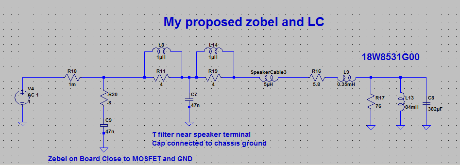

So I am proposing this circuit: a standard zobel right on the output board and a T circuit as Eva prescribed at the speaker terminal. The C of the T circuit can be connected directly on the nearest point on the chassis.
What do you think?
I am unable to model the correct values due to lack of skills and knowledge. If this circuit works, can somebody please help modelling it correctly and suggest the values of the components that should fit most amps?

C7 connected to speaker return terminal, not to Chassis.
If you want you can add an RF attenuating capacitor from Chassis to EVERY entry to the chassis. These are ADDITIONAL to the amplifier components.
I would use the 1nF suggested by H.Ott connected from Speaker Out to Chassis and another from Speaker Return to Chassis and another from Input RCA barrel to Chassis and another from RCA signal to Chassis. The IEC filter on the mains cable already has attenuation capacitance to Chassis.
The circuits with the R||L, that you are showing, are not an amplifier output Zobel. They are the Thiele Network (posts362&363), or modified versions of the Thiele Network (posts364&365).
The amplifier Output Zobel is the R+C from amp out to Main Audio Ground/Power Ground.

All agreed! 🙂
I am hoping somebody can help to actually model the circuit to come up with LCR values that will work with common EF output and typical loudspeaker load.
Attached please find the basic circuit.
I think that my proposed network should work. Let us say we come up with a set of LCR values for the components in the network which are the minimal values for unconditional stability. Starting from those values, increaseing the values should not upset stability, but only incur LOSS. I think the proposed network provides as much stability as others provide, except that it has higher loss. If the loss does not affect frequency response within audioband, we should be able to accept the loss. Correct me if I am wrong.
I have just modelled the proposed output network in SpeakerWorkshop. I assumed the amplifier output is a perfect voltage source.
When I used two ScanSpeak 8531 6.5 inch drivers in parallel as the load, there was about 0.2dB loss at 20kHz, and about 0.1dB LOSS at 5kHz.
When I used the Dynaudio Esotar T330D tweeter as the load, there was about 0.1dB loss at 20kHz, and basically no loss at 5kHz.
If I reduced the 1uH to 0.7uH for each inductor like Eva did, the loss was reduced but still there.
I think I prefer slightly higher inductor value for better RF attenuation and perhaps better stability. I think I can accept 0.1dB loss at 20kHz.
Can somebody please model it with LTSpice to look at it from the view point of the amplifier?
