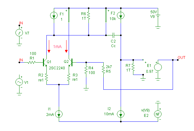

Hi John,
I like to add the results of a quick sim of the most common power amp topology, comprising a LPT, followed by a current mirror, VAS+compensation cap and an EF output stage. My purpose was to see if there is a relation between slew rate and harmonic distortion in real amplifiers (do you listen Brian?). So I manipulated some component values to get a SR of 8.8, 19.3 and 41.1V/us respectively.
Since the SR (in this case) is determined by the tail current and the value of the compensation cap, I've simulated this amp with three different caps: 220pF, 100pF and 47pF, and keeping the tail current constant. To get a fair comparison, I've also kept all other parameters at the same value, including the unity gain frequency of NFB loop, i.e. at 1MHz (practical values lie invariably between 0.5 and 2MHz, so 1MHz is quite reasonable, I think). Therefore I had to adjust the OL gain by trimming the emitter resistors of the LTP, in order to keep Fu of the NFB loop at 1MHz.
THD is simulated at 20kHz and 1Vpk input. Here are the results:
Cc (pF) ..... RE (Ohm) ..... SR (V/us) .... THD (ppm)
220 ........... 0 ................. 8.8 ............ 303
100p ........ 29 ................ 19.3 ........... 25.7
47p .......... 91 ................ 41.1 ........... 2.6
Edmond.

Edmond Stuart said:
To get a fair comparison, I've also kept all other parameters at the same value, including the unity gain frequency of NFB loop, i.e. at 1MHz..........Therefore I had to adjust the OL gain by trimming the emitter resistors of the LTP, in order to keep Fu of the NFB loop at 1MHz.
Illuminating.
doubling Cdom (Cc), increases distortion by a factor of 10!
But, is it a Cdom loading effect or a slew effect or an LTP linearity effect or something else?
