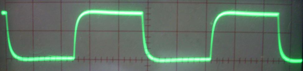

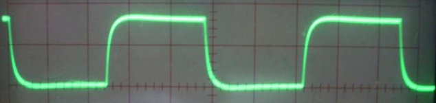

I decided to make some measurements of my amp driving a real spkr load. Here are the results, warts and all, so feel free to comment either way.
Source - B&K function generator - rise time & fall time <90nS
Amplifier input RC filter: 220 Ohms and 1nF to ground
Output inductor: 13t of 2mm copper wire on 25mm former in parallel with 2.2 Ohms
Zobel: 10Ohms in series with 0.1uF 600V direct from amp output to ground (before Inductor)
Output amp rise time is c. 1.2uS
Loadspeaker used is B&W 703
This is the amp output via 3m spkr cable into 8 Ohm dummy load

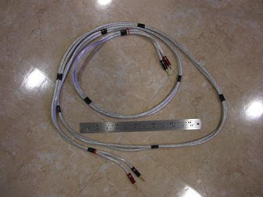

Any chance of the response with 3m speaker cable driving a speaker and no capacitor?
PS: 5nH/cm will be a significant underestimate because it doesn't take the area enclosed by the two conductors into account. If you describe the cable, someone better informed than I might be able to estimate the inductance for you.

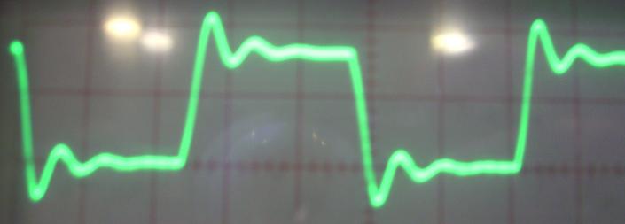

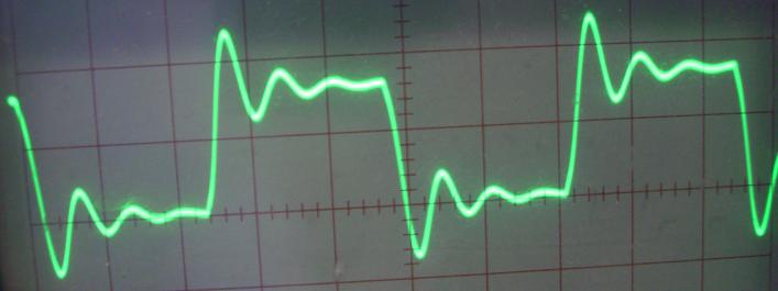

Bonsai said:
Next picture is with 0.1uF across the speaker terminals. Spkr driven in all cases via 3m skr cable. note the slight kinks at the waqveform edges.
Hi Bonsai,
First, interesting work!
Next, can you tell us what the impedance is of that particular speaker at say 100kHz and 1MHz? If it deviates from the rated impedance, you might repeat the measurements with a more correct load by means of a RC Zobel right at the speaker connections.
Edmond.
edit: or just use a pure resistive dummy.
Sorry, guys, I will be away on business for the next week - maybe next week end I can try some more experiments.
BTW (you'll love this) I shorted out my output coil with a 100mm crocodile clip, and the waverform at the speaker cable showed no observable difference on the scope. I can only assume the spkr and cable inductance swamped the output coil inductance.
Next experiment I want to try is a 1uF right across the spkr terminals. My bet is without inductor the amp oscillates and with the inductor it does not.
